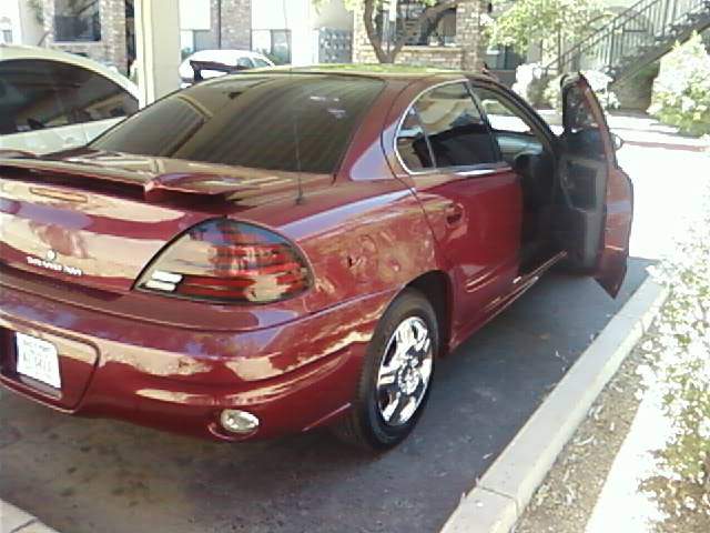

But i wanted to ask i have 05 Pontiac Grand AM 3400 SFI V6 ive seen other GT's and it doesnt look quite like mine due to the badges and all, I was wondering if is mine was a GT as well because i have also have v6, and its pretty fast.
heres a pic

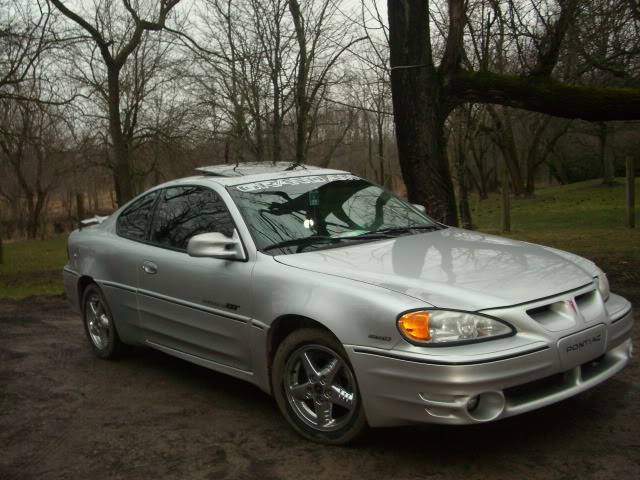

i em pretty sure it is just an se cause don't quote me but i know the gt has the hang down on the back bumper
does your car have a front bumper like this

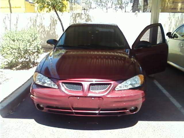

so yea i took that pic a couple days ago but almost not quite like it though looks like u got more grove or whatever on bumper other than that pretty close

yea you have an SE the GT has a dif front bumper, chrome rims and some other stuff.

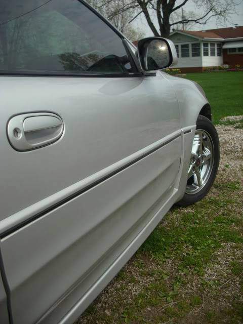

yes you deffinitally have an SE. The person that had the GA before you could have possibly dropped a v6 engine in and taking the slower engine out. A way i know that your car started out an SE is because it doesnt have the black triming around the car i will show you a picture of mine and explain.
another way to tell is the bumpers. if you look yours has more close together bumps then the GT
hope this helped =]

And yes, you have an SE sedan. And teh ooogleh mickey mouse mirrors. Get some dual post mirrors.
It's very common for SE's to have LA1's. The major difference between a GT and SE LA1 equipped GA:
GT's had the ram air box, which is nothing more than a gimmick really. A CAI does the job much better.
GT's have a different trans:
4T45E versus the SE's 4T40E, with less agressive gear ratios.
GT's have bigger exhaust pipping:
2.25" versus the SE's 2"
And the with the different ECM programming, your SE will top out at 108MPH, since yours came equipped with the 15" wheels.
