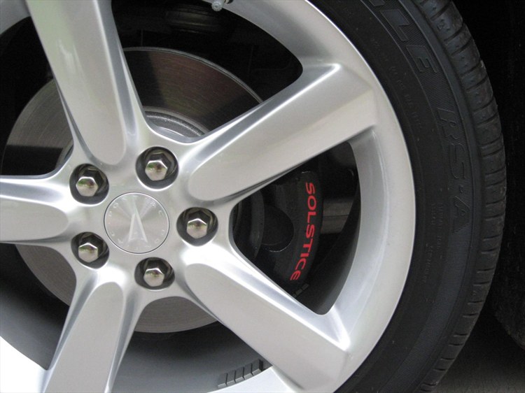

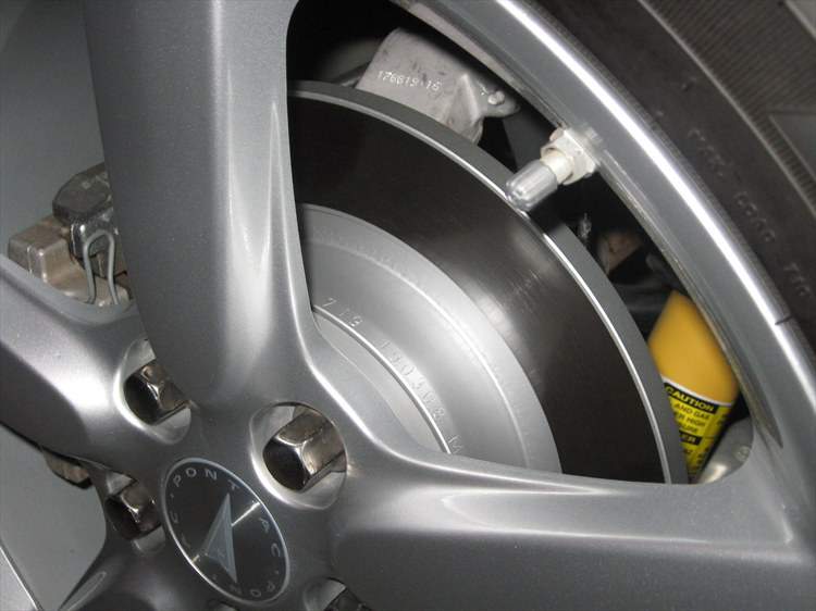

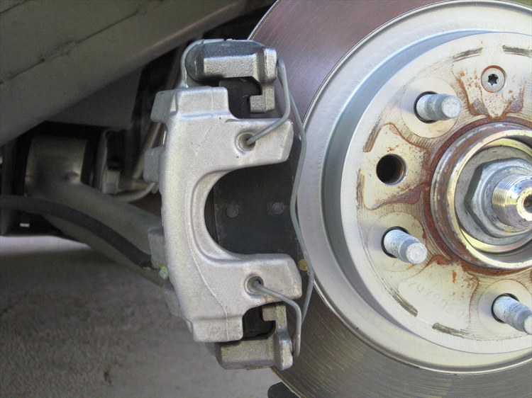

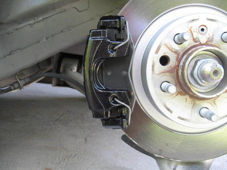

My next two modifications deal with cleaing up the appearance of the Wheel area. Specifically the Rotors and the Calipers. Didn't want to change out anything yet so just decided to paint. I wanted to keep the look of the modification simple and something that you might see come from the factory. So I stuck with Silver and Black.
Front and Back
Rotors
Before and After
Calipers
with Caliper Decal

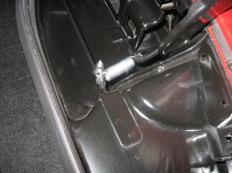

My first mechanical mod was just a mod of convenience. The trunk on the Solstice can only be opened by either the button in the Glove Box or on the Key fob remote. Since I don't have power locks I didn't get a remote fob so the only way I open it is in the glove box. The main thing was that when you "pop the trunk" the lid didn't come up as far as I wanted it to. I figured that it should open all the way and I discovered that someone else had thought the same and came up with a simple solution of adding a certain spring to the hinges. So I added the spring and now instead of the lid popping up 4 inches, it raises all the way to the open position by itself
Video of Trunk Assist Spring

nice job on the calipers! is that just a sticker on the calipers?
Thanks!
Yup, just a vinyl decal. I thought heat might be a problem but it isn't.

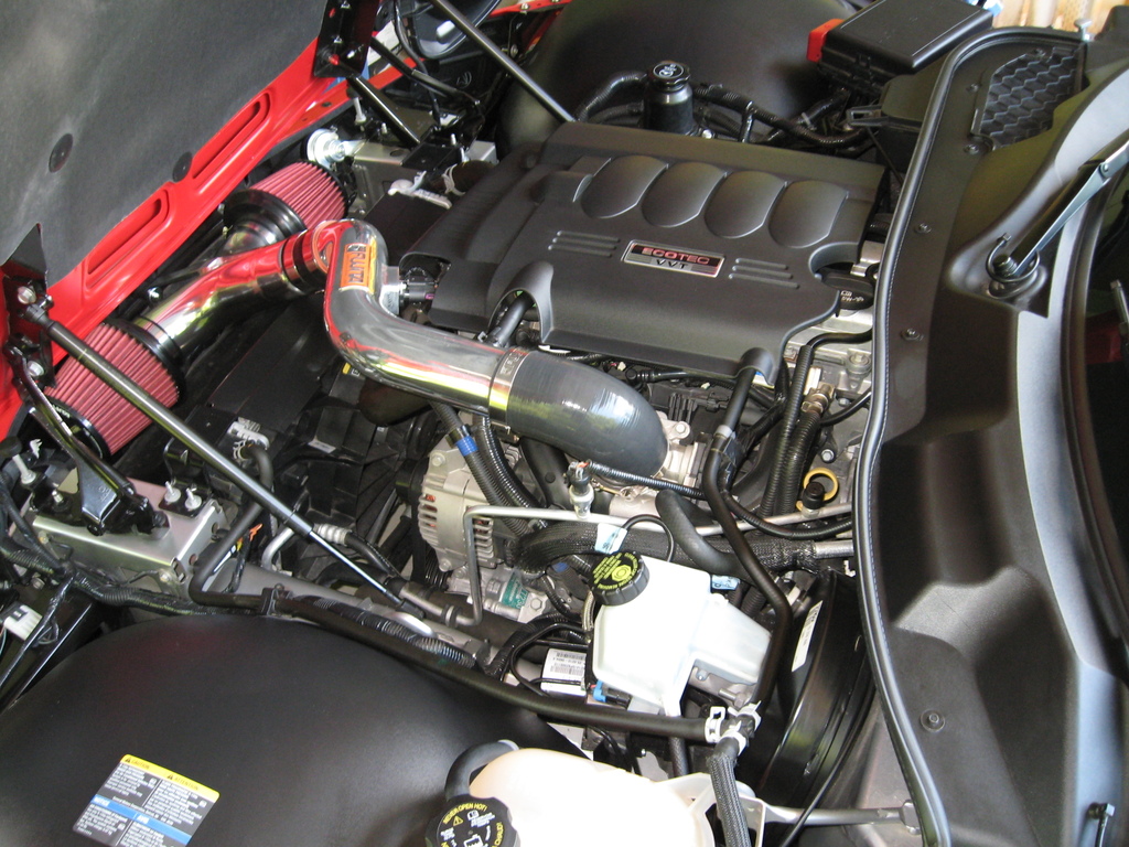

New Performance Modification
Added a Fujita Dual Filter Cold Air Intake
to replace the stock intake and K&N filter.
Video of the intake sound - "ROAR!"
Sounds great! It was you that has the GXP exhaust sitting in their garage right? Any move on that?
yah..its still sitting there. I have to get the supplies to polish it and then purchase the GXP rear valance. The money I used for the intake was originally going to be for the valance which is around $300.

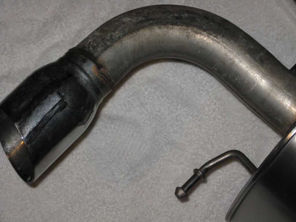

Last day of my vacation, decided to start polishing the GXP exhaust I have.
Went earlier today and bought wet/dry sandpaper ranging from 180 to 2000 grit.
Here is the side I just cleaned but didn't polish at all
this is the other side after 180, 400, 600, 800, 1000, 1500 and 2000 grit paper along with some Mother's Power Metal polish

The muffler section only really needed the metal polish to come out to a shine, but I could get it looking chrome if I used some paper on it....which I might do.
Wow, that exhaust came back to life.
