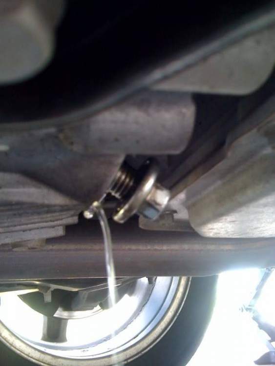

It's confirmed I did have water in the oil about 2 1/2 quarts....I drained all the oil and refilled... I took out ALL the spark plugs but I need to get a hold of battery charger to attempt to crank over... as of now it only clicks... I hope it isn't siezed!!! The wierd message warning still appears in the DIC... "charger parked" anyone know what this means???

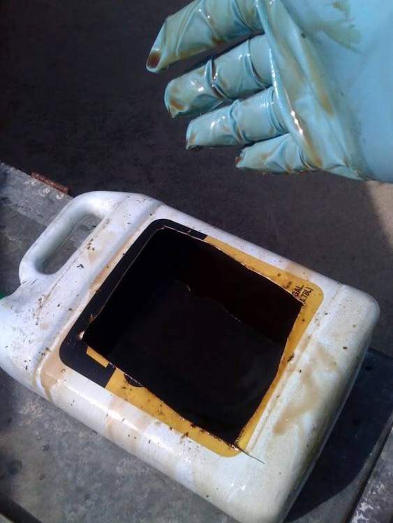

NOT WHAT YOU WANNA SEE WHEN YOU DO AN OIL CHANGE!!!

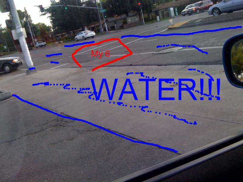

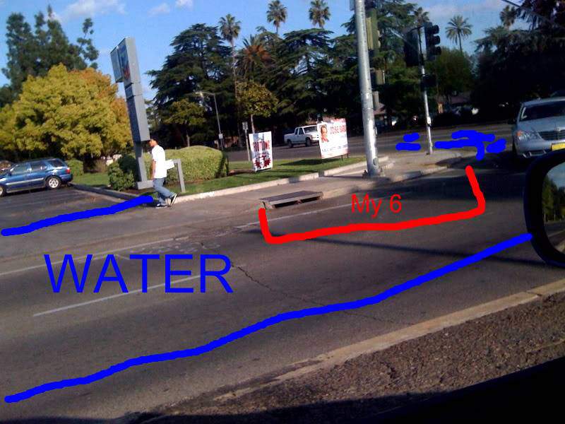

This is where it all happened.... I was to bumbed out to take pics the day of, so these are to give you an idea...
Tell the Gov-A-Nator to fix yo streets Foo!

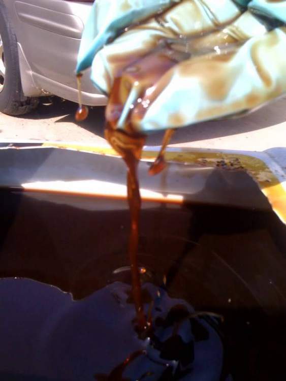

possible update... i just talked to him and he says that the oil is "milky"
That is a bad word because that is used to describe oil when it is mixing with coolent. mixing with coolent can mean that you have a blown headgasket.
When you drain it does it look like this???? THAT IS BAD!!!

Ryan for some reason the oil on the dipstick looked THAT color but I drained the oil and here's what it looked like.... NOT milky whatsoever... temp maintains @ operating level...
