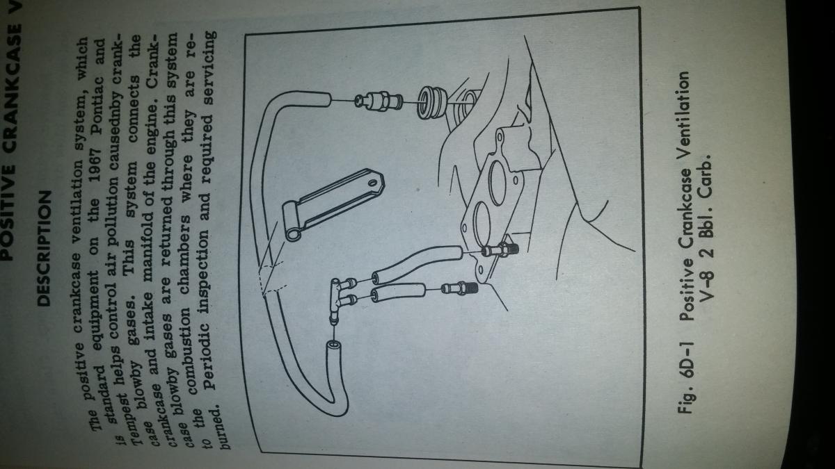

PCV is only a couple bucks and sounds like a new length of hose to a vacume port as well.
Like this right ?

I'll second what justa said.The unburned gas fumes etc will ruin a motor in no time.Changing oil is cheap as well,once its hooked back up though after a few miles alot of the crap will naturally get burned out of the oil.(get a new mechanic as well)
Follow your diagrahm.  You should have a plugged off vacume port somewhere already.  Measure your new length of hose to that.  Unless you have recently changed your oil, I agree with Indy... that would be cheap insurance.  Hope that relieves some of the pressure off those seals.
