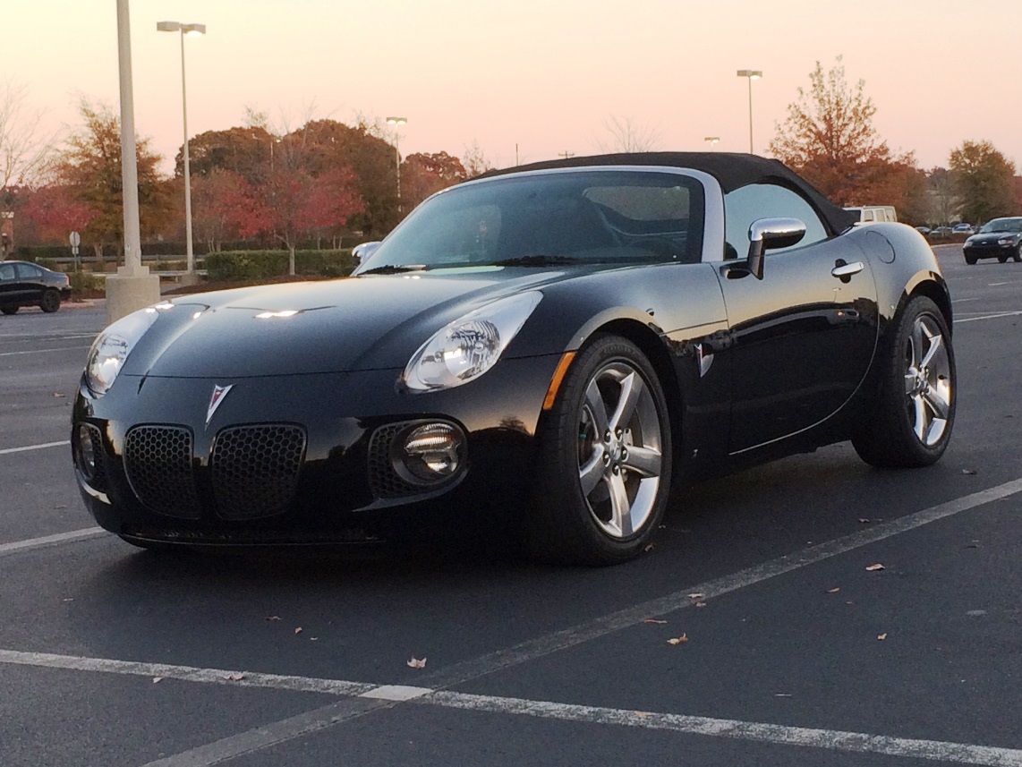

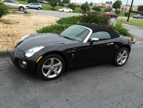

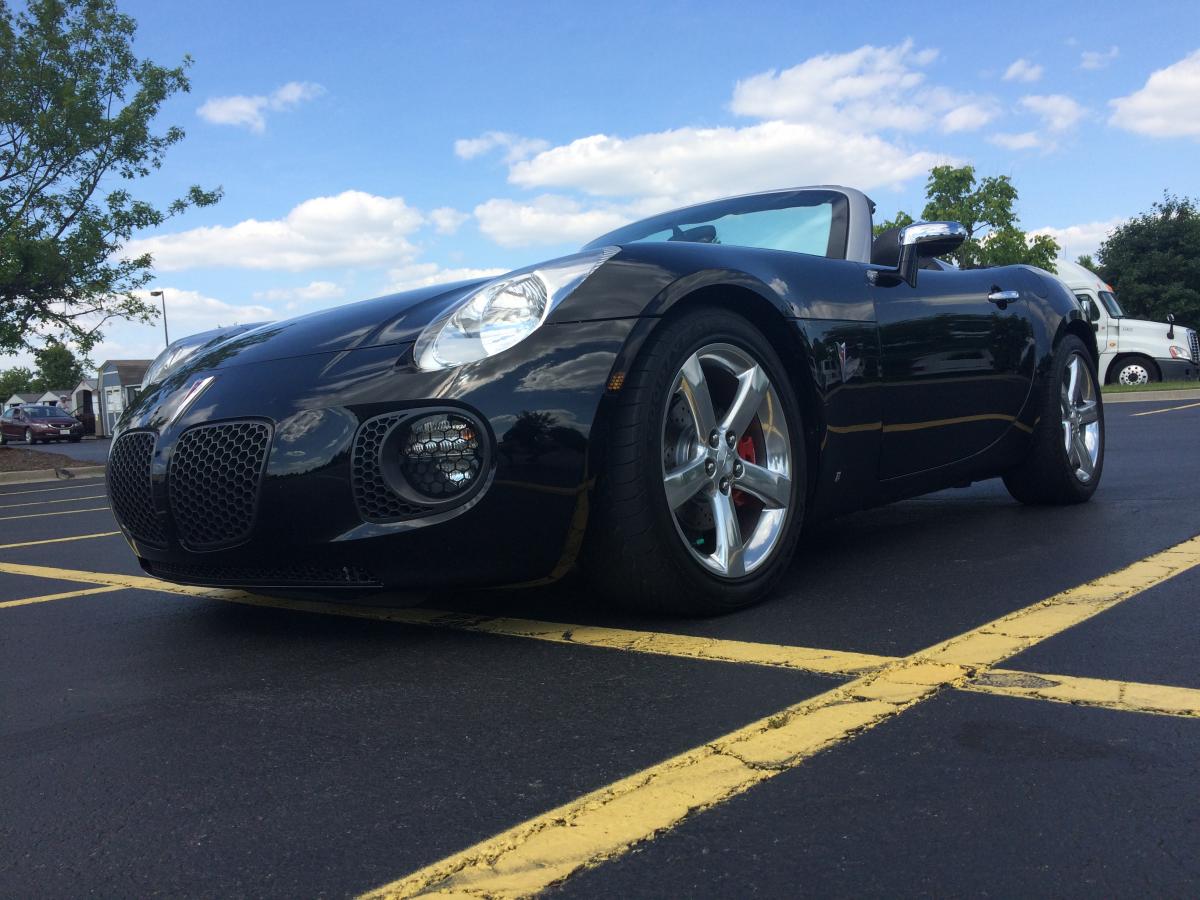

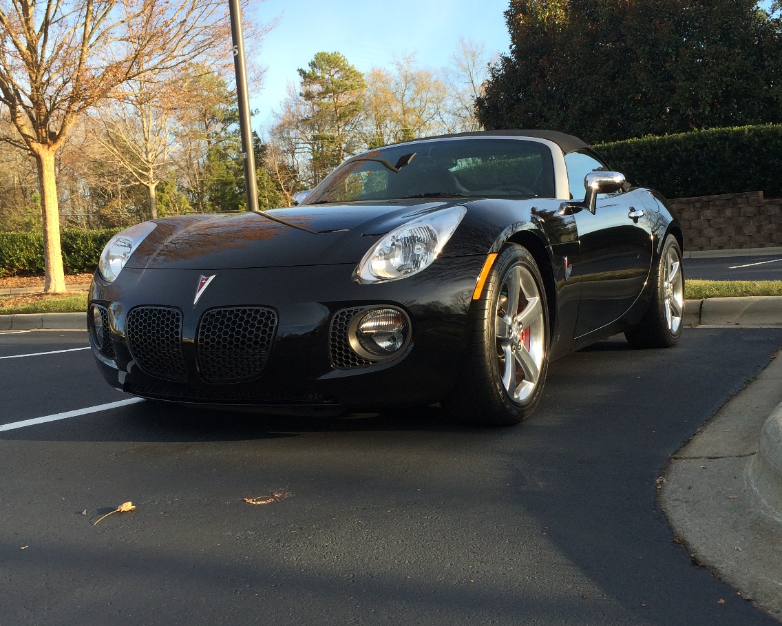

Pictures of the day I brought her home. Love that 4x4 wheel well look.

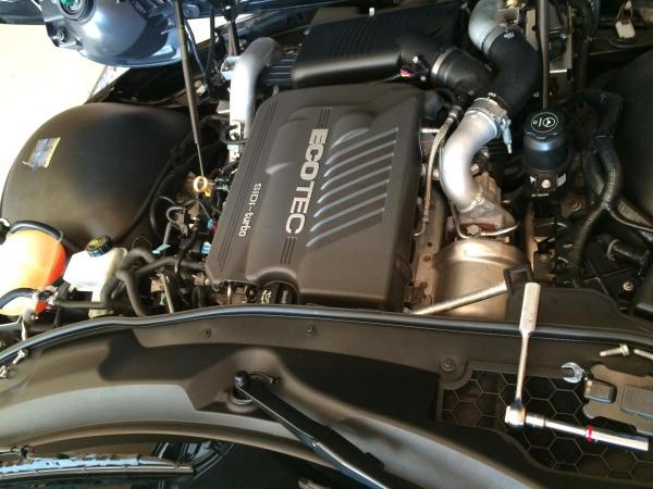

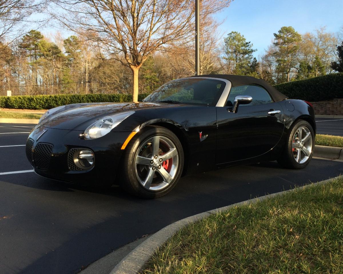

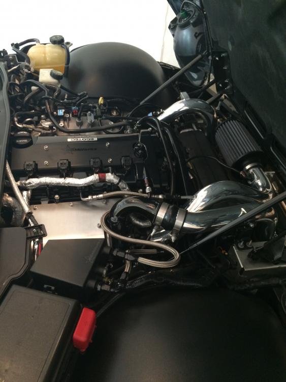

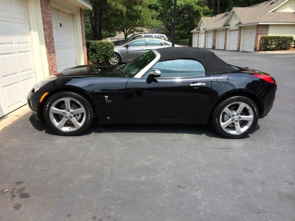

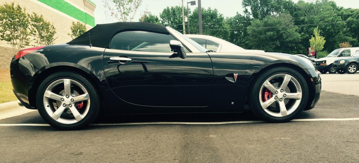

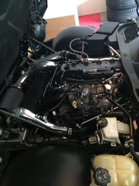

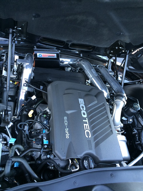

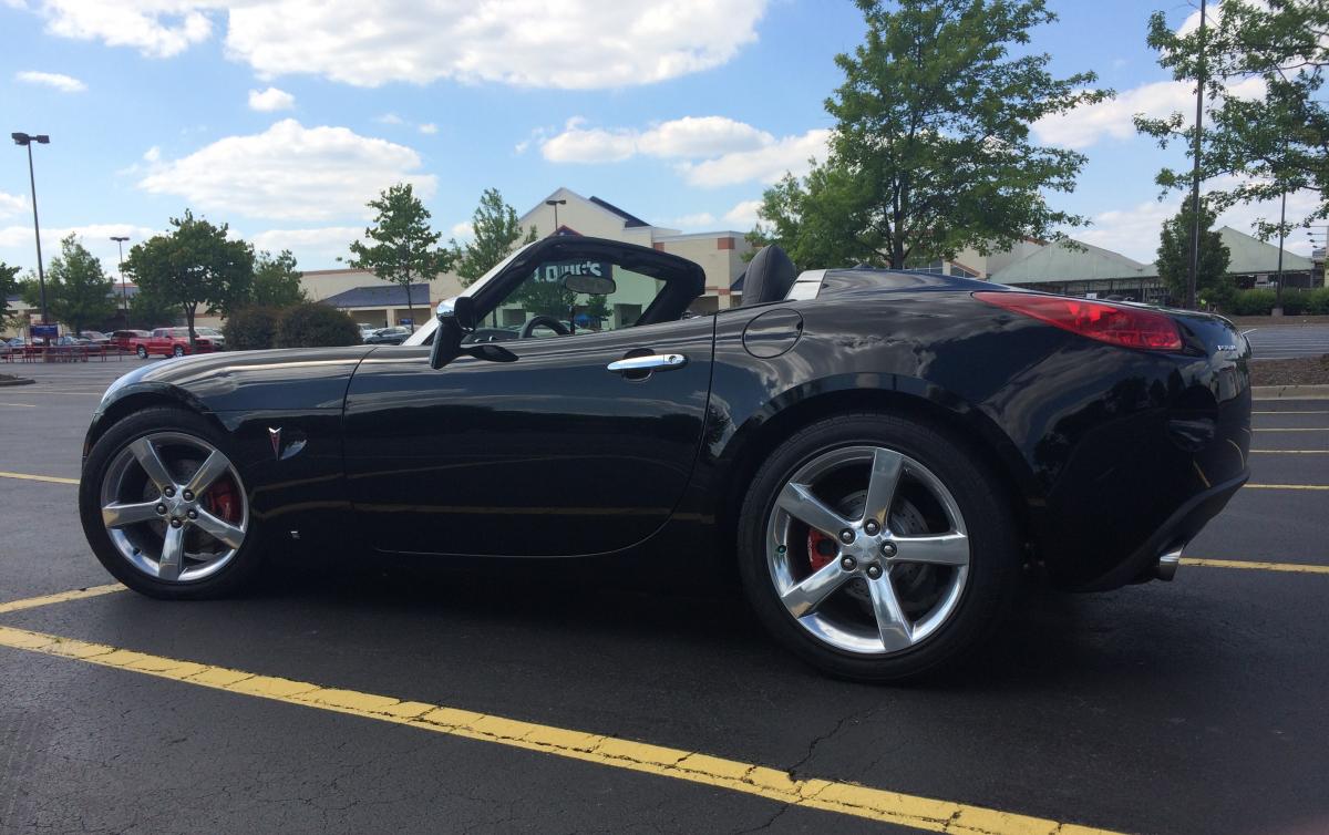

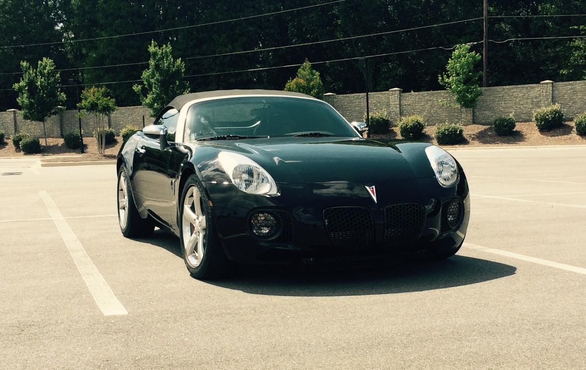

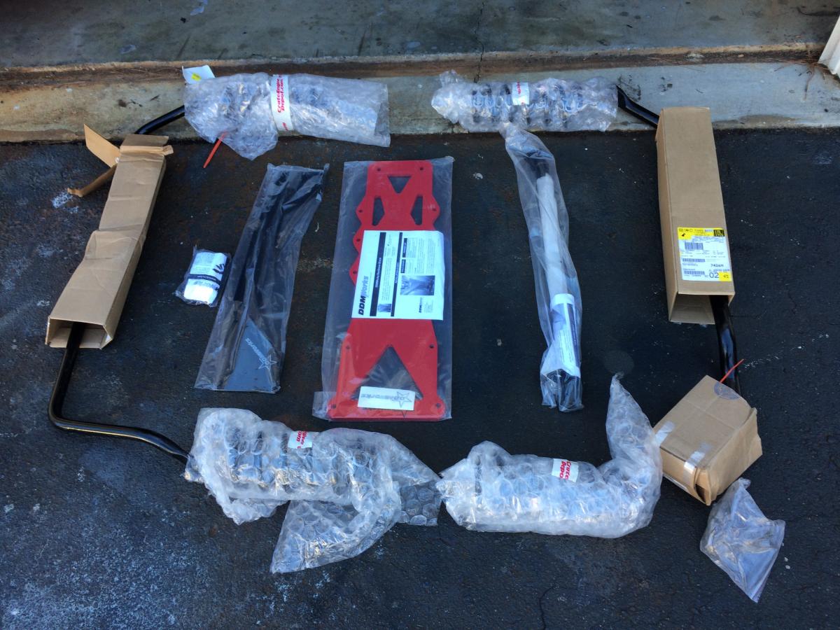

First I started on the engine with the GM Performance Tune and CAI. Added the DDMWorks Charge pipes, then the suspension - Z0K springs and sways, DDMWorks Backbone and Pro-Beam. Now she sits just about right:

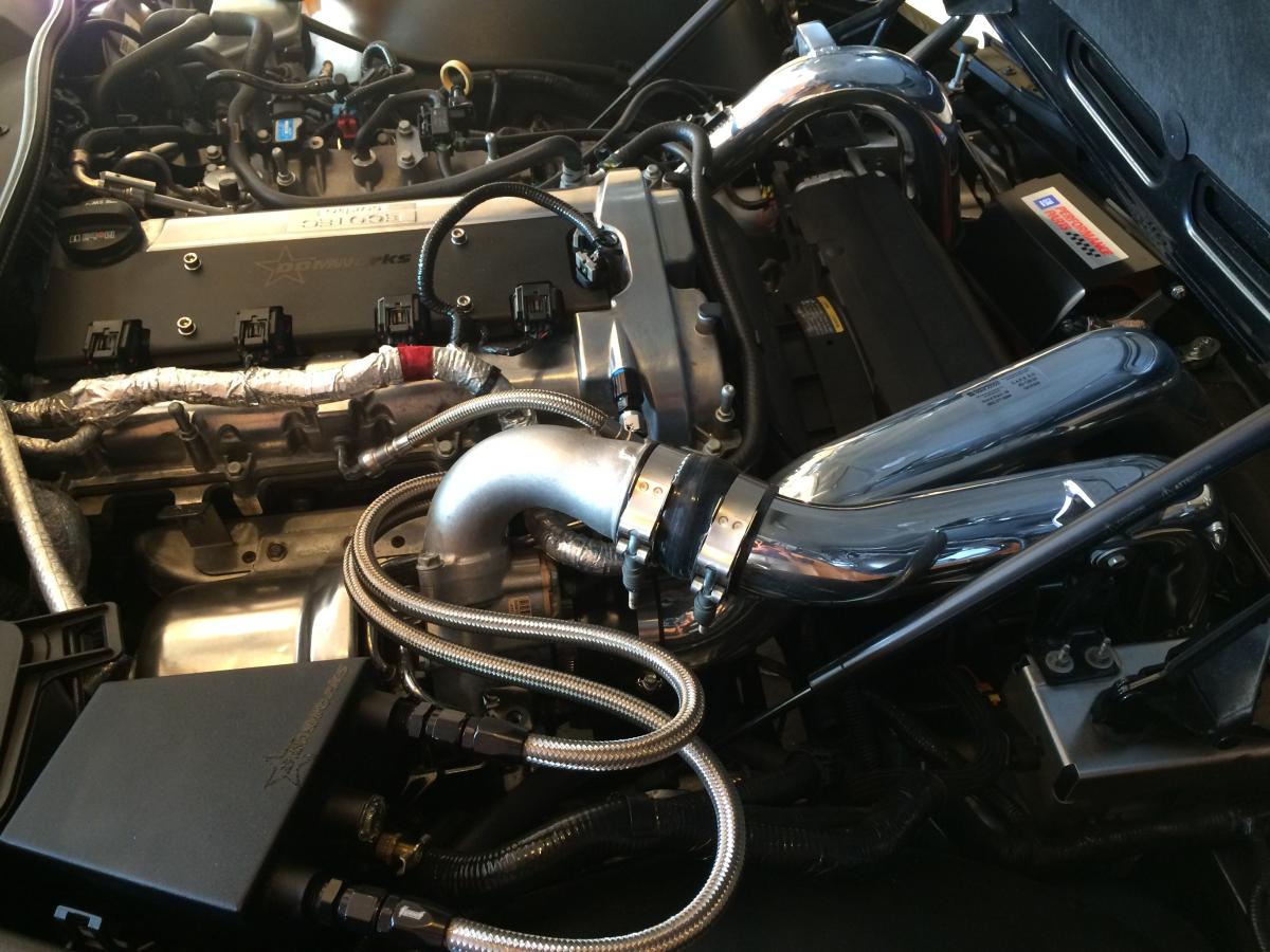

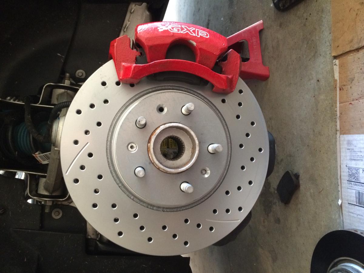

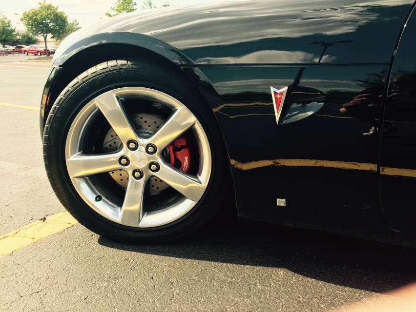

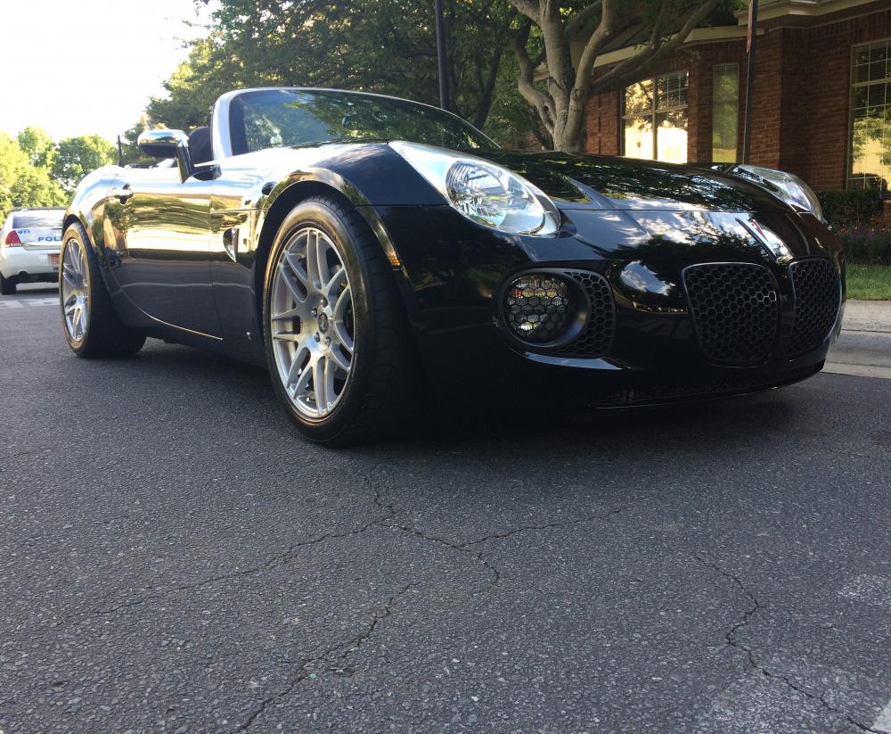

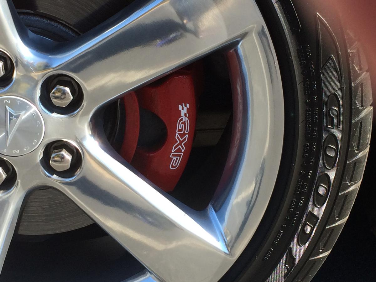

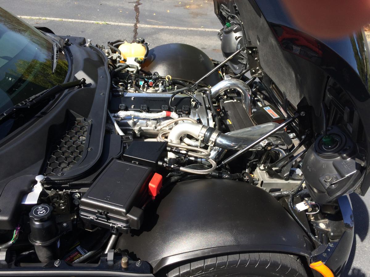

More engine work with the DDMWorks coil cover, Intercooler, Oil Catch Can and Power Steering relocation kit. Decided to do the calipers in red with GXP decals I picked up from fleabay:
post-2428-0-40416300-1430315267_thumb.jp
post-2428-0-11763600-1430315325_thumb.jp
post-2428-0-62206500-1430315360_thumb.jp
Named her Nu Yao (Pronounced "New Yao": means Banshee in Chinese) because I had some air leaks around one of the charge pipes - made a howling sound when I got on it. That's fixed now, but the name stuck.

Ordered the DDMWorks Stage 1 Brake kit and Tune. Hope to get that by end of the week. I went with cross drilled/slotted rotors instead of the j-hook versions. I think I will regret that later. Waiting on Aftershock to send my rear spoiler - its being painted now. I will snag the AEM Stage 2 Meth kit mid May and have that installed by Dr. Dave from DDMWorks along with a dyno tune by end of May. I have a business trip to China coming up - not convenient when you want to mod your car. But then it helped me slow down on spending my money - for a little while at least!

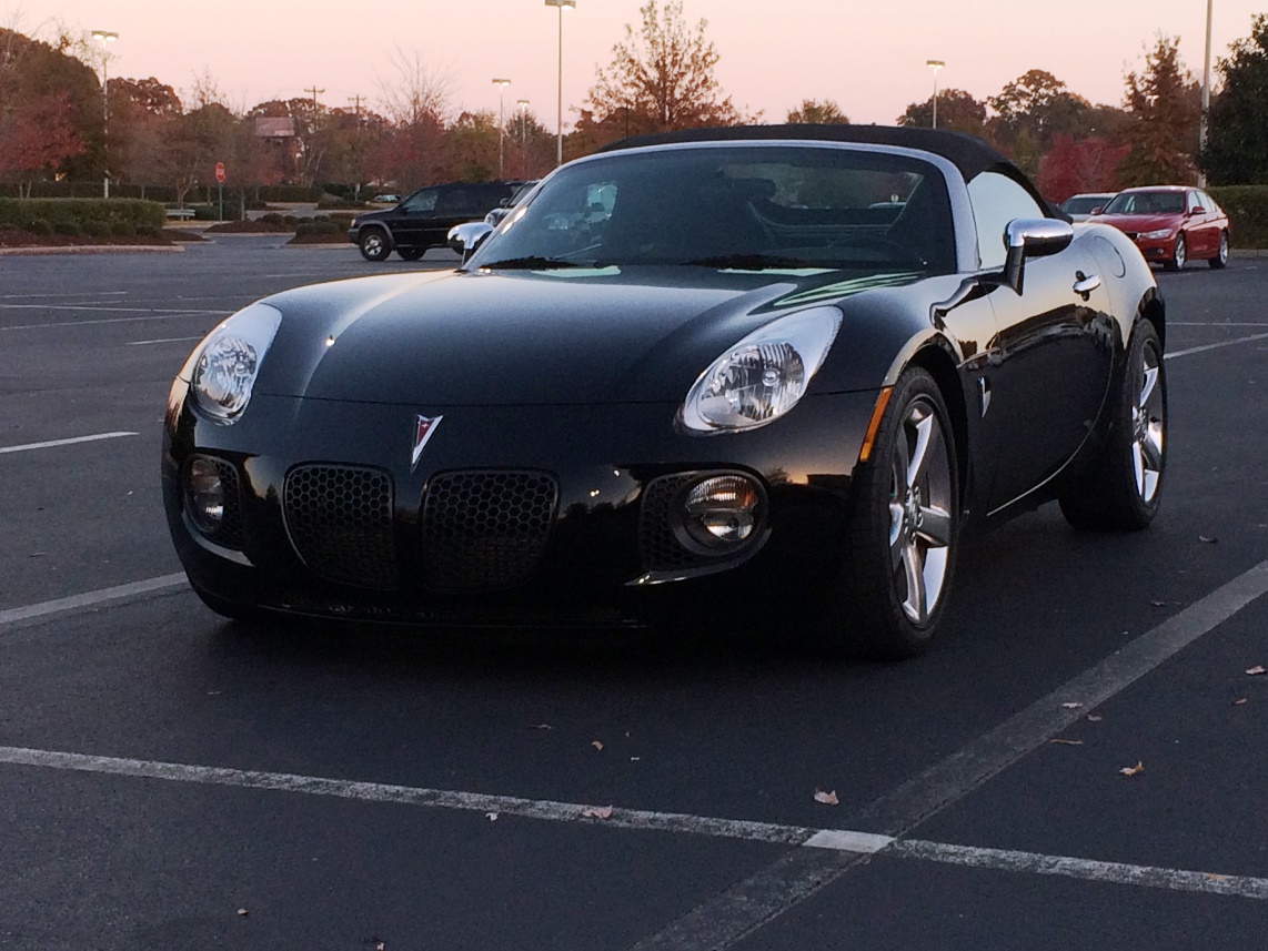

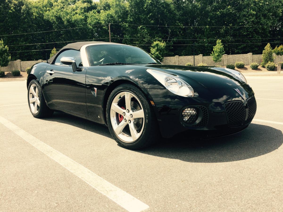

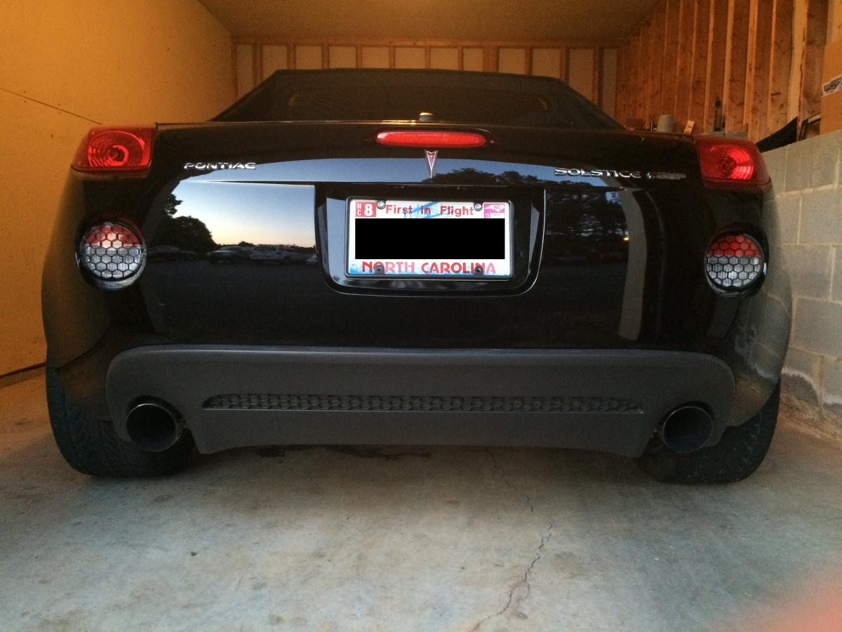

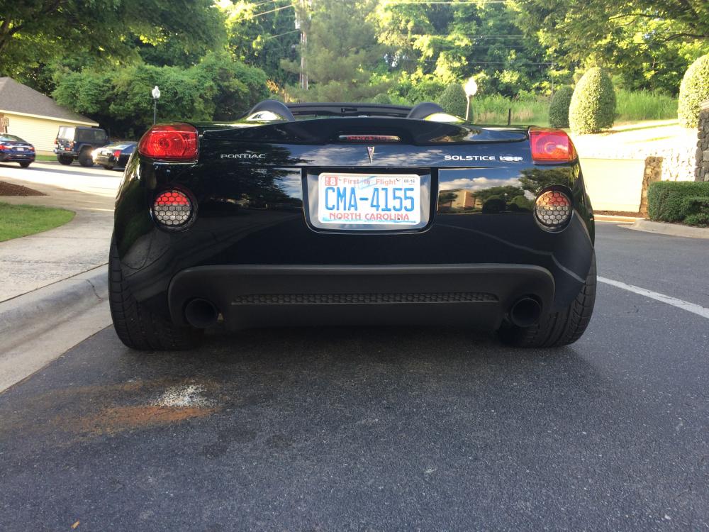

A pic of the car with the ASAP Graphics backup light covers installed - nice fat stance.

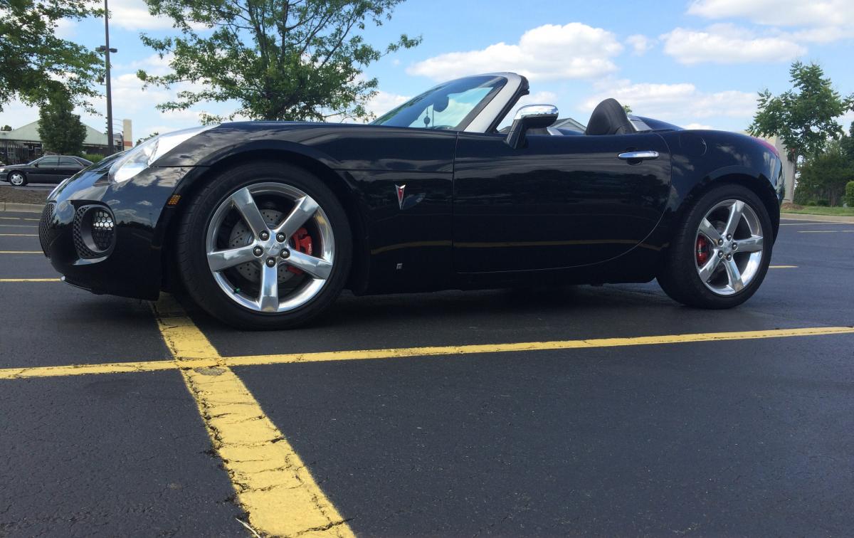

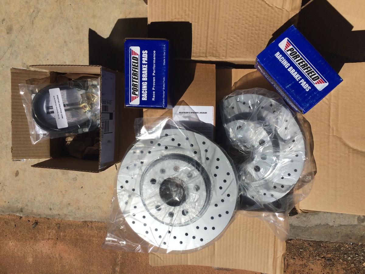

Added a few new things to Banshee:
DDM Slotted/Cross drilled rotors
DDM Stainless brake lines
Porterfield R4S Brake Pads
ASAP Graphics Fog and Sidemarker Light Covers
