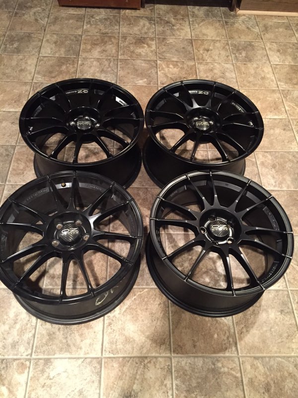

Looking at these for the Sol - O.Z. UltraLeggra staggered set - 18x8/18x9.  On the fence about black on black, but these will add a nice stance to the rear and are the right off-set for the car.
Getting close to the Meth install starting this Thursday - cannot wait for that. Dr. Dave said I would get about 330 whp out of the Meth install/Tune he is doing. Nice.   :)  I'll make sure I get some decent pics of the install.
Should be nice, can't wait to hear more
nice looking rims. how light are they?
Supposedly 18.6 and 19.2 respectively
How much of a difference over stock?
Stock runs ~26lbs. So a decent ~9lb difference in weight. On another note, I like these too and they are bit less in price. Also in the color for my car.

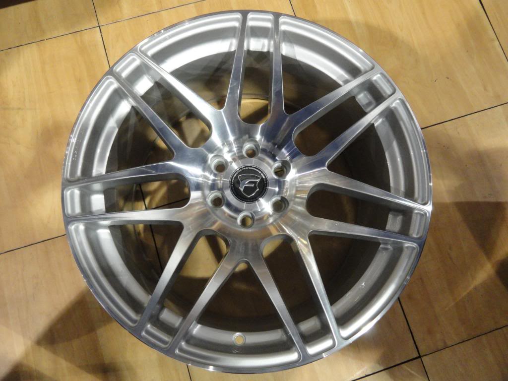

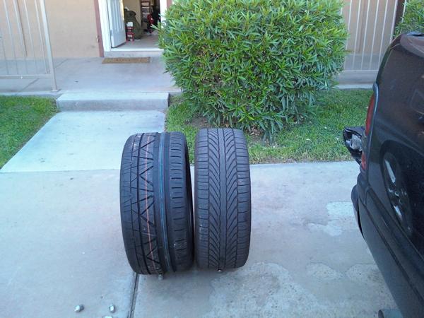

Forgestar F14 - 18x8.5 F / 18x9.5 R. That would allow stock tire size 245/45R18 front and 275/40R18 rear. These fall into the same weight as the OZs. So that's a plus.  :clapping:
Pics show the bigger 275/40R18s for the rear.

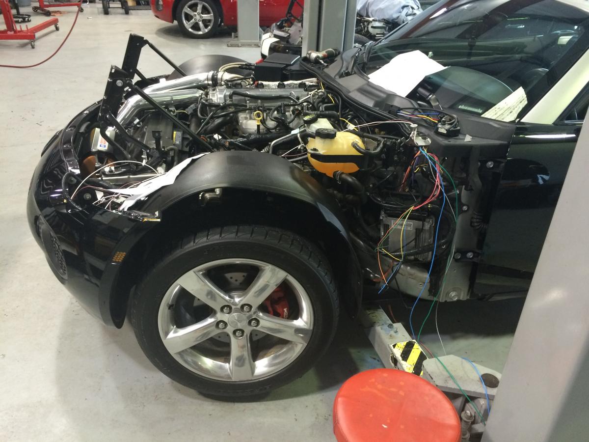

Finally get the meth kit installed and a new tune tomorrow. I'll get good pics and post. Cannot wait for this so I can move onto the turbo next.
Nice! Should be awesome!

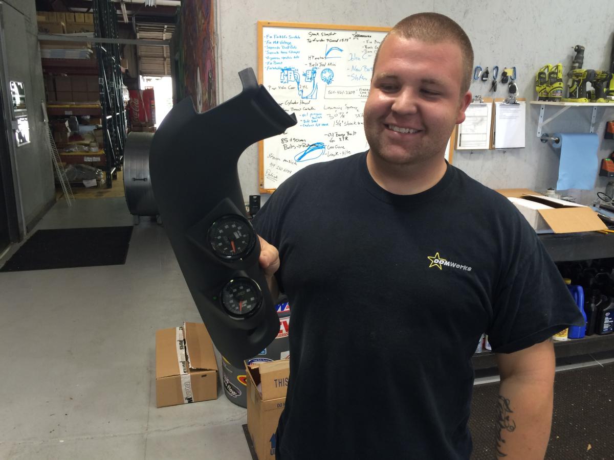

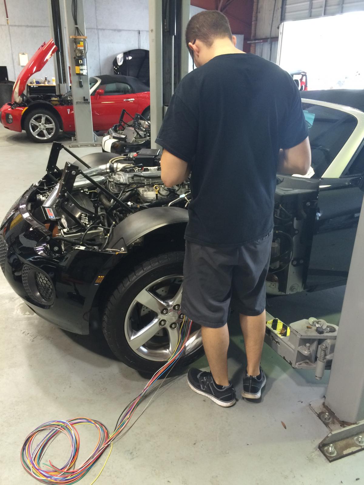

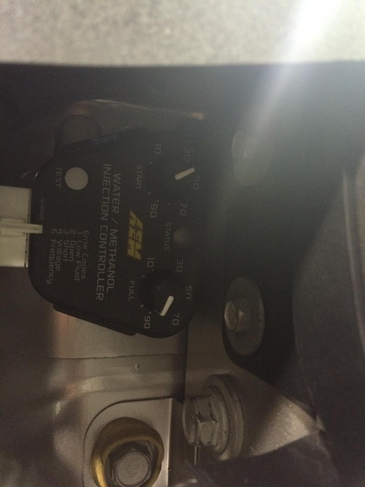

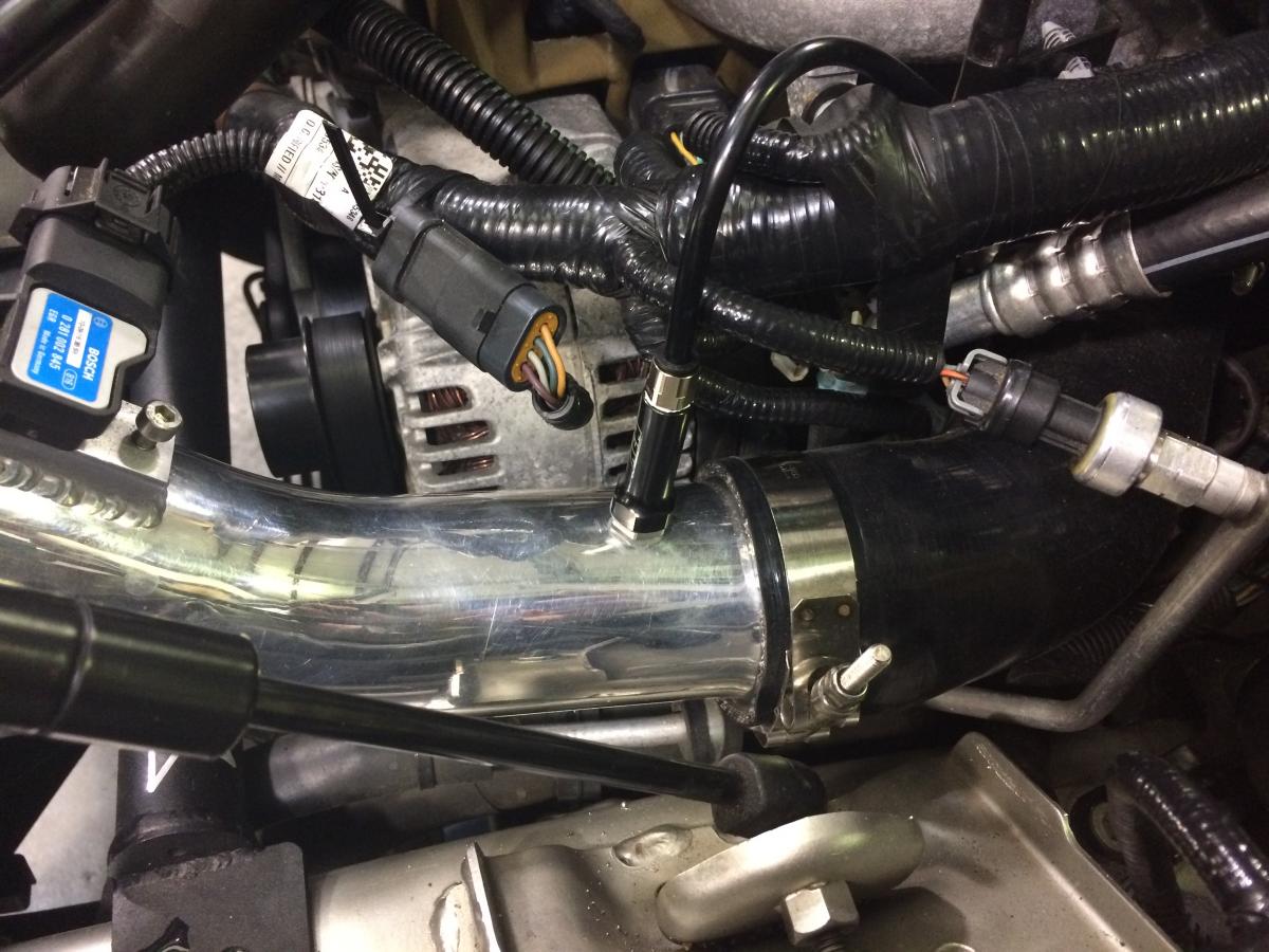

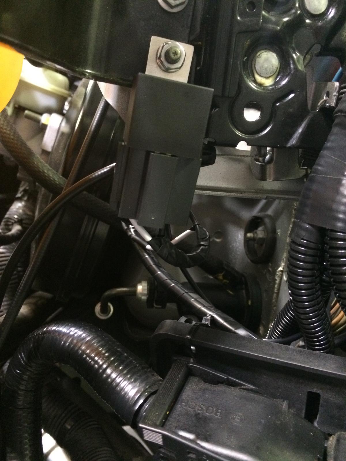

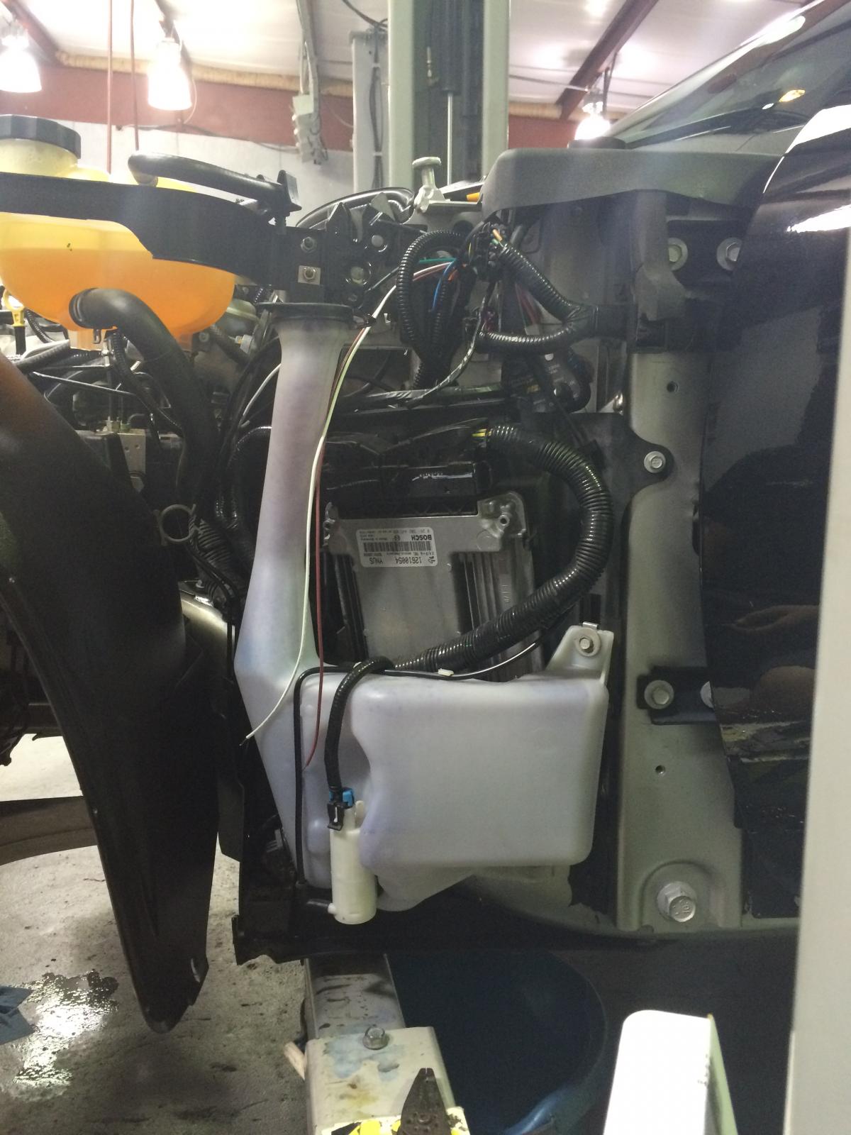

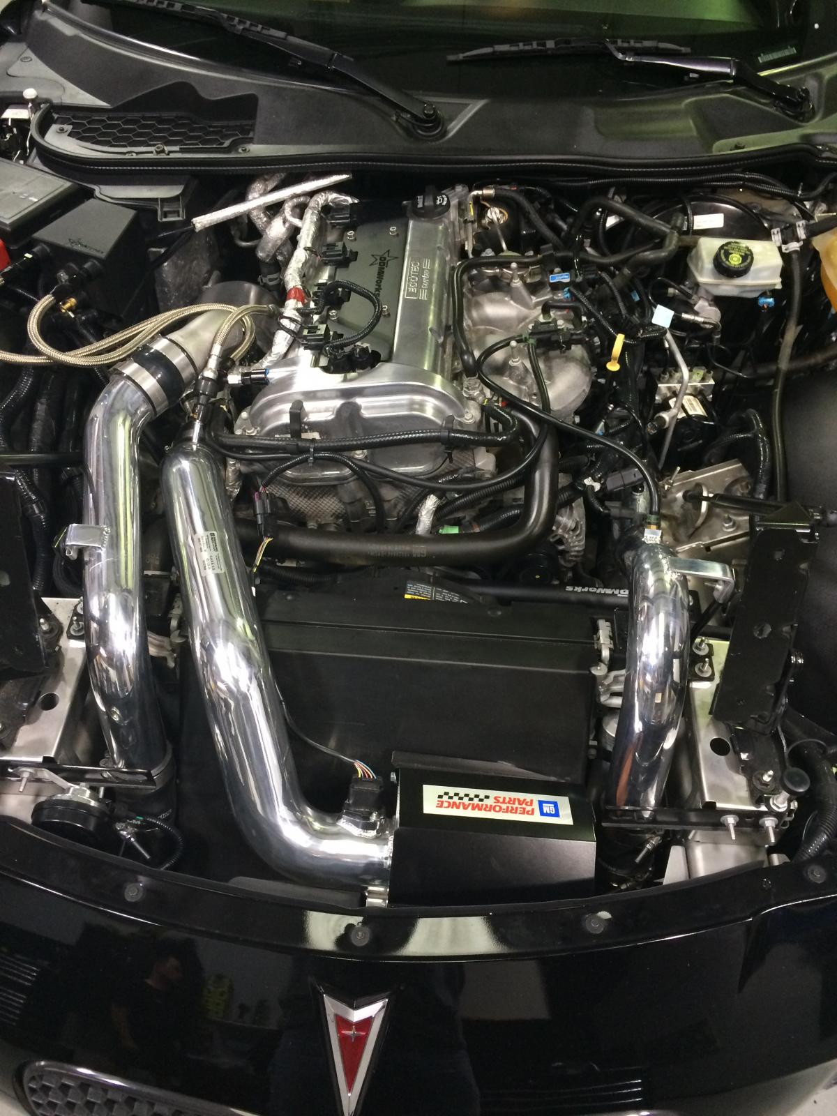

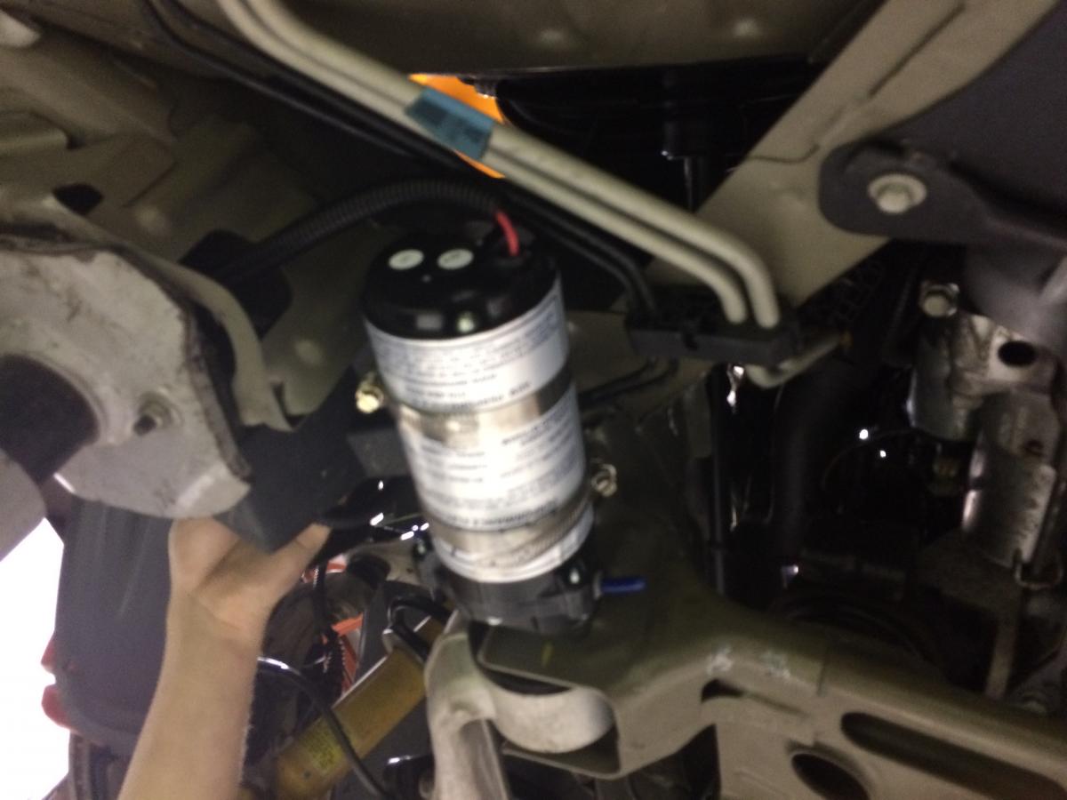

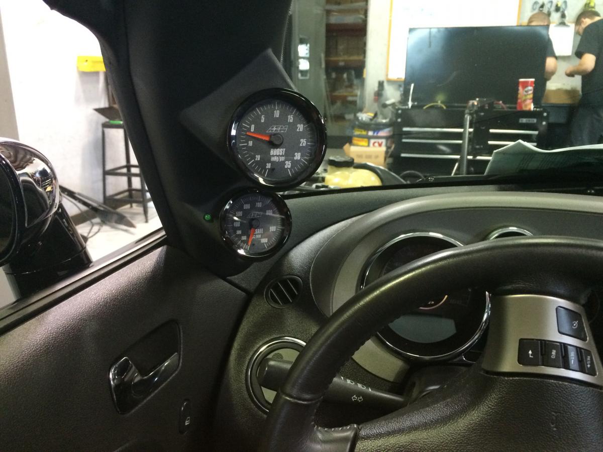

Finally got the meth kit installed and a tune done - all I can say is WOW!! I gained 5lbs boost (to 26psi) and 5 degrees timing. Car pulls like a banshee now. The tune smoothed out the engine too. This is one of the best things I have done so far for the car. DDM also installed an AEM boost gauge and failsafe gauge in the DDM a-pillar gauge pod.
DDM just released their EFR-6758 kit, so that is next along with a new clutch. Too much power for the stock clutch. Last will be the engine build and I should be set. After a talk with Dave, I think I will drop my expectation to 450-475 whp. More than that will require fueling changes I don't want to get into. So with Meth, the turbo and an engine bottom-end build, I can get to those numbers on 93 oct gas. That's fine by me.
