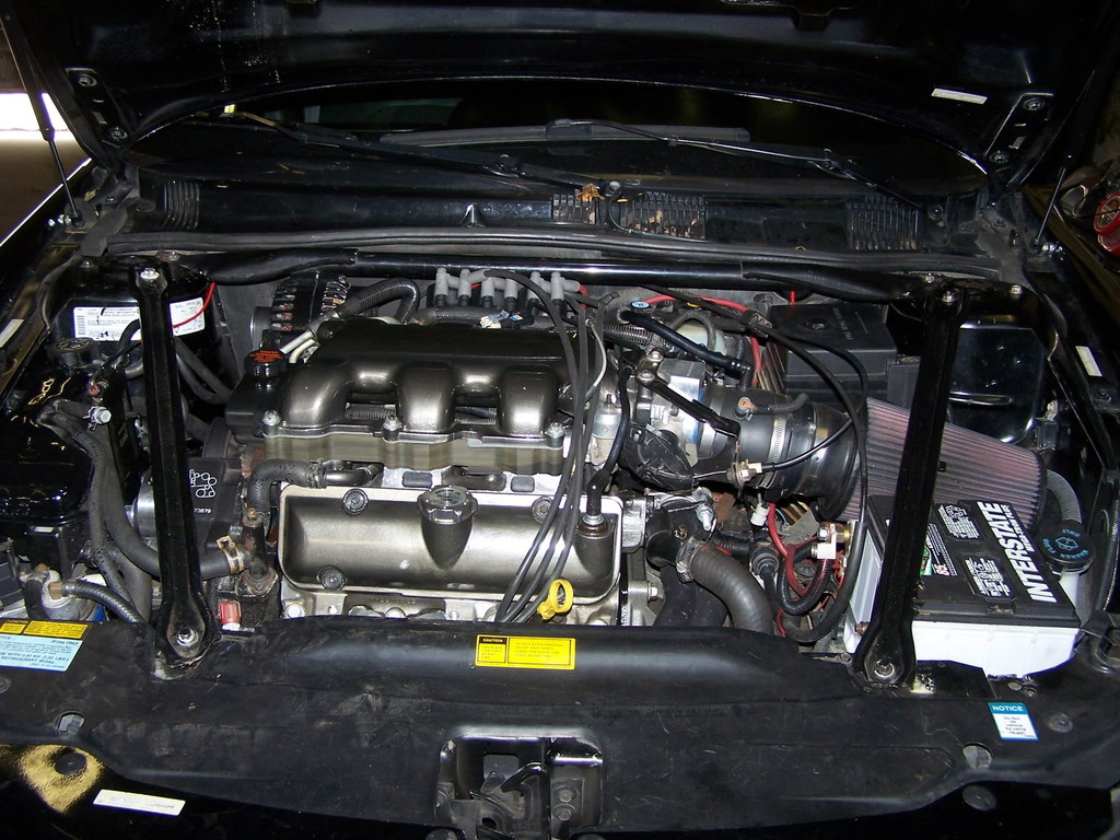

everything minus the engine has a little over 100k on it. the engine started out like as a stock replacement that had 300 miles on it when i got it in Jan of 07 now it has around 10k on it and is a completely different beast.
little background into whats done to the car.
3400 bottom end which is from the 300 mile 3400 i started with which now has about 10k on it
3500 ported lim from WOT-tech store
3500 heads from wot-tech store and are ported
went with the 99 timing chain, cam sprocket and crank gear.
ported and shaved 3400 upper

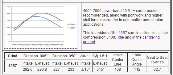

custom ground cam with custom pushrods
cam specs--intake 230 exhaust 236 515 int 515 exh lift pic below
65mm t-body upper ported to 65mm
modded 3400 lifters with LT1 springs inside
Comp Cams 26986 Valve Springs
comp cams locks and keeps
TOG headers with high flow cat
SLP cat back with an OEM camaro muffler for now

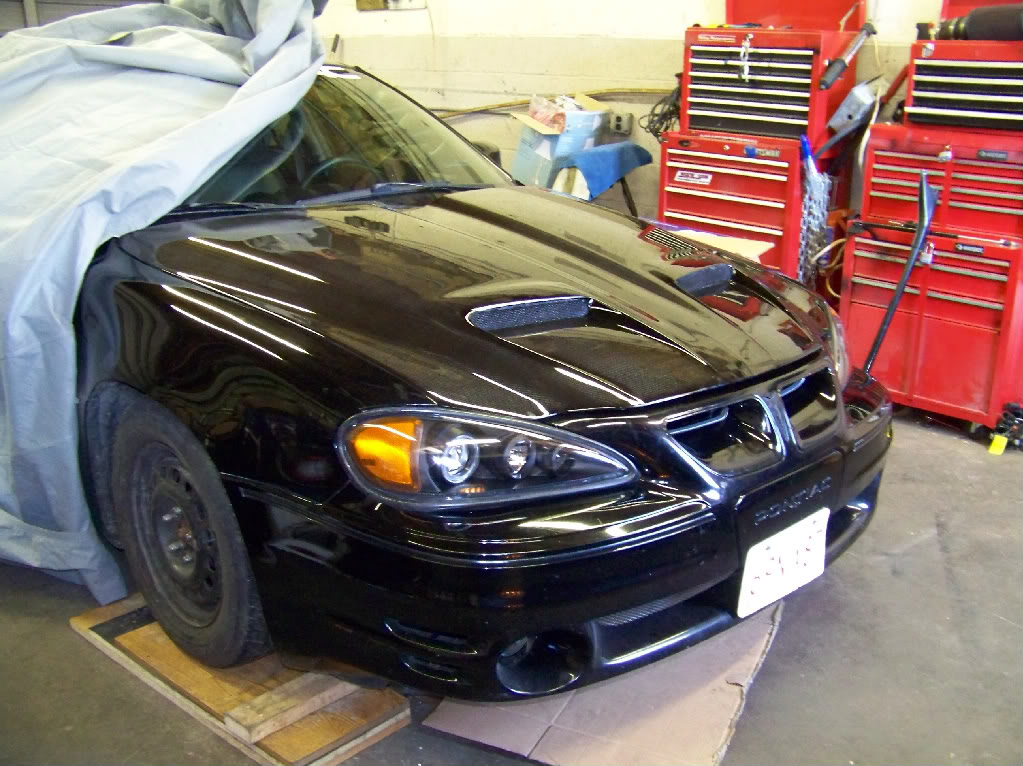

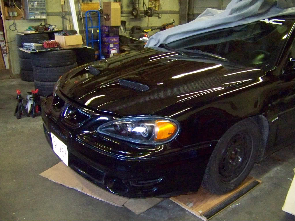

carbon fiber SC/T hood

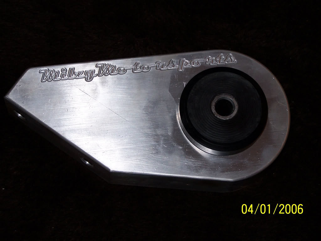

solid motor mount from milzy motorsports
solid trans mount from wot-tech

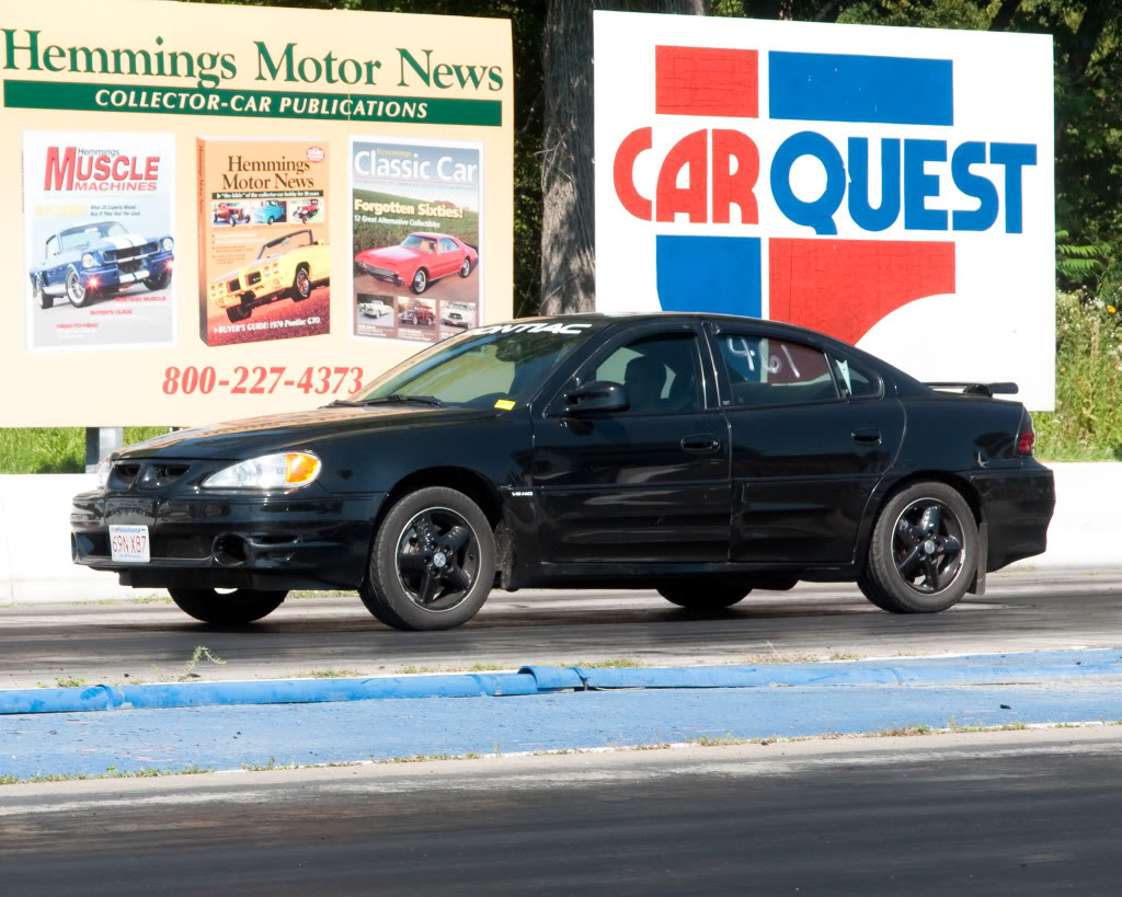

the pic from the day at the track

the solid trans mount

I seriously love your GA. I never knew you had a CF SC/T hood...
What ever happened to it?

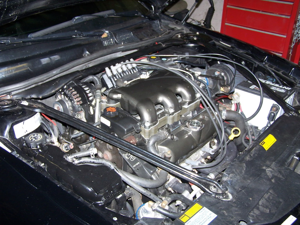

nice Hood! me rikey! and nice clean engine bay. i love it when the engine bays are clean. :)
' date='Jan 25 2010, 05:47 PM' post='5509']
i just got the CF SC/T hood last week.
thank guys. i try to keep the whole car clean but anyone with a dark car knows its impossible.
The hood is awesome and my hood resembles your very much! :lol2:

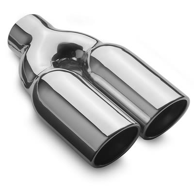

well i finally broke down and ordered a muffler. i went with a Edelbrock 55762 SDT along with these MagnaFlow 35168 tips. ive had the tips for years just didnt feel like re-doing my exhaust so they didnt get used at the time.
