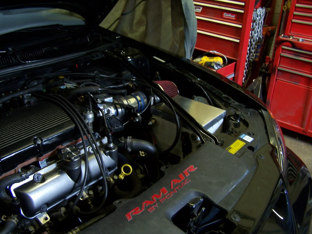

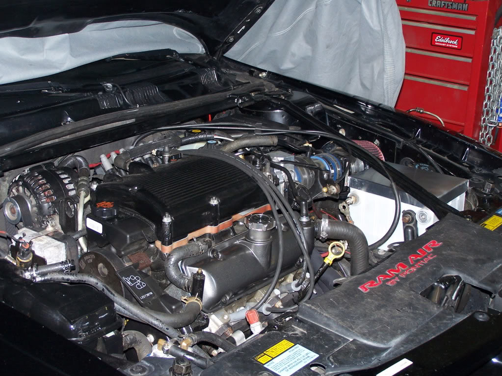

thanks guys. haven't really done anything with it lately besides make a battery cover.
got board last week. iirc it was stupid hot and humid the day i made this so it was the only thing that got done but i did fabricate a little battery cover out of some sheet aluminum i had.
pretty sure i am going to redo it and make another one since i made a cut on one of the ears i folded over that did not need to be there.
I see an LX9 UIM. You get better airflow than the ported LA1?

supposedly it broadens the powerband but no one has any real world proof of it.
in all honesty the car feels the same as before when i had the 3400uim on there. maybe its just me or my butt dyno is out of calibration.

looks good any close up shots? I think next time you should have it cover further down on the battery. I wish I had the tools to do stuff like that with my amagination.
it's already down to the posts on the battery which was 1" IIRC. unless i made it and then drilled the holes out for the terminals.
this was all done with obviously sheet metal, a pair of tin snips and a homemade brake consisting of 2x4's in my vise, so it is real DIY friendly. saw the idea about the DIY brake on an episode of ask this old house.
the homemade brake works pretty good. sandwich the metal in between the 2 pieces of wood shut the vise then bend it over by hand finishing it off with a hammer and another 2x4 piece. you end up with 90* bends with no tooling marks.

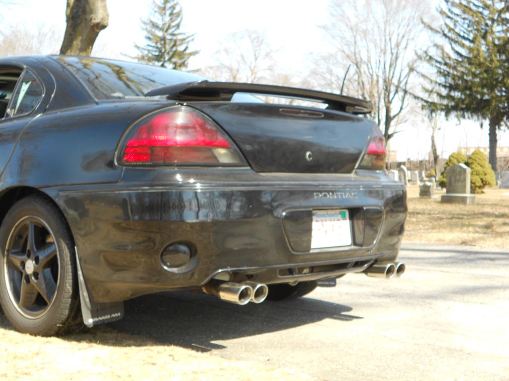

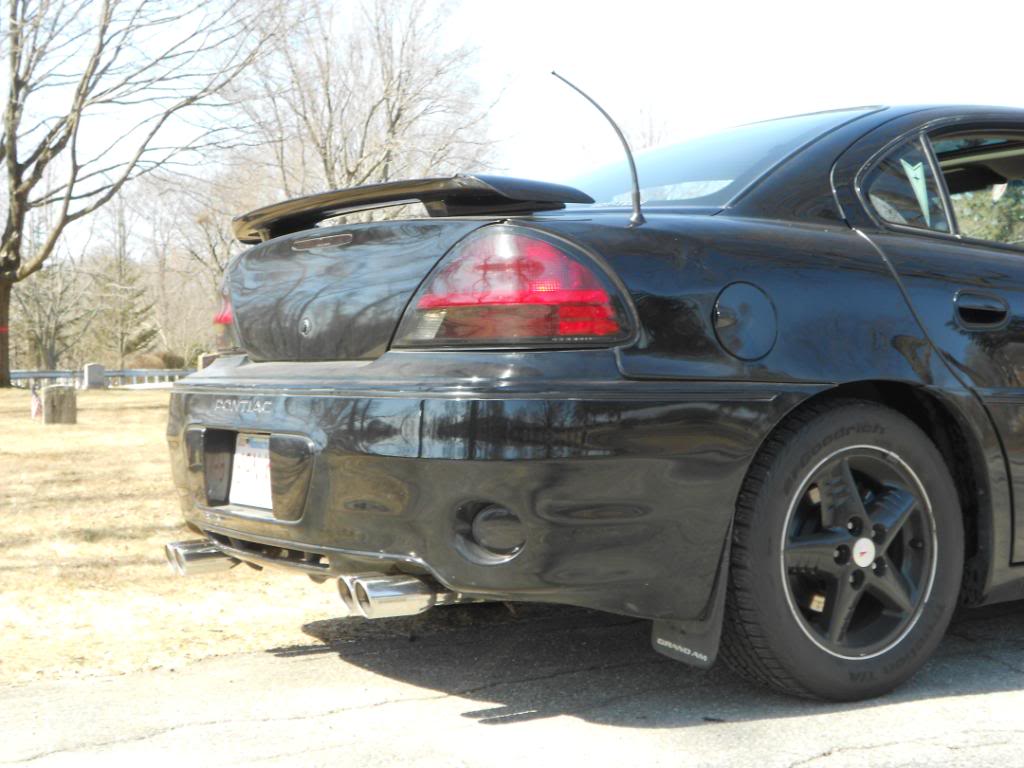

the tips on the car. it was nice and warm the other day so i wanted to see how they looked outside so i went for a drive. still need to weld them to the muffler and fix the mount for the right side (hence the lopsided look) also probably gonna chop some pipe off and set them back further not too crazy on how far they stick out.
Yeah tuck them back just a bit and they'll be good. I still can't get off of the borla tips i love them!

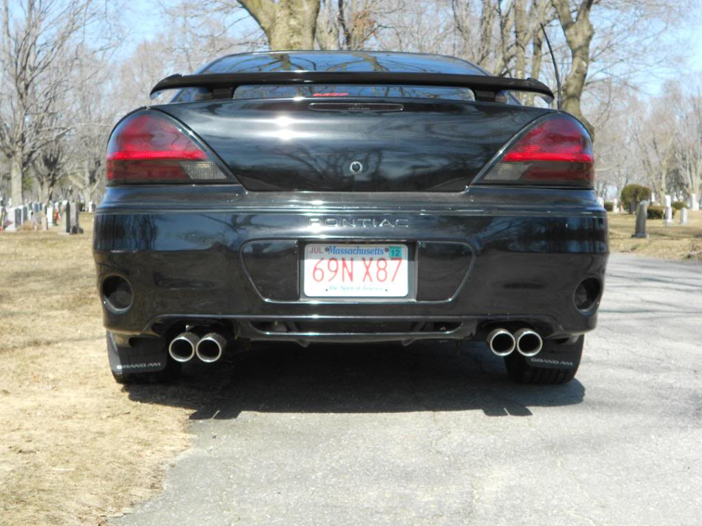

i've had these for years. got them shortly after i got the car way back when i put a flowmaster 80 on but could use them at the time since i the way i put the pipe on the muffler.
now it's a different muffler and finally decided to mount them. right now they are tightly fitted inside the pipe.
they are these tips...see the price hasn't changed since i bought they 4yrs ago.
/>http://www.amazon.com/Magnaflow-35168-Stainless-Steel-Exhaust/dp/B000COTHKI

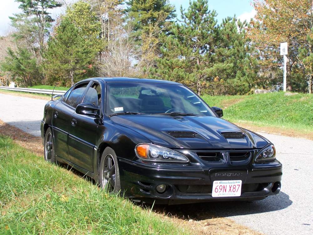

so yes or no on the color change. black was getting old for quite some time and i had the paint from something else i painted.
the color is actually metallic charcoal.
click the pic it get's bigger
I dig it.
