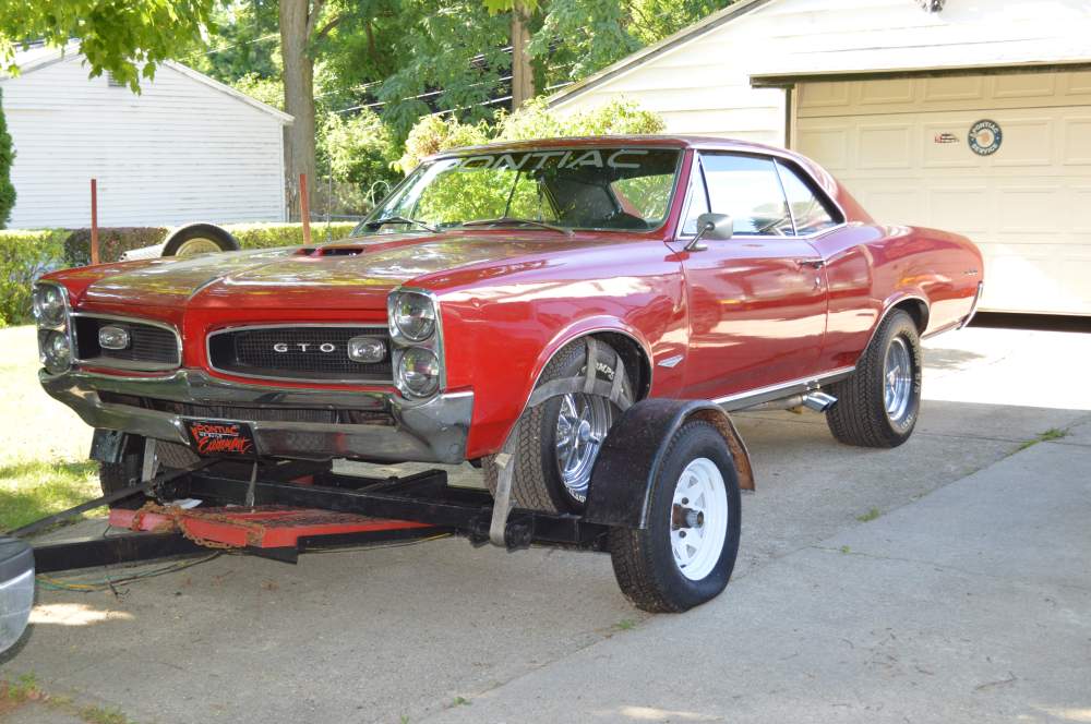

Is it justA me or won’t that trailer pull and push on each of the gto front wheels when you turn ????
And break the hold down straps ????
Fixing the front wheels down on a ridged tow dolly makes the back wheels scrub and you might get away with that towing the sunbird , but the gto is wayyyyy heavier
NO the trailer frame N tires are fixed position. The wheel buckets for car being towed are separate and on a swivel. My problem was/is the tires. Those are L60 -14 (made for the rear of the car) I wanted the steamroller look. They are too wide for the webb/tire tie downs. Barely extended down the side walls. What made them slide off to the outside edge was a mystery. Adding bungee's to the inside of webb and connecting to the frame of the wheel buckets kept them on for the last leg of my trip with a chain backup.

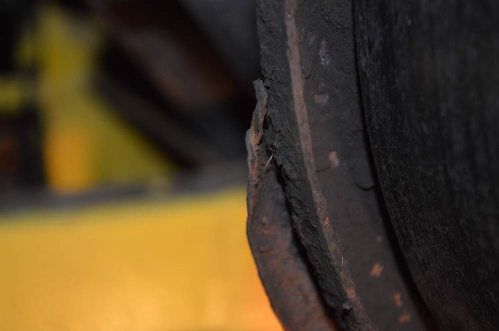

Bought copper lines instead of Inline. He bent em up perfectly and called to say it's ready. Took the GTO for a test romp and was sooo happy. 10 - 15 mi run home. Then came the grinding noise. Sounded like the driveshaft was dragging. Bumped it and it jumped forward so driveshaft is ok. I'm on side of road and can find nothing wrong. Driveshaft is riding perfectly in the middle of safety loop. Drove it to the next rd and got off highway, Again can find nothing wrong but gawd is making noise. It's in drivetrain, noise doesnt change with engine RPM. Got home N threw it up on stands, it will not make a noise now. Proceeds to a no start hissyfit. Fine...sit there N rust ya B'ia. Car has never sat outside since I brought it home back in 06. Proceeded to finish cleaning the SunBird Only to have that a no start as well. Fuel pump is crankin away, but no pressure. The pump gave me fits last year. Dropped in a new set of plugs in the GTO, have never pulled anything out that badly fouled. Don't know if was the bad 3 yr old gas or what. Put the GTO back in the air and pulled rear wheels to check brakes. It has to be a broken spring, retainer or something. NOPE one small spot on the backing plate has worn shiny. I straightened that out and spent better than an hour cleaning polishing the rim N tire. Have had maintenance to mess with my lawn tractor, Mel's G6, Muddy roads have kept me from driving or getting the Sunbird in a position to change the damn fuel pump. Now that the GTO is running well again, need to get out and have a new TV cable installed and adjusted with the trans guy. Running short of summer and I haven't been to a show yet,
Could the grinding be coming from your diff? Do you need some posi-lube or is the diff oil low? BB did that to me a for a long time. I finally added a bottle of post-lube and a diff oil change while on Power Tour in 2024 and she's been quiet ever since.
How do the bearings look on the U-joints?
Any chance the front rotors are warped?
I am spit balling at this point.
Not coming from the front. Not an engine issue. Waiting on nap time round here to take it on a short trip round the block and out to pavement. Rear end would not make such a grinding noise. Nor would the noise go away. Only one spot that was shiny from contact was the backing plate that looks like it's missing 2-3in of material. Thinkin maybe it ground itself down, but that doesn't work as the rear wheels were on the ground towing it all the way to the shop and then drove it most of the way Home before prob.

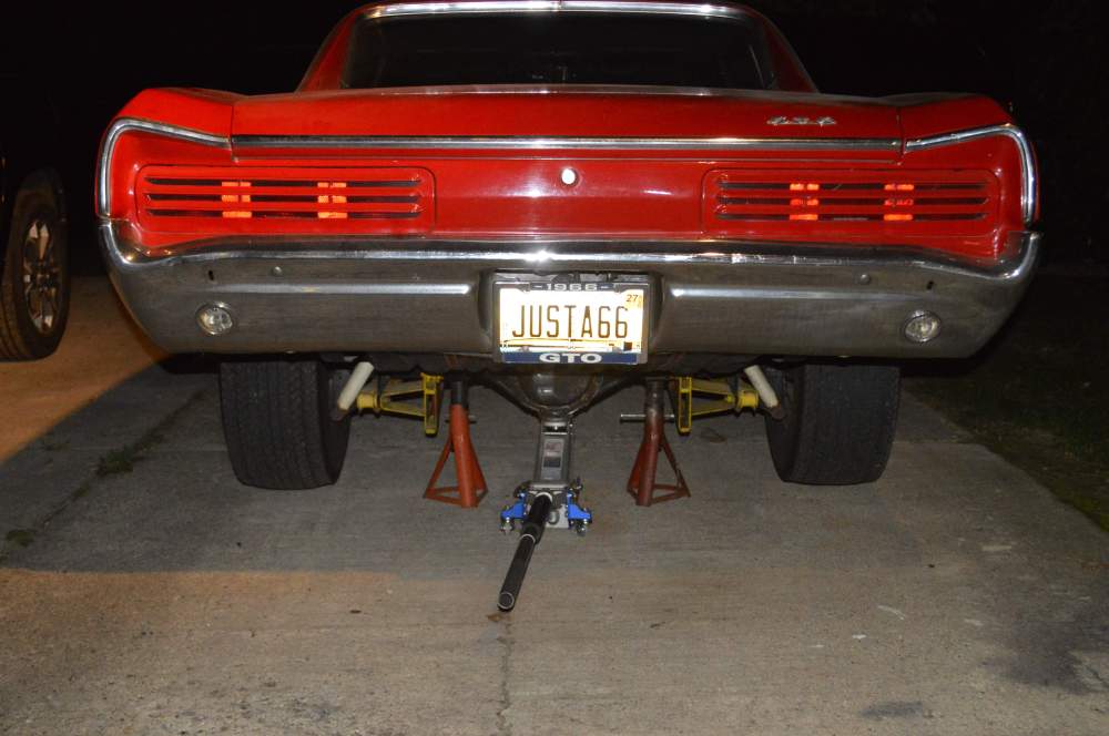

Once I put it up on stands in the driveway, it stopped the grinding noise. With my head out the door or window on the way home it sounded like drivers rear. Unless I somehow had a pebble or something wedged into the drum backing plate and reversing into the drive popped it out.
