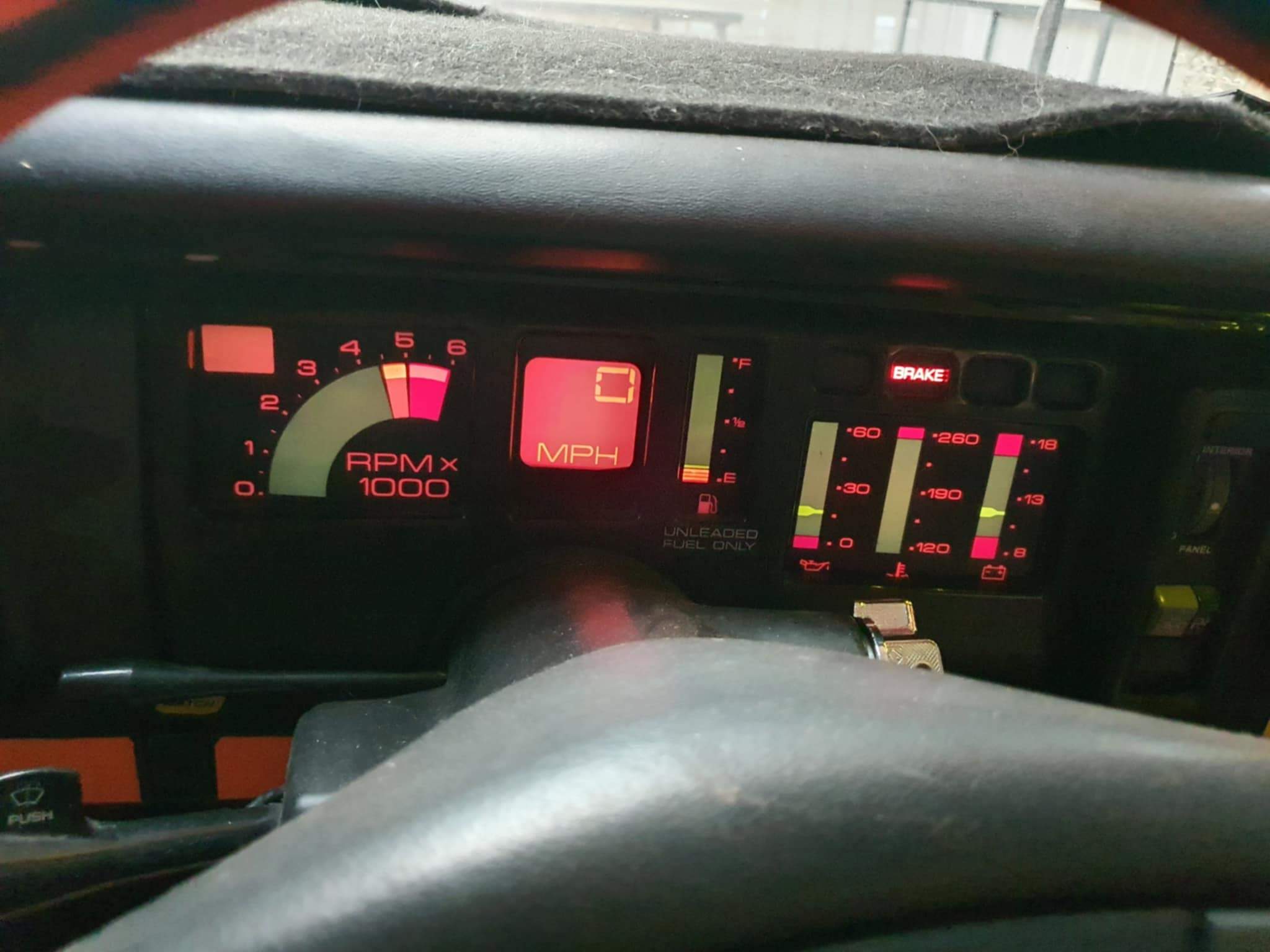

You also mentioned that your car has a Digital Dashboard..Is it an Aftermarket Unit..?? Or is it a Factory LCD ( Liquid Crystal Display )...??  The LCD Dashboard is a Factory Option that was available on any Firebird/Trans Am/GTA..Unfortunately Without the Service Parts Identification sticker...It would Impossible for Me to determine Whether or Not Your Car Came from the Factory with the LCD Option or Not..🤔🤔..

I dont know about the dash....My hubby always thought it was original. Hopefully the paperwork will tell me.

Can you post a pic of the dash lit up?
Yes..I will get one over the weekend.

on a couple of other earlier discussions.....see pic of lit up digital dash - and the fb guy verified it is original as he looked at the vehicle invoice and its coded there as U52.  It also says the car came with 16" rims. Of which we removed today and were surprised to see made in japan on them...see pic...is that normal?
