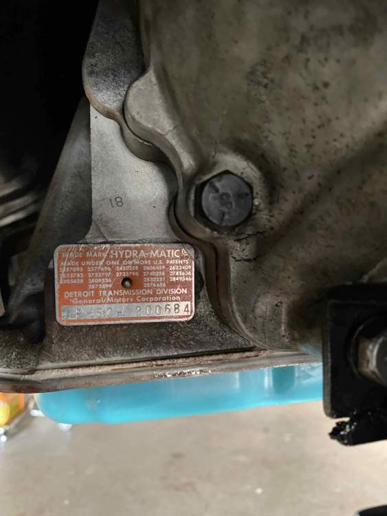

    More Useless Trivia..??? Just in case anyone is curious...The transmission ID plate indicates.. Hydramatic..(different from the Roto-Hydramatic...Commonly Known as "slim jim") P = Stand
P = Standard 2bbl. Installation..
60 = Year of MFG..
200684 = Sequential number..
Tri-power and Super Duty Hydramatic cars Have a Different Prefix Code...   Police/Taxi and Ambulance also Have their own unique Prefix Code...
TLBT..
