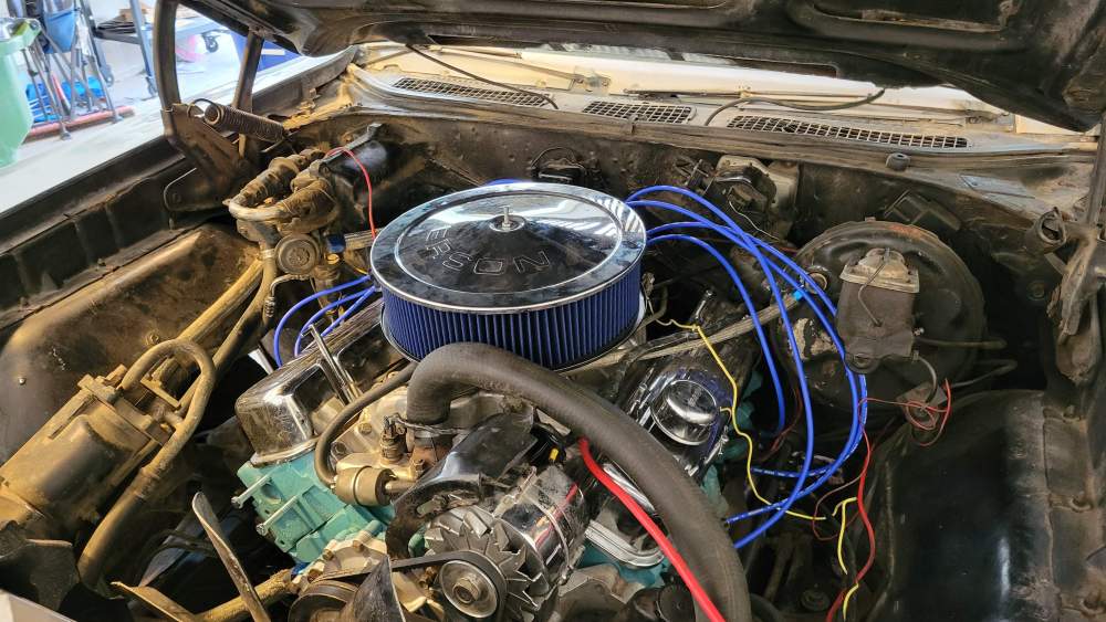

The fluid looks a bit darker than usual and yeah kind of smells burnt. And since I just changed the fluid and filter like two months ago that's not good...
Here are some pics!
