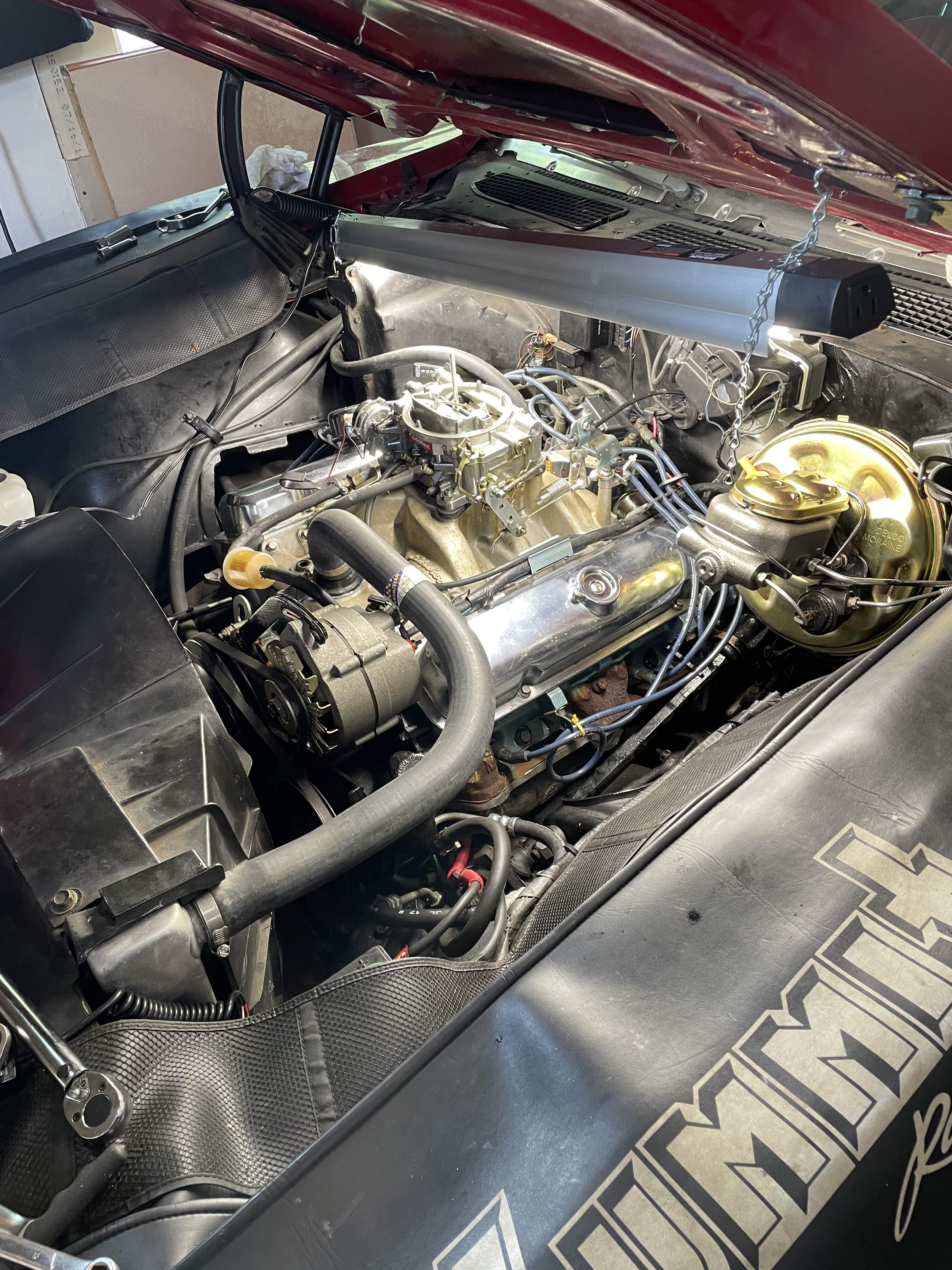

now... has anyone here told you we love pictures ??? show us the set up on your motor :dancingpontiac:
