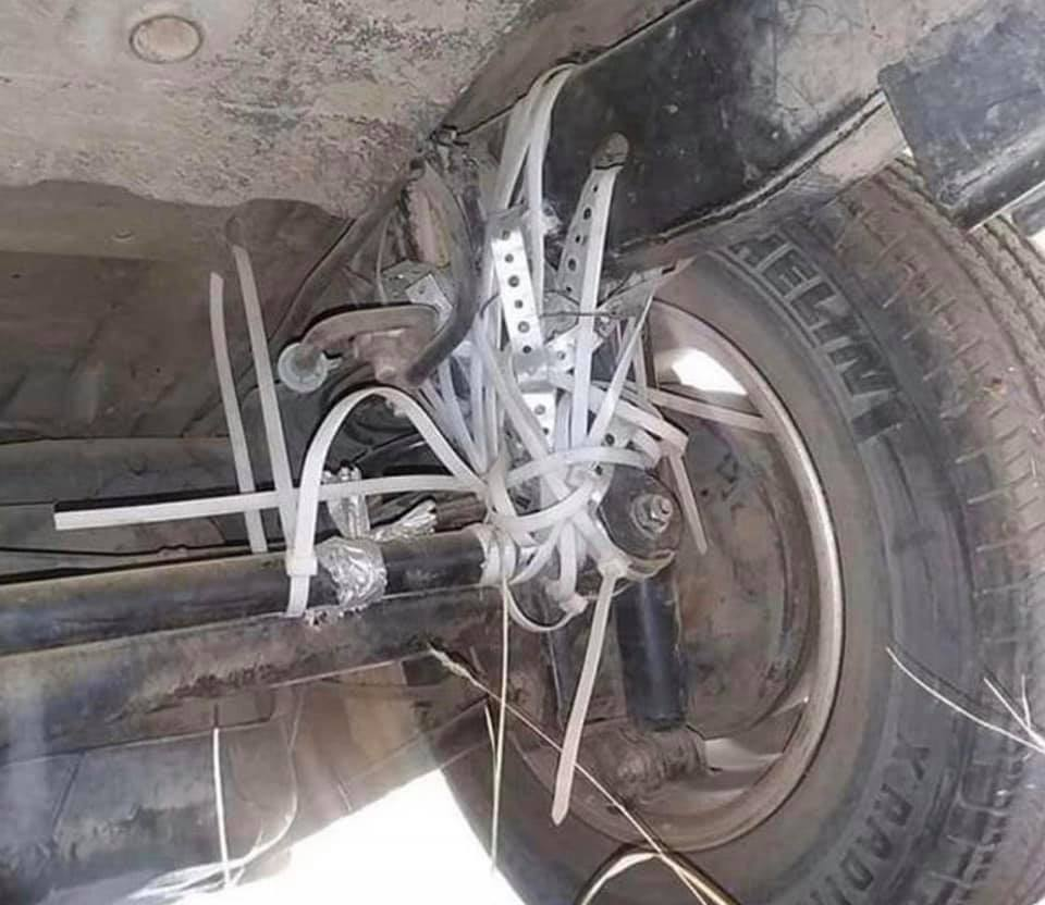

Glad you got er fixed N on the road, enjoy your Pontiac.  Hope you have many miles of smiles in front of you. We look forward to pic's from your shows N cruise nights. :driving:
This has been your Zip Tie moment from Roadkill.:rofl:
