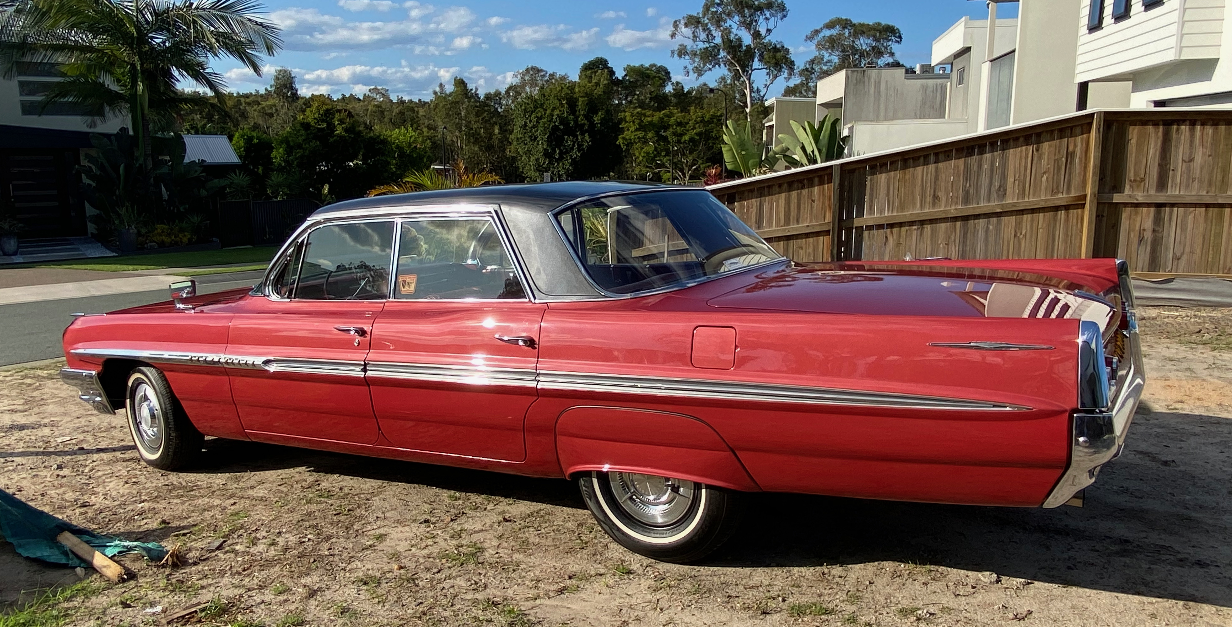

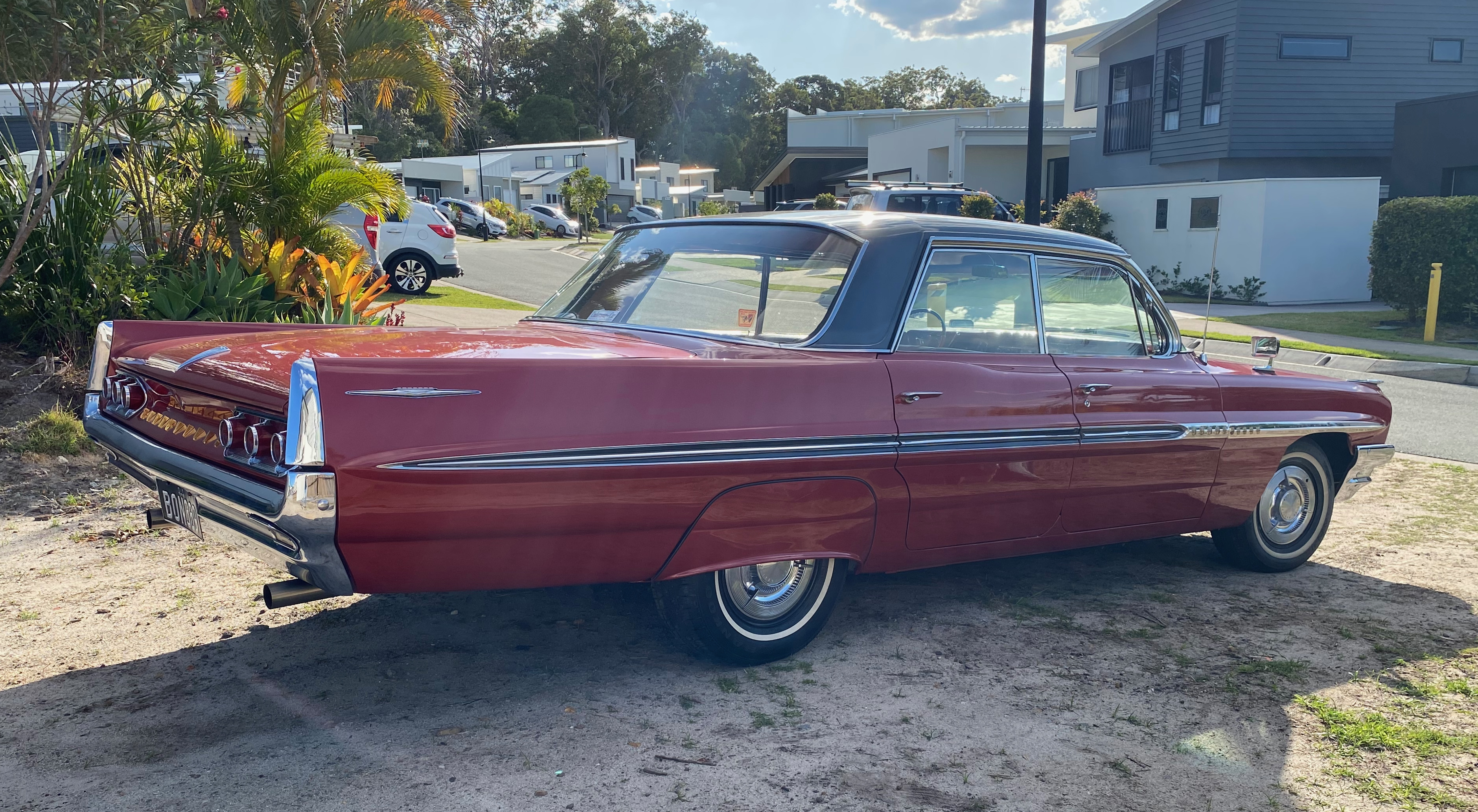

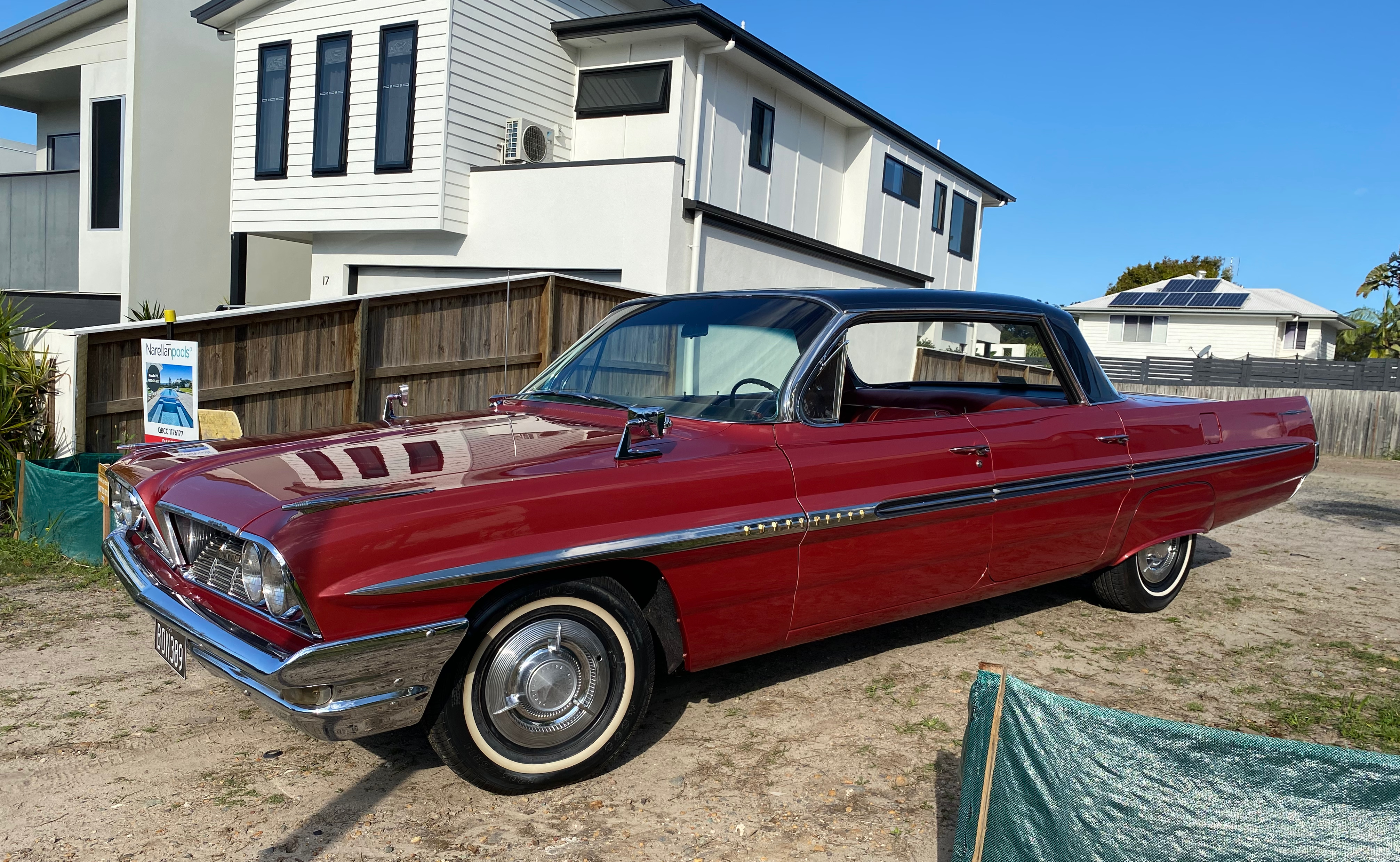

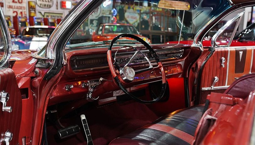

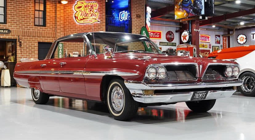

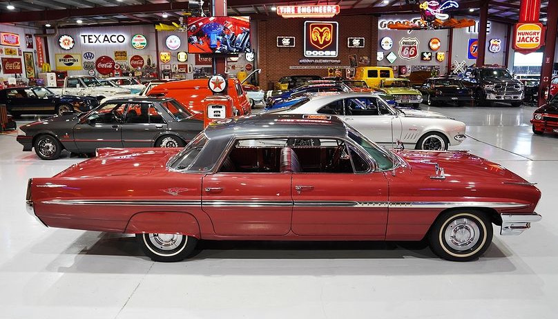

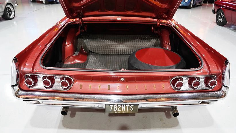

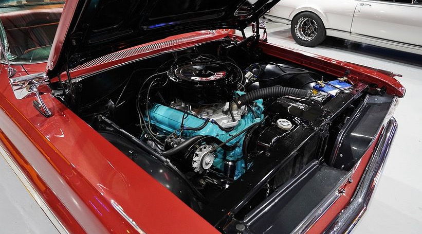

Oh, and here are the pics I've been promising of my car 😃
Again, sorry I've been so damn slow.

Beautiful car indeed!
Wow....Eyecandy.  Have always liked that color combo for the interior.
Hey Paul, welcome! Sorry for the problem. Not that it matters now as it appears you have it handled, but from the 20,000 foot view it really looks like somebody altered the hub to put a different bearing in it. No manufacturer would make that thin of a wall on a wheel hub.
& wow love the car too! Beautiful!
Edited by Last Indian
Wow paul ! Love that colour on your 61 :cheers:
Hey, I've just noticed you're from Pontiac, Michigan. According to the numbers on our Bonne, it was manufactured in the Pontiac factory there.
