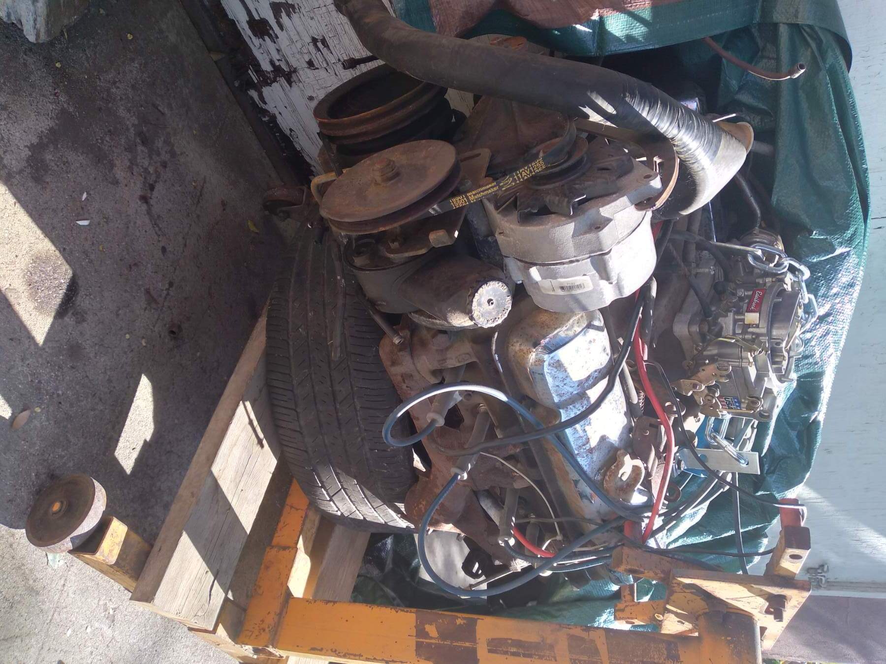

currently I have what I believe is a 350 YN code. But my dad and a mechanic seem to believe its a 400. I have researched and found no 400 to be a YN code. Also above the YN letters is 0283493. My research says its  base 350 with 265 HP. Could I be wrong?

Thats where I checked INDYMANJOE. So its just a 350 and thats what I've been trying to tell them.

Update on the bird and it makes no sense to me. Casting numbers are 488988. YN code on the front. And FROSTY it is not matching the vin. So going forward I will eventually put the 428 in it.

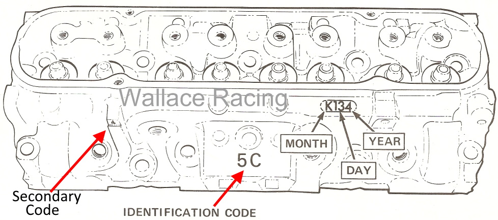

And the heads are one of the three. 5C, 50, 56. I only found 5C for pontiac heads. Anyone know more about this situation
Okay Bernardo. If 488988 is the casting number on the block, this matches up with a 1974 or 1975 Pontiac 400 block. You can tell by the date code stamped by the distributor hole. This further supports that this is not the original motor. Since you talk about having 5C heads, I am guessing you have a 1975 motor.
Photos help where you found these numbers on the heads.
I am assuming you found the 5C in the middle as shown above.

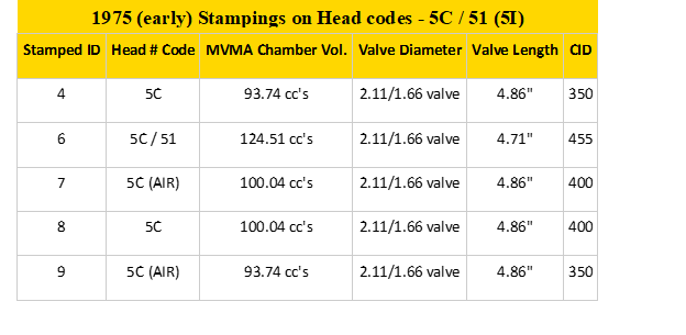

5C heads from 1975 could be one of the following heads:
