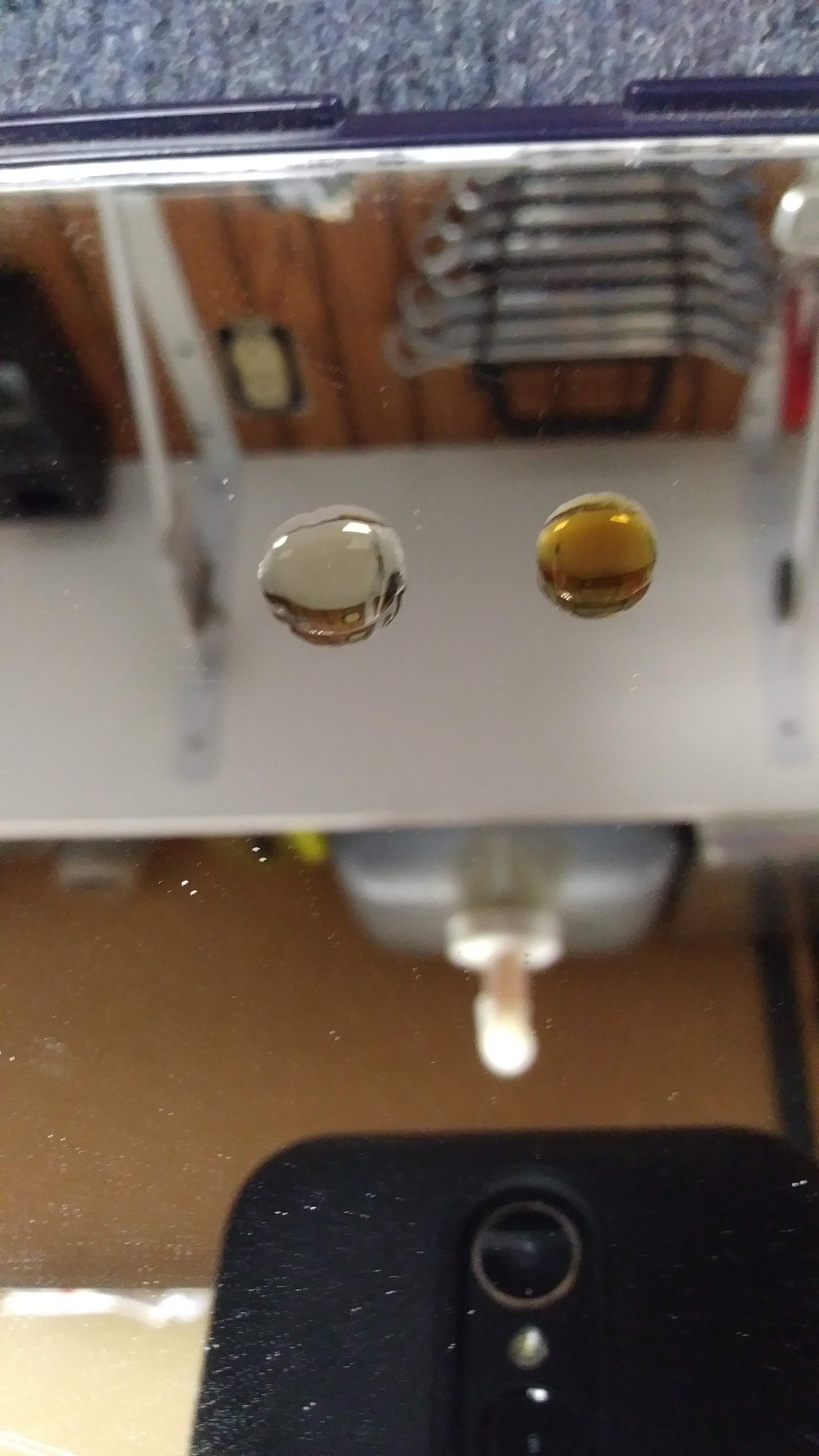

Well! This is going to take some explaining to say the least & I have no doubt there will be skeptics! But,
this is something I’ve done since I was 14 years old! Yes I was young I know hard to believe! But I started working on cars @ 11 & racing @ 14. None the less I had done it so long it was just second nature to me. As I got more and more involved with specialty projects at work that centered around oil quality folks that I worked with were amazed at how accurate I would be about oil conditions when we would get test results back from samples we had taken and I had commented on at the time of extraction. I have always just used a white absorbent paper towel to wipe the oil on and then read the color. This is how I could judge the condition of the oil. In 1998 two colleagues that I had worked with for several years took some interest as to how I did this, so I tried to show them, but no matter how I tried they could not see what I would see! That led me to start working with black light to try to enhance the iridescent quality of the changing components of the oil. This helped some, but there were just to many irons in the fire at that time we all moved on to different projects. Than mid 2003 I approached our Vice President of research about the idea & if there was some way to take chemistry that would enhance a sample of oil when it was wiped on to a treated paper. So in early 2004 a patent was applied for to do just that. Now I’m not a chemist, I had learned much in 35 years, but not how to do that! So through some of my guidance we had arrived at a solution. It wasn’t perfect in my opinion, but I didn’t have the last word. If you what you can see that patent, just google US7754488 patent.
Since then I have found some other ways that seem to enhance color observations better that just wiping oil on a white absorbent paper, which is what I typically have always done, no chemistry on the paper So now I will try explain & show as we go forward. Some of this I will need to figure out how or where I will get samples. As of right now I have oil samples I will show, but they’re all from health engines! Meaning the oil is just aged from use. These samples run from the indian (2000 Grand Prix) @ 500 mile, 2013 Buick @ 2800 & 2012 Buick @ 3300, which is just about due for an oil change!
So these are a good starting point, but you can also see, when present, fuel dilution, too much blow-by, coolant leaks, emulsion, excessive carbon & abnormal wear!

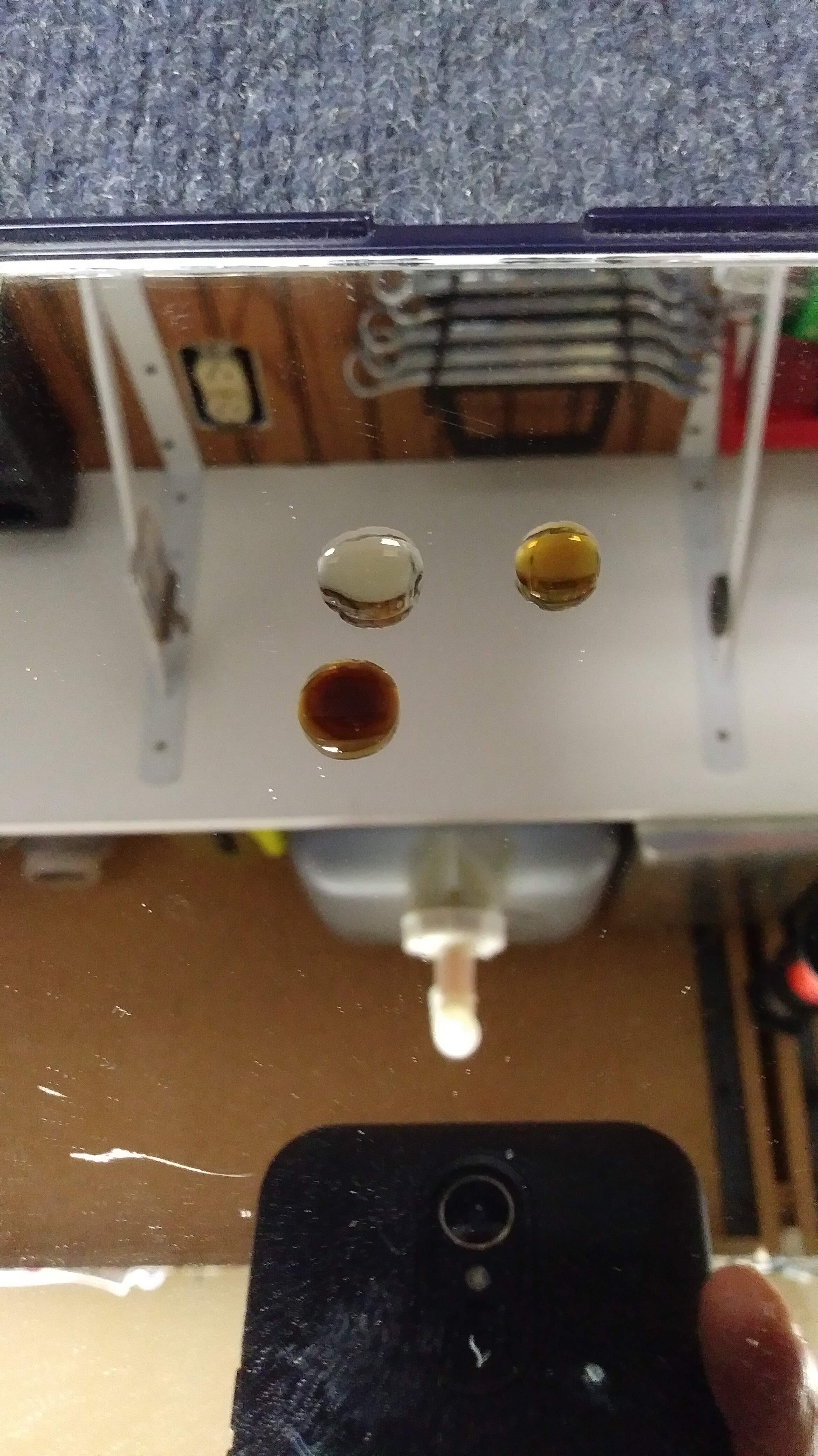

the picture below! Left drop of oil is brand new Oil from my supply. The drop on the right is from the Indian, it has 500 miles on it. It’s a perfect color for the mileage.
this picture below is the Same as above with the addition of the bottom left drop being from 2013 Buick 3.6 direct injection. This oil has 2800 miles on it. If you look close you’ll see the red hue of the oil! You’ll also notice that it has the appearance of a darker center that seem to be speckled ever so slightly! The red hue is oxidation of the oil. The red hue is a good indicator of the oxidation level.

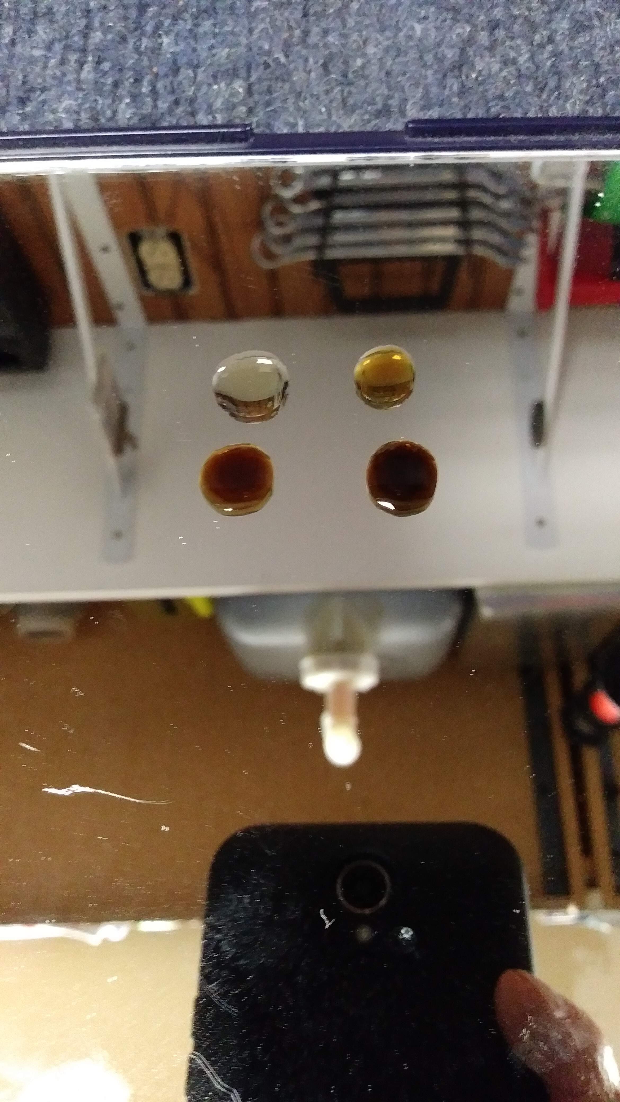

this picture below is again the same as above with the addition of the right lower drop of oil. This drop is from a 2012 Buick 3.6 direct injection. This oil has 3300 miles on it and needs changed soon! Notice the chocolate red color with no outer fringe of red, but if you look close again is an appearance of speckling. This indicates that carbon, varnish and heavy oxidation have taken place and the only thing that will now come from this oil is going to be more negative than the protection the oil can offer! Metal surfaces will start to varnish up & carbon will start to buildup!

Can you explain what you would like me to explain to try and make things more clear? I understand there might easily be a learning curve!
