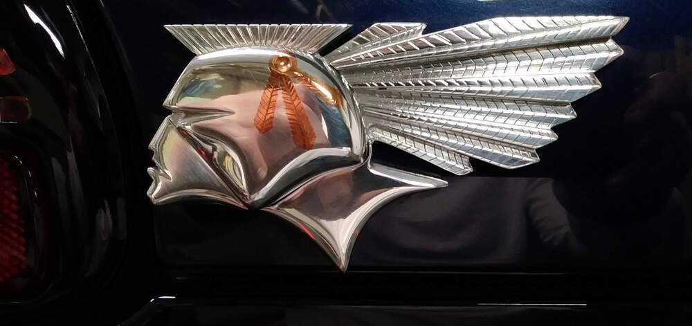

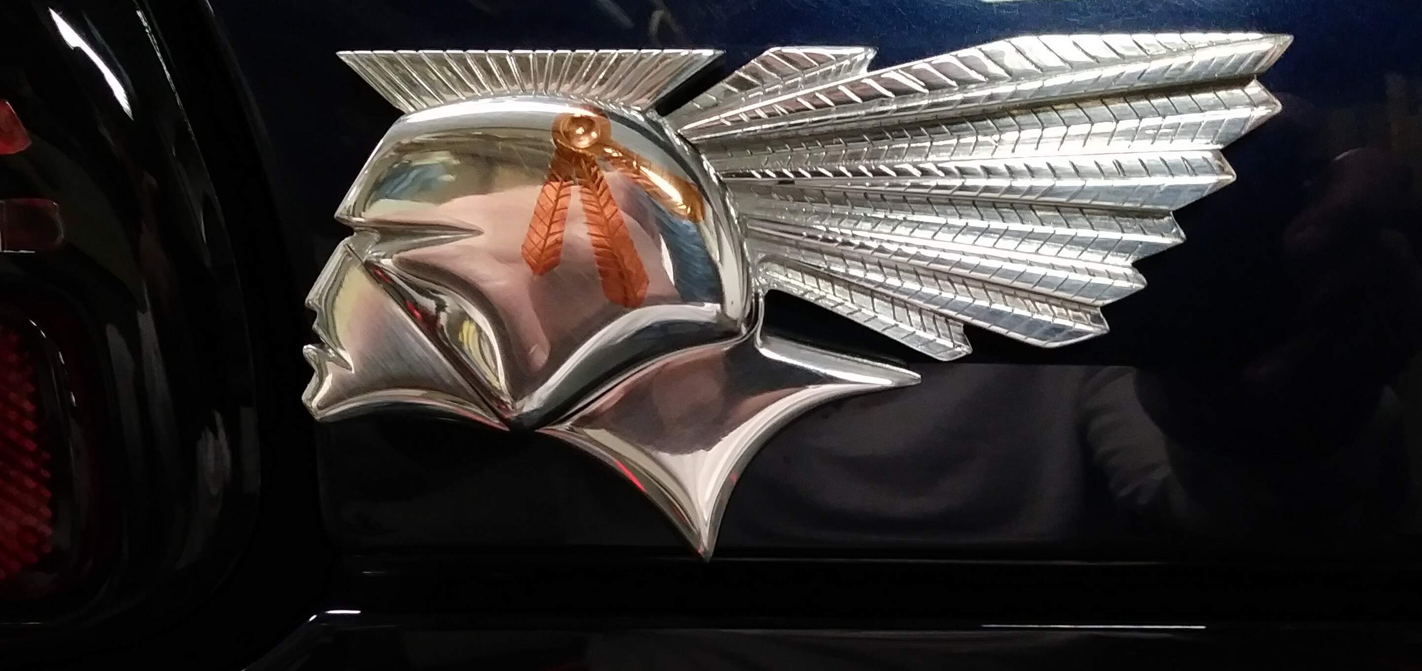

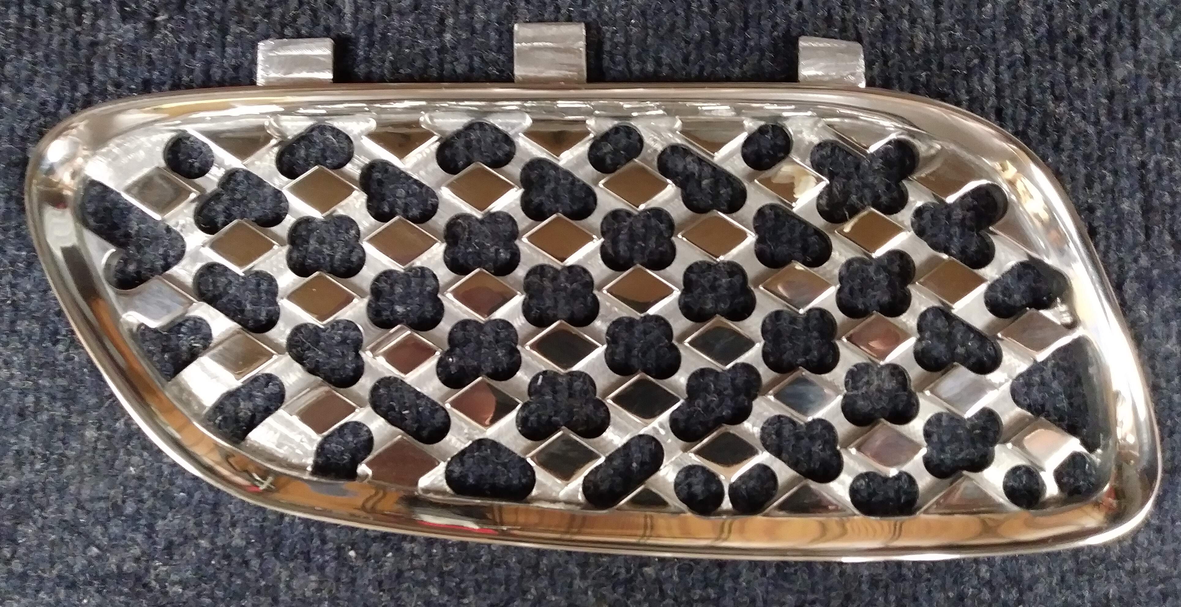

Yup the wheels take some patients, but these push the things to new heights.
The outer rim inset is all finished by hand, as well as all the detail!
All those lines on the Indian are carved in by hand! It’s actually a little painful!

Last indian, what gets me is your sooo clearly a patient man
 but also clearly very clever!
 why did you spend your working life as a oil scientist when you could have been in automotive design ?
 i am in aww off what you have hand made!:bowdown:
 you have shown us your super clean engineering shop/ garage
 i am thinking you have always done this... these 2 fields are so far way from each other, i wonder if you had always had this hands on metal thing going on ??🙄
