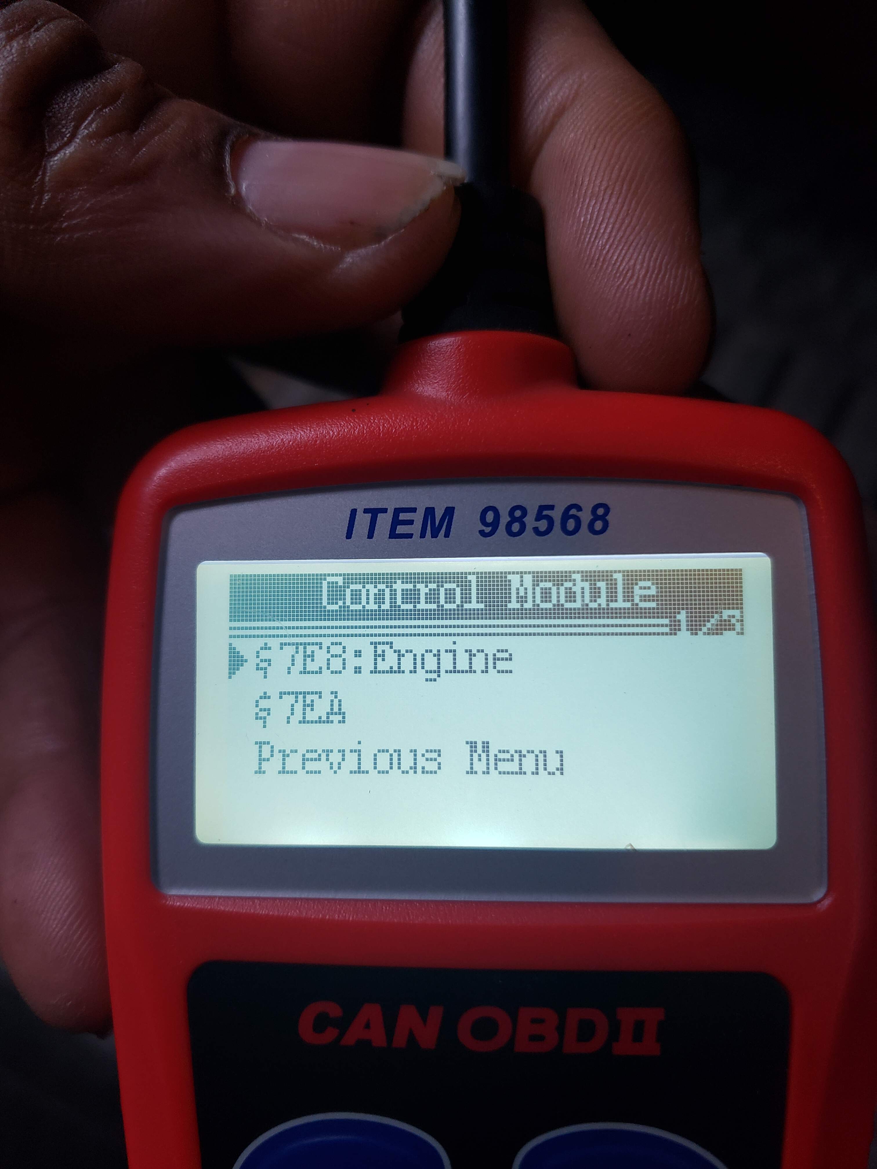

AON;Ā  Ā A $7E8 engine code read.
I have an appointment with a trusted automotive service and repair shop( ex- employer) on Friday, I'm just curious. The check engine light came on yesterday and that was the code that showed up when it was hooked up during all the issues going on with the fuse. When I googled it then it mentionedĀ air intake and the knock sensor.Ā would a dirty air filter give this reading or could this indicate something more serious? I did noticeĀ a slightĀ vibration the last time I drove it when the check engine light first came on. It operated without failure for the 12Ā  city blocks needed to drive it back home where it remains parked. I'm just trying to gaugeĀ what type of repairs I may be facing.

Regarding the $7EA and $7E8 codes, those appear to be hexadecimal codes and admittedly I am not able to convert the codes to the standard "P", "B" or "C" codes (I did some searching on those codes but my interwebbing skills are currently failing me). Not sure if anyone else can chime in with more information regarding the codes.
The 7E8 code is a cat failure code. Which can be a number of things! Complete cat failure, a crack in the housing or pipe or flange. You’ll have to inspect it to see. More than likely with the car in the air and running.
Ok, gotta ask how you were able to decipher those codes (internet search... ?) so I can do it should something like that come up again šŸ™‚
I have a GM code book from my days in the business, but I do believe if you put that in to aĀ search for 7e8 engine code you can find it that way too.Ā

Ummm...doesn't $7E8 indicate the engine data stream and $7EAĀ indicate the transmission data stream and not a particular error code? I'm not arguing with Last Indian's diagnosis but I thought $7E8/$7EA indicated another menu needed to be selected. Just asking....
Correct Frosty! I know I said code, but the data, not a code,Ā indicates a cat issue not a sensor issue, or at least that’s the way I interpret it to be. Which is way I said a cat issue or pipe.
Yeah, from what I've been reading that sounds spot-on. The way I view it in my mind, and in part to check my understanding, is the hex valuesĀ  are similar to reading live data from a vehicle (how some scan tools can show real-time sensor voltages, MAP In/Hg's, etc., etc.). Essentially the "$7EA", for example, is the "stream" and contained in that stream are the various values for whatever component $7EA references. Then, if one of those values (lets say an O2 voltage value) is out of specification, THEN a P-code (or B or C code - depending on the fault / component) is set and so long as the P-code is active you are the proud owner of an illuminated MIL.
