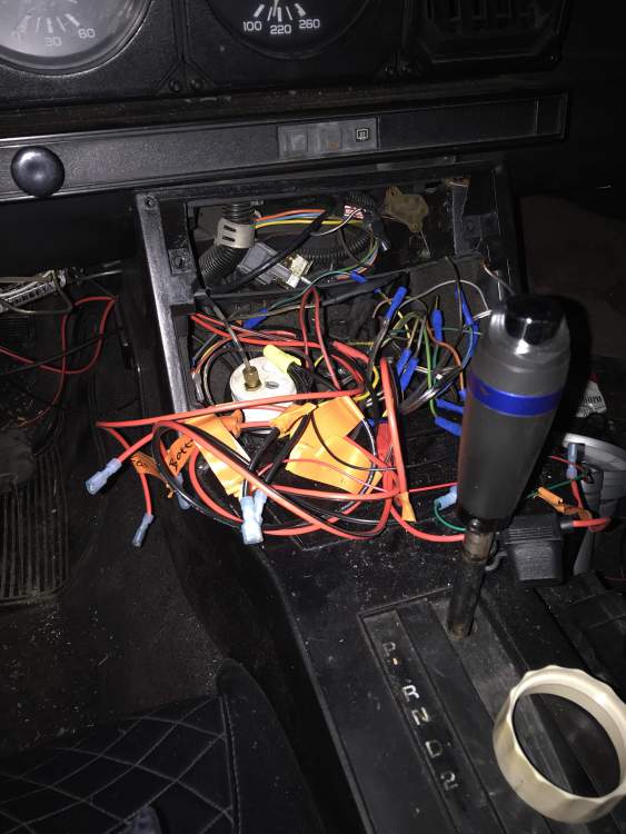

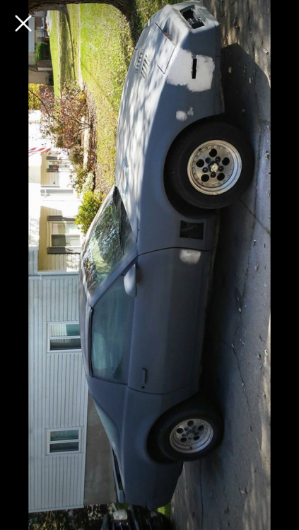

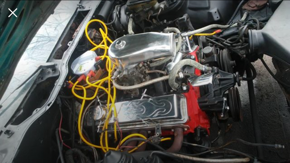

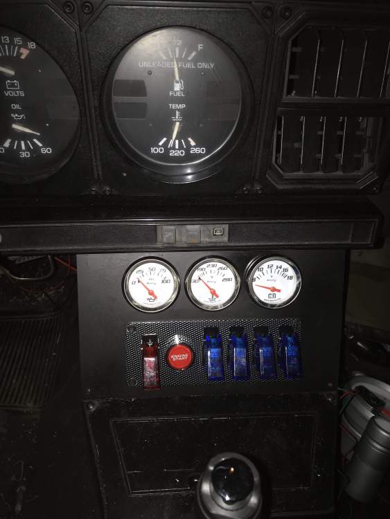

Here’s progress so far.
305 to 350
Original state of wiring and what I did
