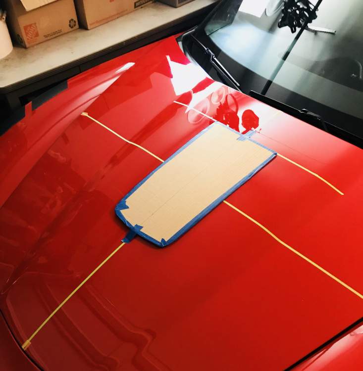

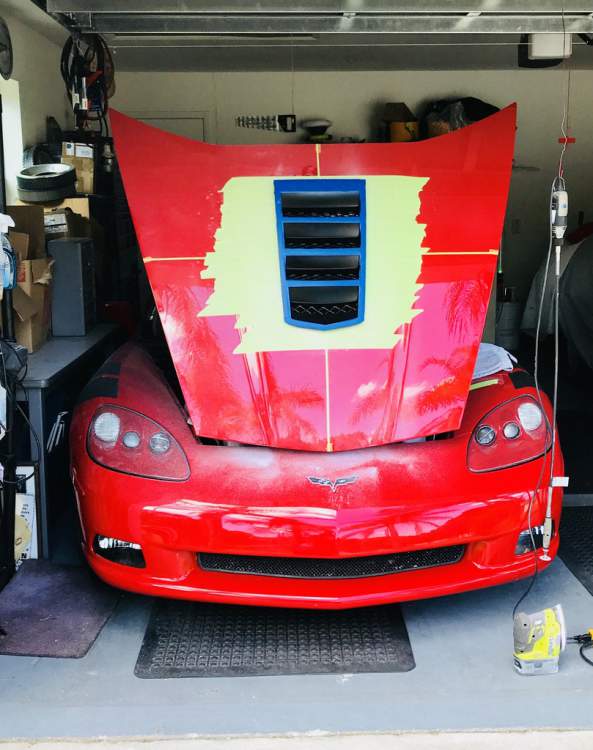

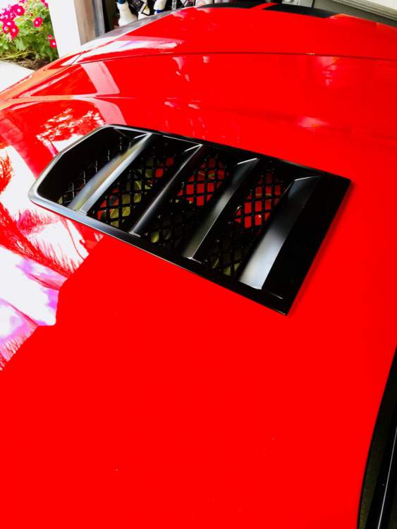

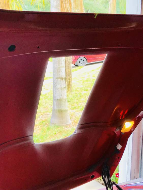

Huevos Gigantes needed to start this project and its been in the back of my mind for quite some time. I've wanted to do some type of exterior mod like add an aftermarket hood to the Corvette but in most cases that party starts around $1,200 - $1,500 just to get in the door so I decided to add my own ventilation to the hood this weekend so here's the beginning. Enjoy.
I'll have more pics up as the mounting of this heat extractor continues.

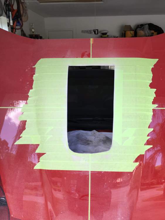

WOW that takes some gonad's (at least a couple beers) to cut that hood.  Does look good!
Brother I didn’t sleep the night before going they all the scenarios and processes good or bad before I pulled the trigger and did it.
I am so far happy with the outcome I don’t regret doing it and I have read a 40 degree drop in oil temps, up to a 20 degree drop in coolant temp and noticeably more downforce on the nose of the car at speed.
Makes it all worthwhile and now you can get some sleep.

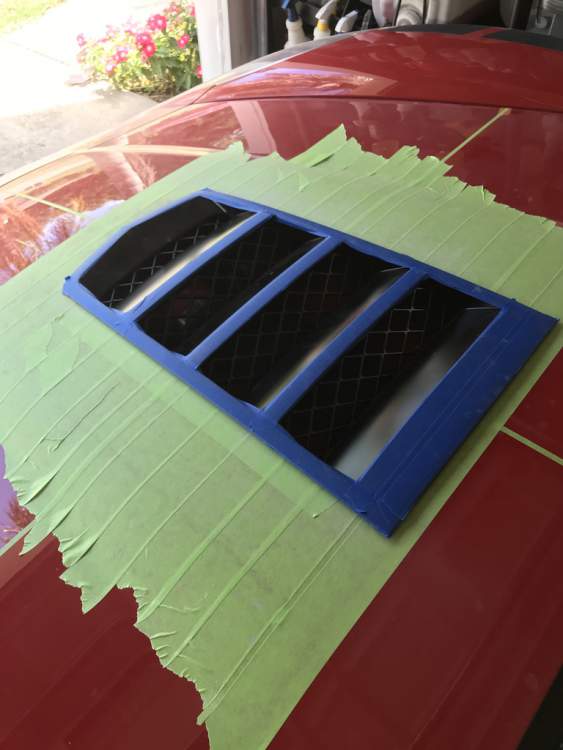

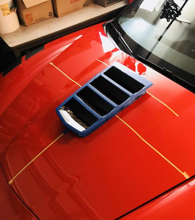

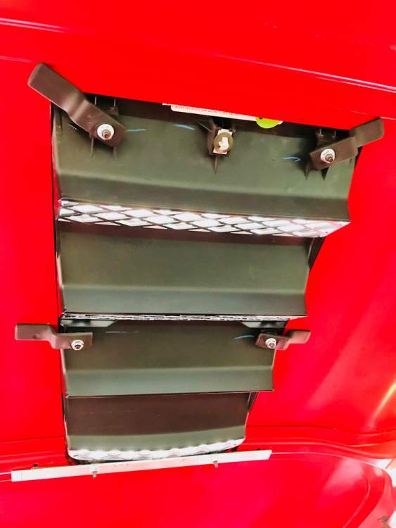

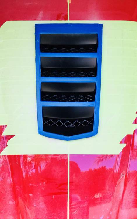

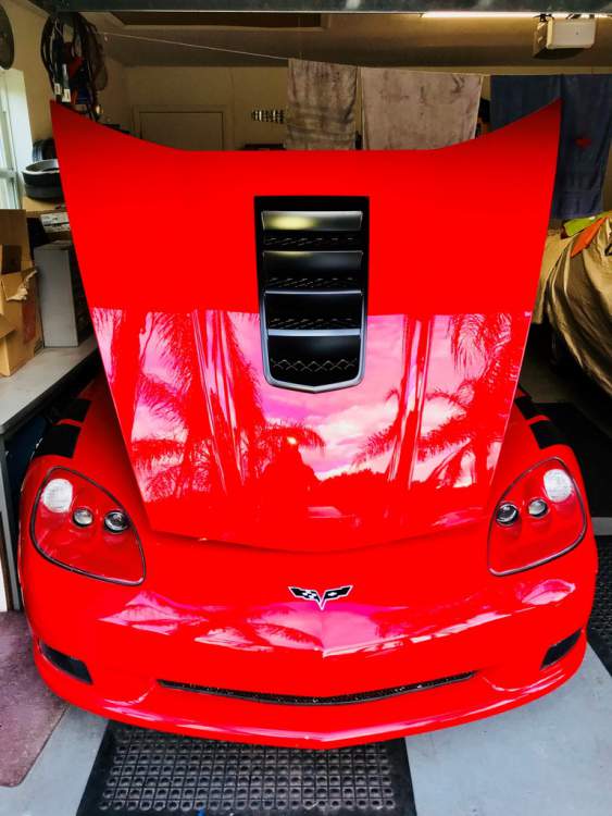

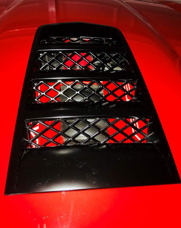

Project ventilation complete. Still some detail work to do on the bottom mount bar. But the temp gauges all show improved temp drops.
Nice job buddy. 🏆
Do you need to paint the bracing and underhood lattice work?

And; there it is! Killer, Cool!😎
