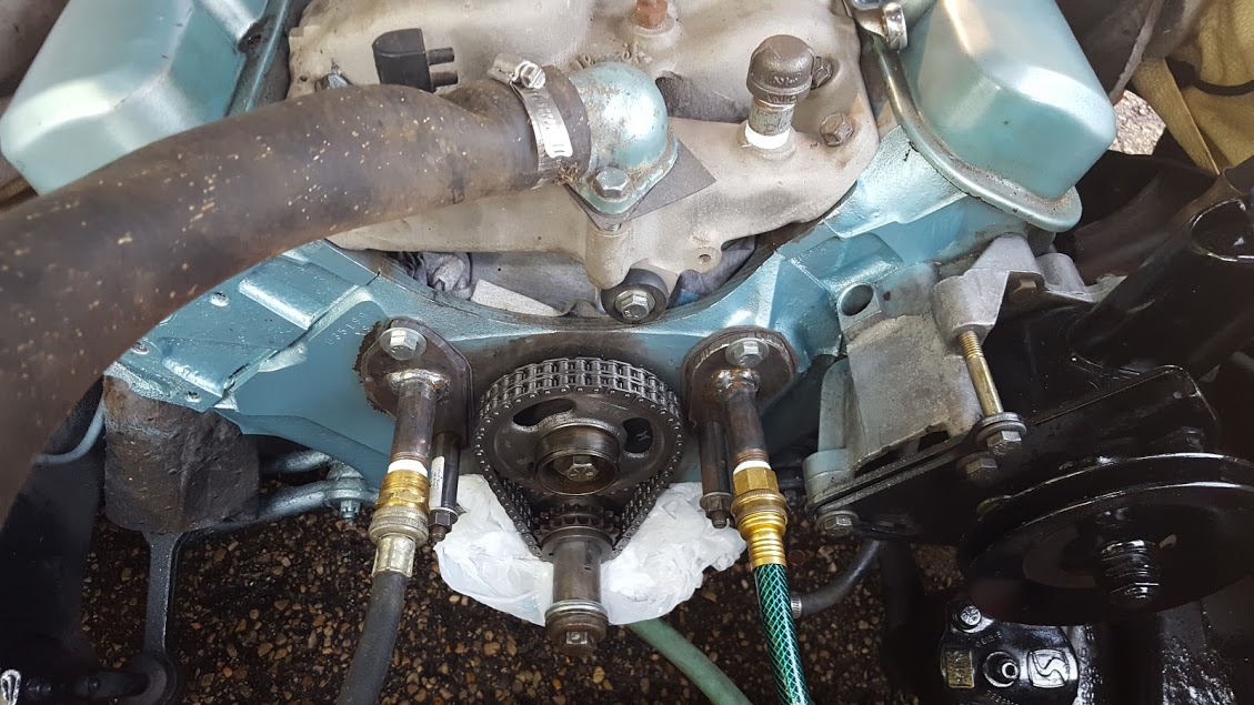

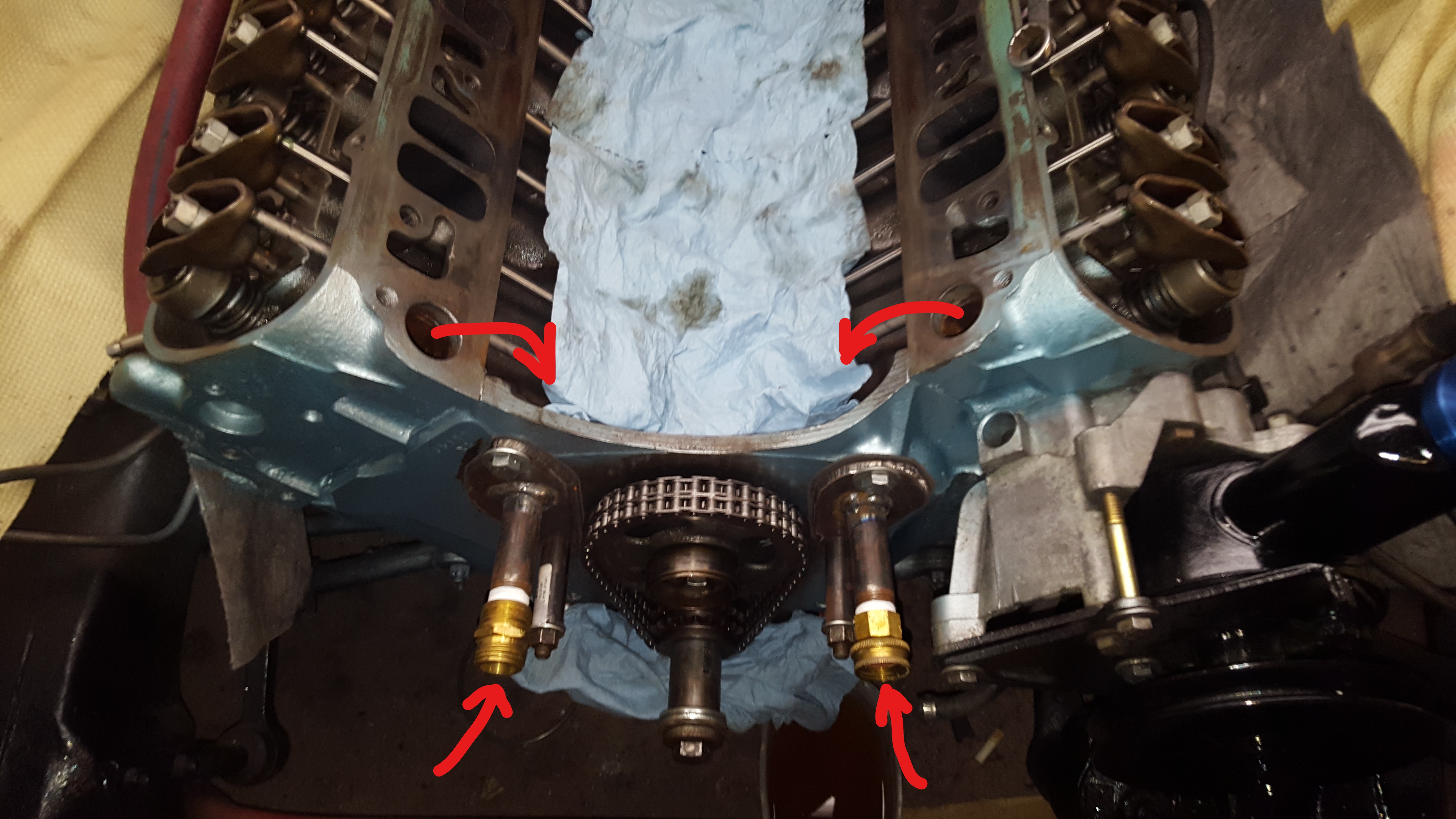

I've fabricated a couple fittings for a hose connections at the front (see arrows on drawing) and was thinking of either, attaching the intake  or fabbing up some fittings for the heads.

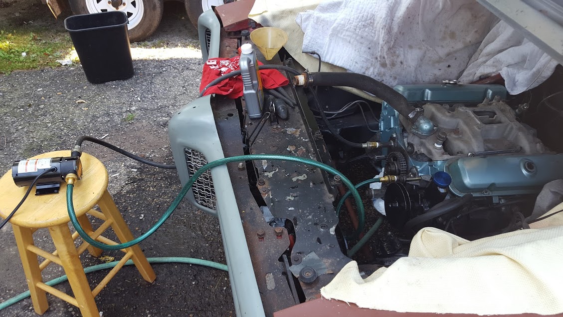

With this setup I feel that I could power flush with an air pressure/water combo and maybe even use a pump to circulate a rust removal  product throughout the block to loosen the crap up further.
Does anybody see a problem or any issues with this contraption?  I'm sure I wont get all of the crap out but I feel any little bit would help.
P.S. I've got the heater hose nipple plugged at the block.
Quite frankly I am interested to see how this works out for you.  Be careful on your water/air pressure. You don't want to blow out your freeze plugs with too high a pressure.
The only other caution I would have is to make sure that you don't get any water into any of the oil passages or crankcase. I'd also suggest you be prepared to change the oil after you 've done this and let it settle down for a little while so everything can drain down. Putting your intake manifold back on will definitely minimize this possibility but I would still plan to change the oil anyway as a precaution.
Justa me, but I would put the intake back on to minimize water getting into your engine. (still change oil after, as Frosty suggested) Also remember that you need to go in the reverse direction of normal water flow.  Lime scale and debris will form in ridges of the direction of the water flow. Will also hold rust and crap in the ridges.  Backflushing will work on the ridges and help remove the buildup in between.  You can pull the radiator and try cleaning the same way. Reverse direction.  That only leaves the heater core and what you wanna try to clean that. (heater core is the weakest link in the system...be gentle ) You know that has to be full of crap too.  If you don't clean the entire system it will Justa re infect the old wounds.  Good luck.

thanks for all your advice guys, i did wind up using an old Al. manifold however it did leak a bit but was able to flush the system both directions plus  recirculated some Gunk Rust treatment thru the block for a few hours. The water was rusty at first but after more flushing it came out clean!  Next up to remove any water that may have got into the oil passages and oil pan. I flushed the heater core with hot water as well and it too came out clear. And Radiator is next So I think I'm ready to move on.
