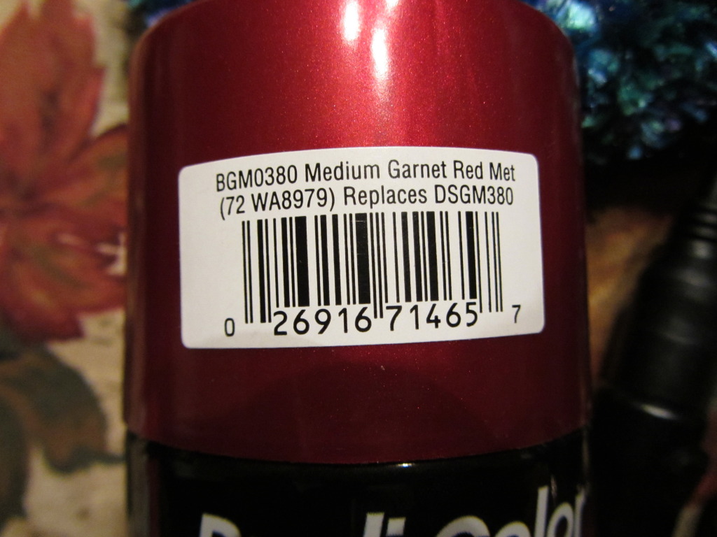

i figured just a pic of the label would be the best
That's helpful. What year is your car? I can then look this up in the proper OEM/year/make/model paint product catalog.
mine is and 07 but it's black exterior i just liked this red
Hmmm....ok so do you know if this is a stock factory color? Looks like this is a can of Dupli-color.
It is a can of duplicolor its a gm perfect match
