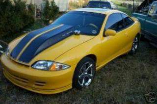

That looks pretty good, seems like the hood and fenders were just stretched which shouldn't be too bad!
