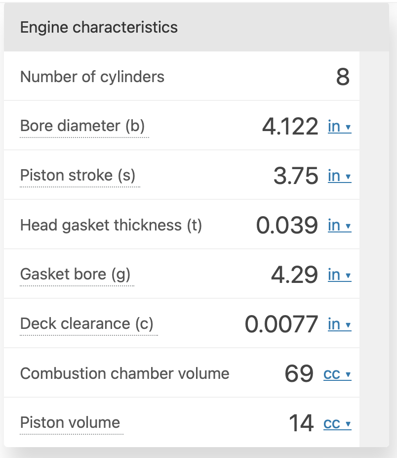

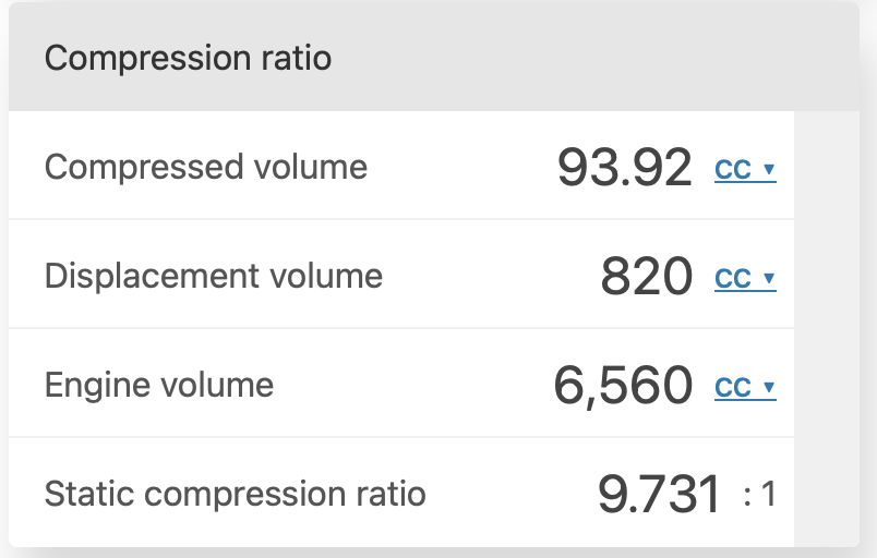

The original 389, cross-referencing all the numbers ('60 heads, '59 block), seems to sit at 303HP/425ft/lb @ 10.25:1 CR. Quoted cylinder head volume of 69cc. Fitted with original Carter AFB.
It's been bored + .060", fitted with forged 14cc dished pistons. Bore size 4.122" (not standard 400). Now running a Melling "068" 285/298 212/225 115 Hyd W/.408 lift Cam, with standard Butler hydraulic lifters,  Edelbrock Performer 600cfm carb.
So, using all the attached data (see photos) I've calculated the new static CR at 9.73:1.
Assuming this is true, approximately what HP and torque should I be expecting now?

You didn't mention exhaust, which can kill HP. However, I will assume you have stock log style exhaust manifolds.
I would believe that this engine could make 380-425 HP at the crank. Assume 25% parasitic loss at the wheels due to the transmission and diff. I would wager 425-475 lb-ft of torque at the crank as well.
Since the purpose of the dyno is tuning the car to max performance, we will never know.  Take a baseline, adjust carb, timing until max results are attained.  Thinkin Frosty is being a lil generous on HP.  I would guesstimate round 375hp tops and somewhere within Frosty's torque range with a mild cam and carb changes.  Justa my :my2cents:  glad she's ready for some street/show action. We want pic's.  Congrat's.  Both of mine are down right now.  Seeing so many rides out showin off N havin fun.

With all the accessories in place...generator..waterpump..power steering pump..etc.. With the 600 CFM carburetor...Log style exhaust manifolds...(fully dressed and wet) With your combination of parts...Realistically The engine will probably put out slightly less than 1 horsepower per Cubic of Displacement...Or around 355/360 (net) Horsepower...@ 5000/5500 RPMs...With 420/425 ftlbs of torque @ around 3400 RPMs...And a good Solid 300 maybe slightly more Horsepower at the wheels...

Well thank you for that information, kind sir. That'll do me...It seems most are around that range, too.
I'm as much interested in how people come to their conclusions, as the numbers themselves.
I believed I had some idea but that was really just a combination of (educated?) guesswork with some data comparison of similar engines.
Thanks again 😃

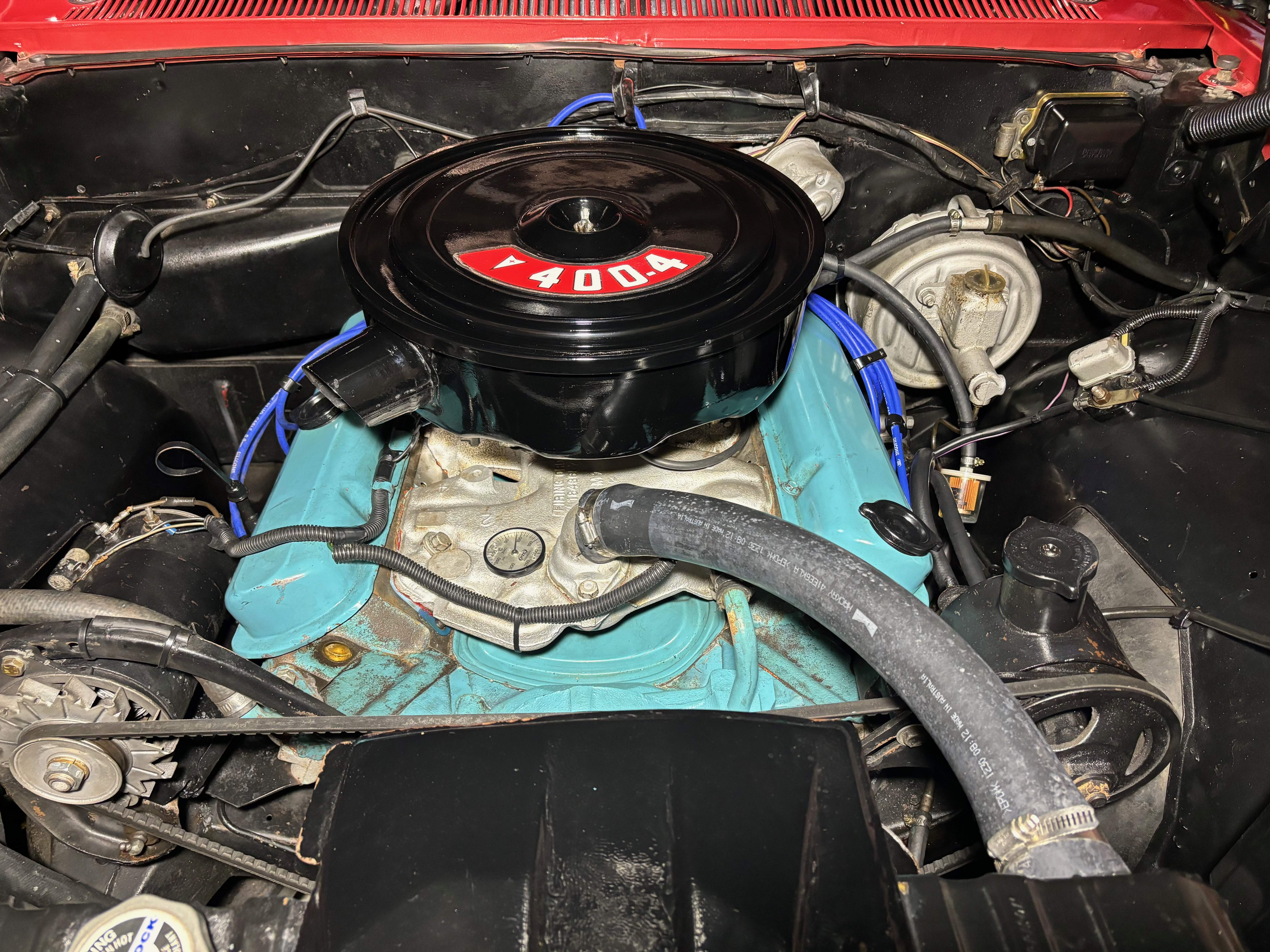

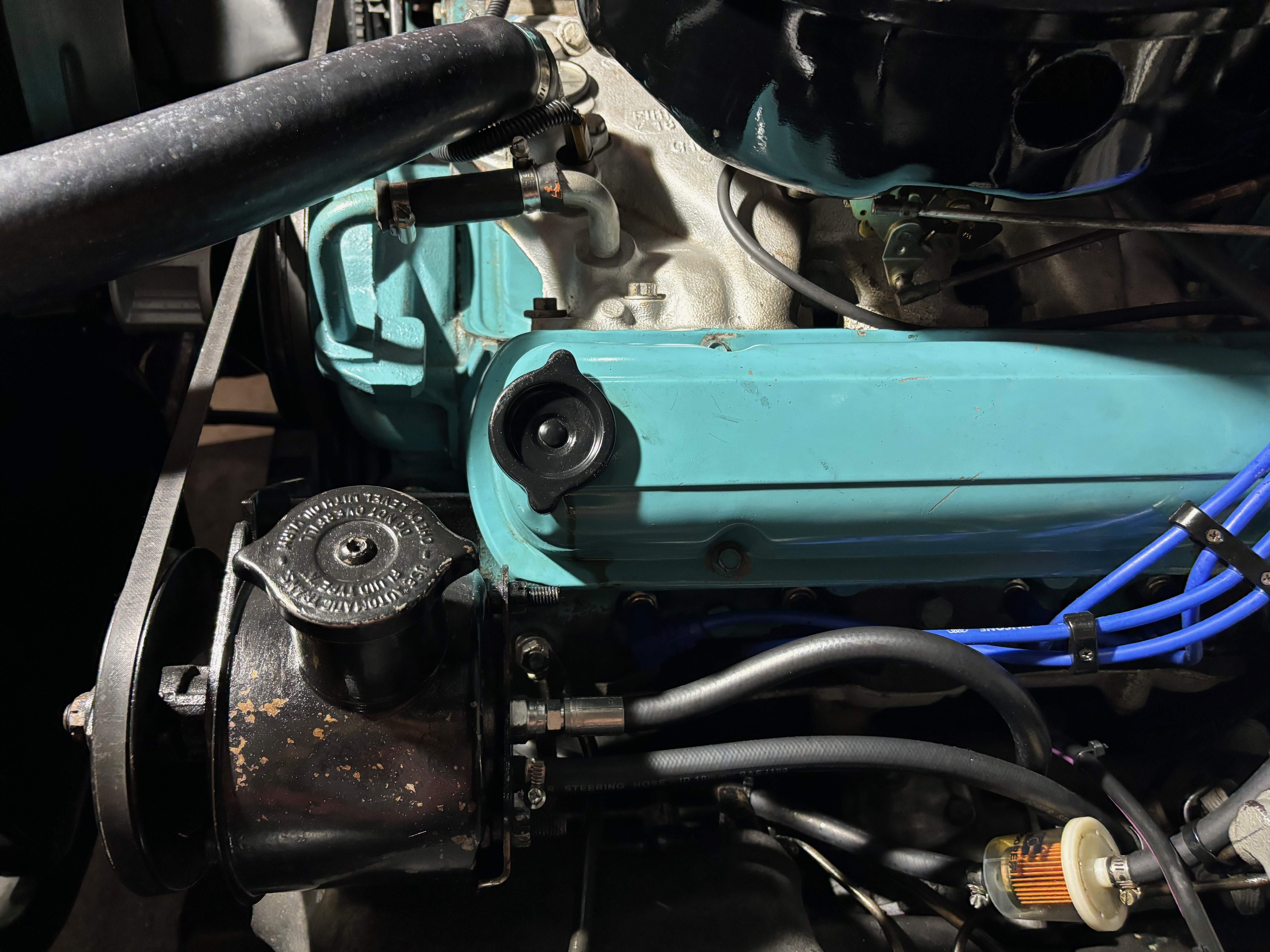

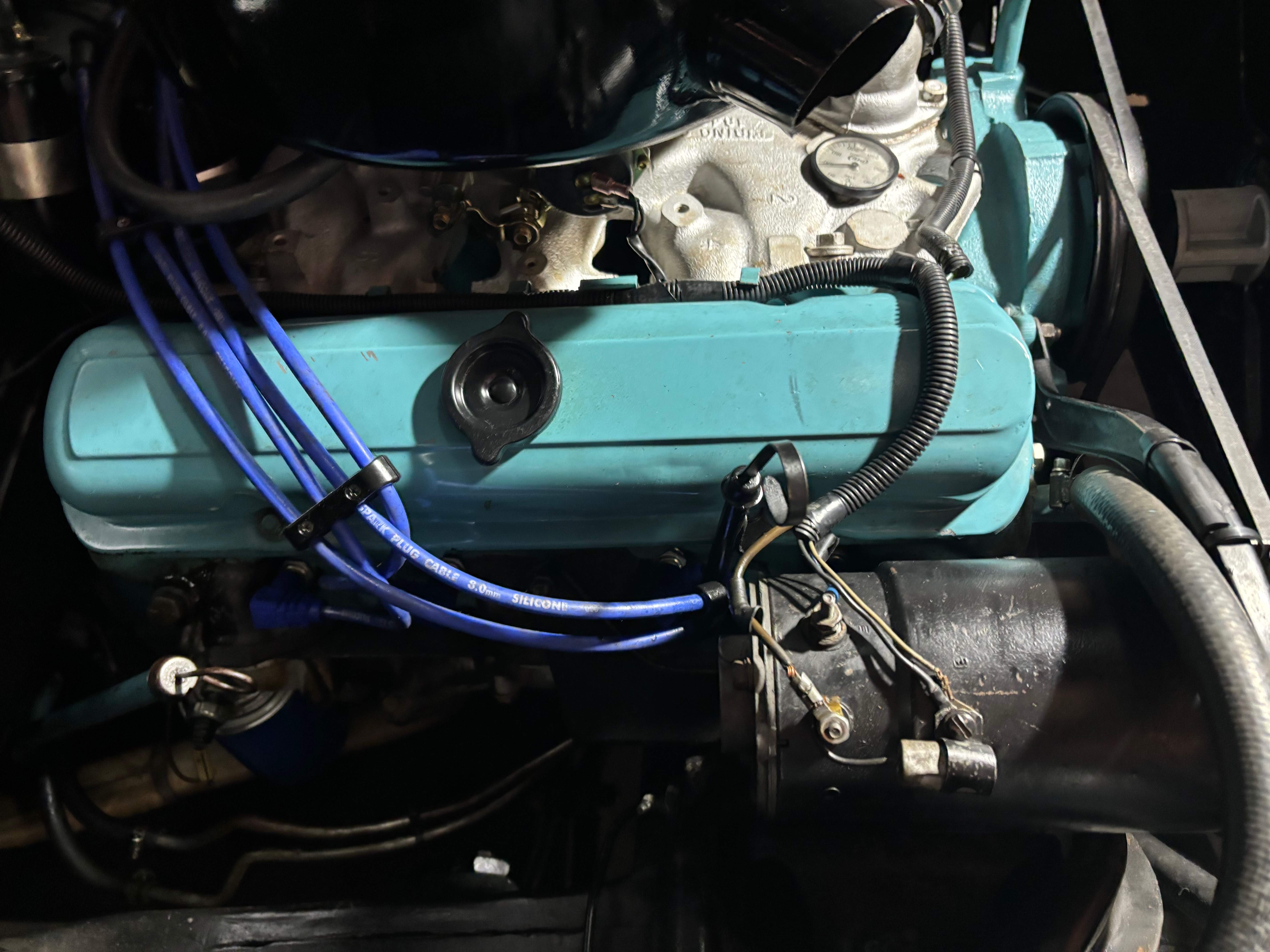

Further to this discussion, I have an issue that's raised it's head that has me stumped🤔
The engine is an early 389, that runs vested filler caps on each rocker cover, and the draft tube at the back of the motor.
Since rebuild, I removed the draft tube (just to tidy things up a bit) and fitted one of those small push in filter elements, so the engine can still vent but it's kinda hidden up under the distributor. It ran like this for 7000 miles, no probs.
Since the heads have been done up, I just can't top engine oil being pushed out through the vented caps, and making a bloody mess (not to mention a fire hazard, as it is coming in contact with the exhaust manifolds) of my engine bay.
The main difference that with the screw in rocker studs installed, the oil is now fed via the pushrods rather than the old hollow rocker studs. This seems to squirt more oil up into the rocker covers.
The motor is running really well so it appears to be nothing more than a nuisance, however it is problematic.
Will I create an issue if I just fit non-vented filler caps, as this seems to be the simplest solution?
you will need to take your covers off Paul and add a good baffel to the under side of the vent holes.
also maybe consider getting rid of the draft tube and add a pcv to vacuum
Yep - what he said. I endured a similar problem, but that was 45000 problems ago.

I've ended up just fitting non vented caps, and the issue seems to have been resolved (without causing any other problems-that I've found yet, anyway 🤷‍♂️). Oh yeah, I painted them black too, for aesthetic purposes 😊
