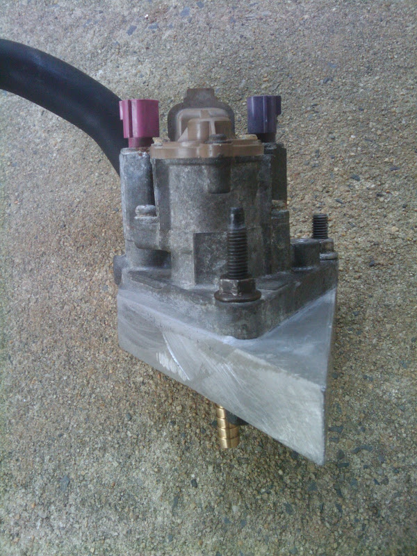

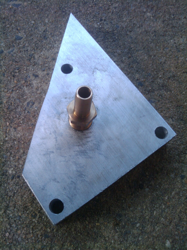

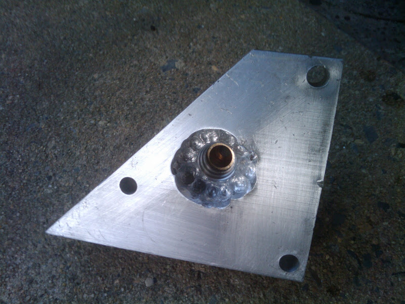

I made a real primitive IAC adapter plate today for about $20-25 total.
Hooked it up and the car started without the use of the throttle for the first time in 4 years.
It's smoother and doesn't have to be babied on decel. Before the rpms would get pretty low if you didn't hold it in gear long enough.
I'm almost embarrassed to post these pics because I spent zero extra time/effort/money. But, that was the plan.
If you're not really sure what's going on: Air goes into that larger tube from after the MAF but before the TB plate (so it's still measured), then through the valve, to the smaller fitting, and then to the upper intake. It bypasses the TB plate to let more air in for starting, cold starts, high electrical loads, A/C on, etc. The engine doesn't have one since it had drive by wire (electric motor moves throttle plate) and I converted it to cable to use the stock wiring harness/pcm. The valve you see originally bolted to the original 3.0 upper intake manifold and therefore has no place on a 3.5.

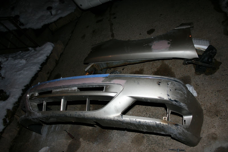

Waiting for the right color bumper and fender to show up seems like it's going to take much longer than I expected since I can hardly find the same color i30 anywhere. So, I decided to grab some different color parts and hand them over to my painter buddy for him to try and match. I'm hoping to spend less than $350 and I know the value of the car will go up by that amount maybe even double.
At the yard today and got a fender, inner fender, washer bottle/pump, and bumper with support and 3 out of 4 fogs for $135.

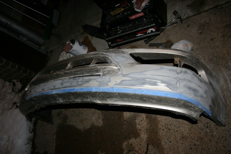

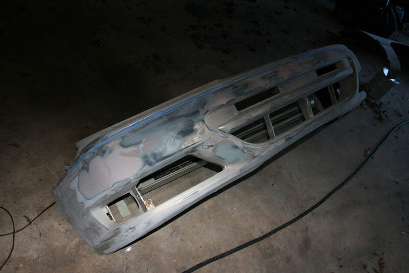

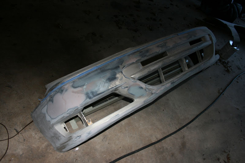

The bumper/fender are on ok shape, especially compared to all the other i30s Pennsburg/Hazelton Harry's had to offer today. The bumper needed a skim coat in a few areas and the fender had a small dent. The bottom corners on these bumpers always seem to get mangled. The drivers side on this one had a dent and being plastic, it's a PITA. So, I c-clamped it back closer to the correct shape and lightly took a torch to it so it would stay that way. lol.. (I need a heat gun) Then threw some kitty hair on top.
That's as far as I could get tonight without breaking out the air tools and pissing the neighbors off.
I sill have to knock down the paint in some areas but I wanted to get the bondo and kitty hair on there so it'll be cured by tomorrow. (cold slows it down)
Tomorrow morning I'll take care of that, block the skim coat, and finish the overall prep.
If I'm lucky I can hard the parts over to my painter buddy tomorrow.

I did some more work on the bumper and fender today but after I wasn't in the sun anymore the filler was taking like 3+ hours to cure. I tried a space heater and a hair drier but it wan't doing sht so I called it quits for today.
If all goes well I'll have the bumper and fender ready to go by the weekend. Thursday and Friday are looking dry so that will help.

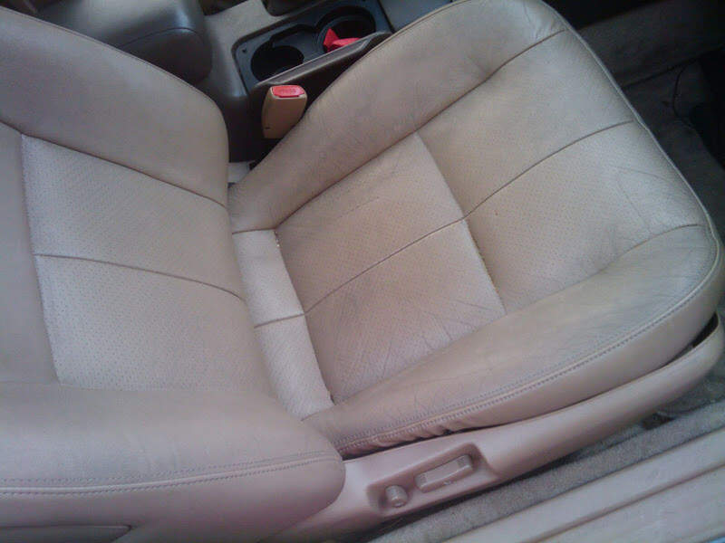

Also going to get some nicer condition 4th gen max tan leather heated seats next saturday morning.
The current ones are pretty beat:
mmmm delcious only thing i hate about leather right there
Today was a good day for the i30. I woke up at 4:30 this morning with roughly 2 hrs of sleep, rolled up past Albany, picked up and installed the newer leather seats. I still have to wire up the heated portion of the seats and install that specific center console. After I got home I picked up the painted bumper and fender and put those on with the new headlights. There are some alignment tweaks to make still, I didn't install the fogs, and it's missing the pin stripe.
