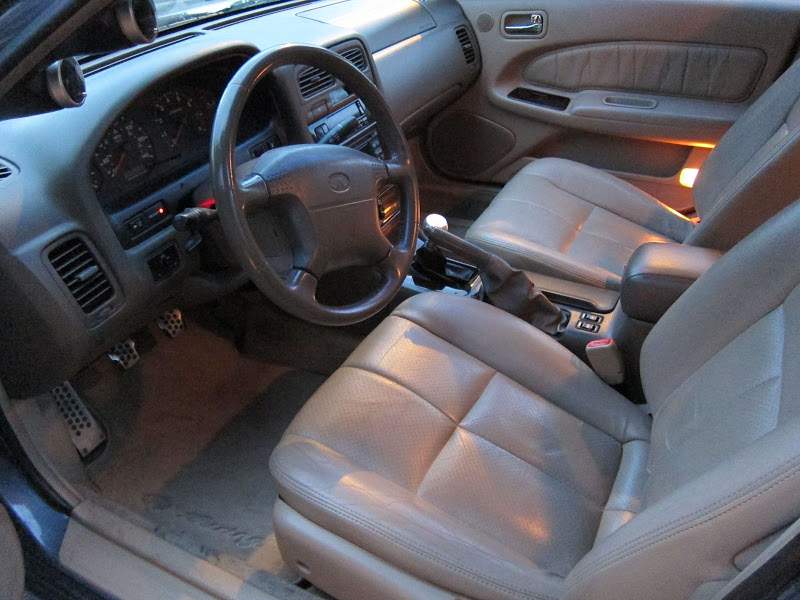

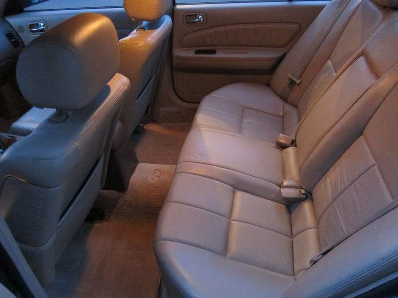

My interior got a little nicer..
Newer stuff: steering wheel, seats and floor mats.
The wheel was pretty bad..

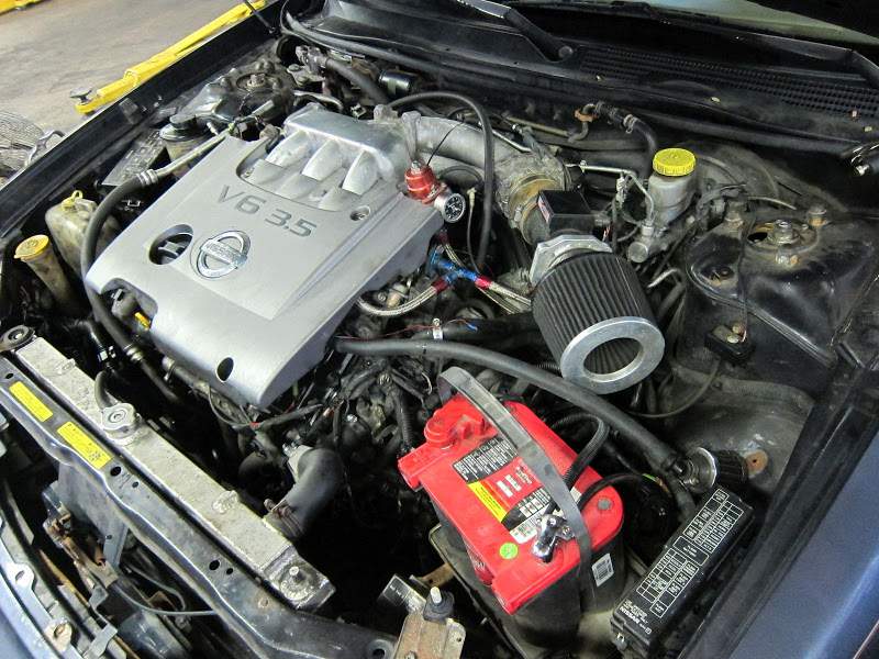

I'm going to pull the engine and fix the oil leaks while I'm installing the new parts.. It makes sense to me since a header install is a 1/3 of the way there anyway..
So, I ordered all the parts for the engine pull.. The rear mains, front bearing seal and crank seal, timing cover o rings, Nissan sealant, new valve covers since the spark plug o rings are integrated, and maybe a couple other things I'm forgetting for the engine.
I also got new front control arms with new bushings/ball joints, and sway bar bushings since it's metal on metal on the one side.

Today the i30 goes under the knife for:
Resealing the timing covers, oil pans, mains, new valve covers (spark plug rubbers are leaking), new front LCAs, FR wheel bearing, coilovers, and full exhaust.
I'll be at my buddies shop for about 3 hours today and all day tomorrow. I hope to get it all done by then.. I will have help so we'll see.

I didn't get quite as far as I had planned Saturday. We spent probably an hour or two checking and re-checking the timing and I started to loose steam after we ate some good vietnamese food.. So, I'll be taking a 'sick day' tomorrow and wrapping it all up.
We did get the engine back in right before they closed up shop. So the brunt of the work is finished.. Cleaning the timing covers suckkkked.

Almost got done today..
The rear main was a complete pita and impossible to do until I took the dowl pins out of the block.
Got that figured out,
Axle seals
Trans went in
New LCAs with new bushings/ball joints, endlinks and sway bar bushings (outer/inner tie rods looked good)
Did the p/s wheel bearing with this.
Axles (need a new drivers side, might get that tomorrow)
Then the JICs all around
And finally the full exhaust
Insert misc necessary b.s. in between each step
Other than the possible d/s axle, intake mani, and fluids I'm pretty much done. Since I'm taking another full day off, I'm hoping to get it on the rack.
Started it up around 9:30 this morning.. The nightmare is over.. just waiting to get on the rack.
It's wayyyyy quiet, smooth, and leak free now.
I did get that drivers side axle in and did align it..
I'm flat out exhausted. But, I am happy the thing starts right up like a new car, the exhaust has a very nice mellow tone, it rides good, and all those little suspension squeeks are GONE. It's like driving a completely different car. I'm also kinda siked that I did all that, albeit with help, in less time than the suggested book time for just the engine removal and re-seal. That's a nice little notch on my belt.

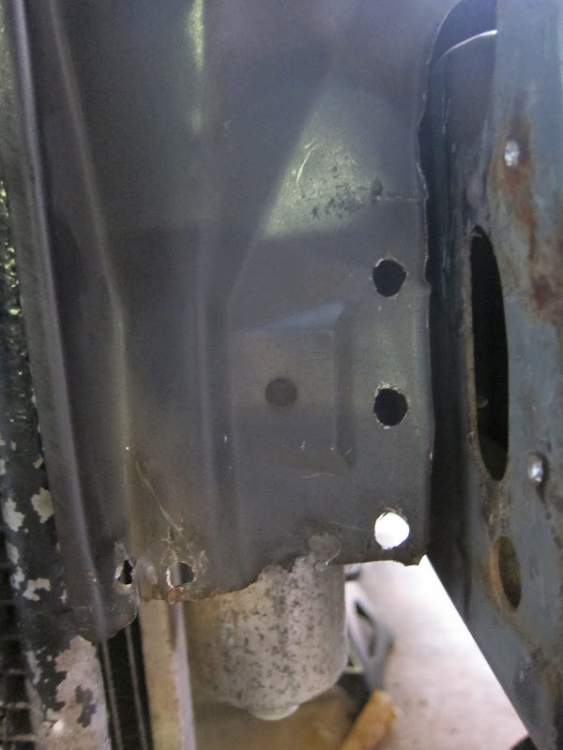

I replaced the lower rad support since mine finally took a dump.
This involves drilling out 50+ spot welds and welding the new part back in. Add to that my front end being mangled a couple different ways and it gets interesting.. I had to use a 10lb slide hammer, mini sledge, various pliers, and clamps to make it all line back up. After I got it in and welded I por-15'd all affected areas.
The alignment is pretty decent. A lot of the damage associated with the bumper and rad support was fixed. The fog brackets need adjusting as well asthe driver side bumper support could. But, at least the front end is one piece again.
Other new parts: bumper support, support brackets, hood struts, and cross member bolts.
