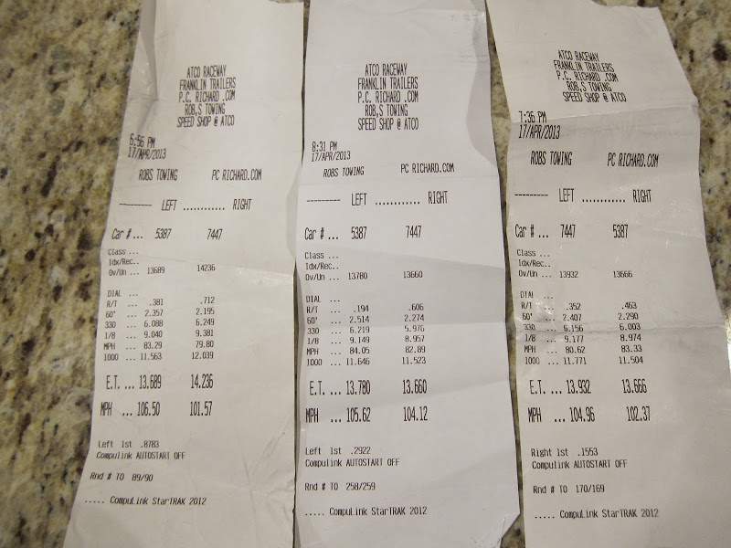

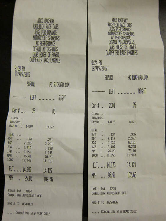

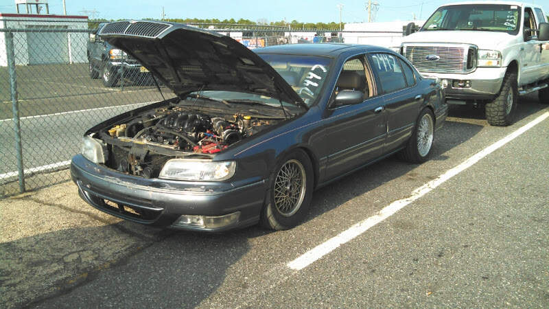

So.. I went to the track for the first time ever tonight. The first time down I think I did a 2.7 60' and a 14.7. LOL.
Track prep was:
Removed throw carpets, spare, jack
Aired down the fronts to 25 psi
I ended up getting this little bugger to run 14.1 with a 2.3 60'.
Not too bad for a first time out.
It was wayyyy hard to get traction and the car wheel hops like crazy.

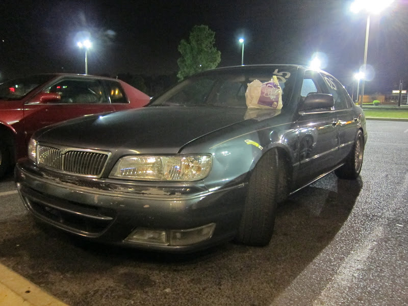

Got a little taco bell acton in Jerz on the way back.

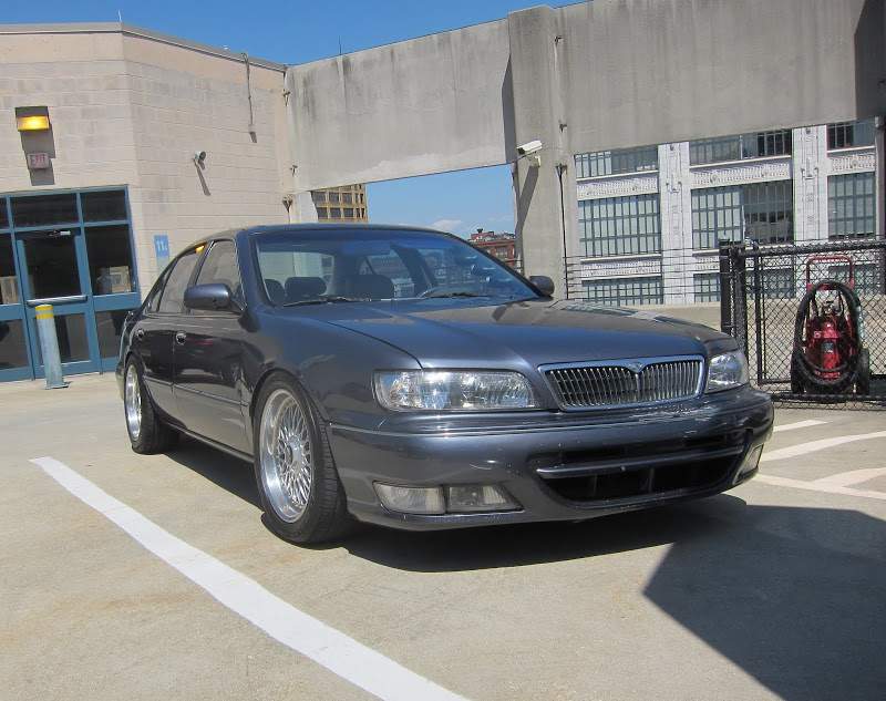

The exterior is beat but it's pretty fun to drive.
The short list of things done since the last post is:

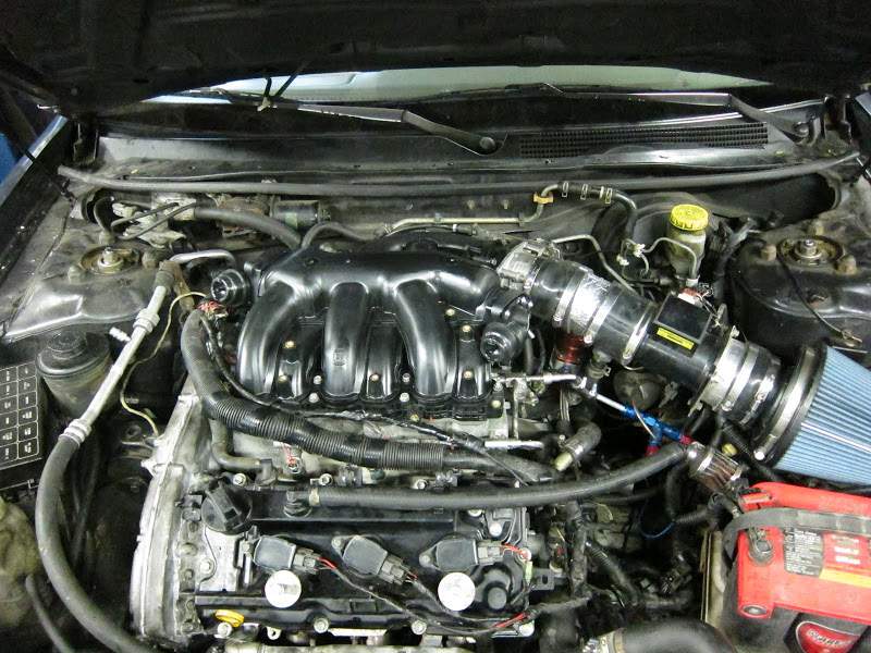

08 Altima VQ35 (has HR heads) with 3.0 timing.. had to drill/set the static cam timing, 09 Max upper intake and TB (bigger than the Alti's), homemade 3" SS exhaust y-back, E-manage Ultimate, and 18" Style 5's redrilled and BMW logos replaced with BBS centers.
It managed a 13.6 @ 104 with a weak 2.27 60'. This, with a rough tune and the variable intake not hooked up.
Your beater is faster then your real car.... But I love it. Exhaust clip? sleeper for sure.
The more I see it the more I love it. The VQs sound SOOOO sexy.

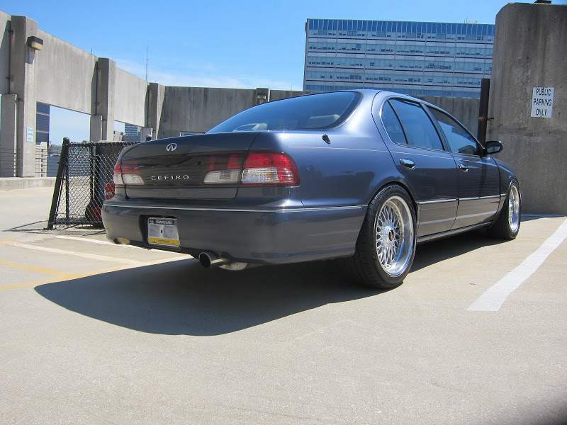

Also, rocking the Cefiro center piece on the trunk, awesome. Swap the Infiniti badges for Nissan ones and people will really be confused. :lol:

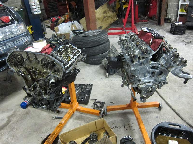

I didn't mention.. The reason for the newer 3.5 VQ was because I hit a huge pot hole with cut trolley track in the middle that ripped my lower oil pan clean off an broke the oil pick up tube off the oil pump casting.. The engine had to come out to replace the oil pump and it was a gamble that debris didn't get to the bearings.. So, I said F-it and bought the newer VQ35HR-headed Altima engine.. 2 people had completed the swap before but never shared any info on it. So, I had to figure out all the differences from a typical 3.5 swap and make it work.. The hardest part was comparing cam timing/specs of similar VQs, choosing what static intake cam timing I wanted, and drilling new dowel holes to set it. I would have to assume others that did this swap didn't do this and just left the cam timing as is because it looks close. I found it to be off 14 cam or 28 crank degrees..

Thanks guys!
I would imagine the Cefiro's grille is similar shaped the the i30's, right?
As for the airbag cover...I'd see if a Maxima cover would fit.
Just my thoughts.
Added: the car sounds wonderful. <3

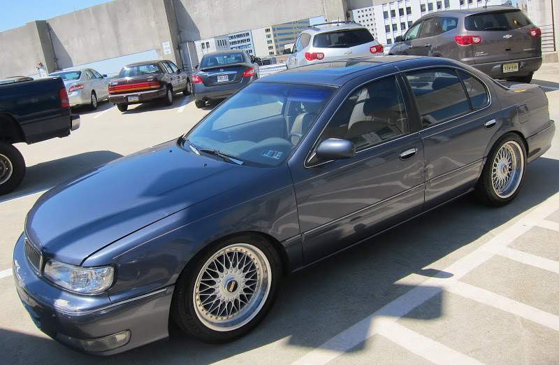

Yeah, most definitely the grills swap over as do the steering wheel air bag covers. But for the interior, it's the airbag seats, floor mats, and door sills too.
The rear tail center garnish was a impulse buy sparked from seeing them in Japan. If the car was in better shape I would source Cefiro Brougham parts and go that route. But, with all the front end mis alignments, I would have to drill out probably over 100 spot welds, get it on a frame machine, re-do the lower rad support plus do a new upper. This keeps me from doing much to the exterior or cleaning up the bay.
I'm cool with it being a low 13s capable beater that gets 30 mpg on the highway and doesn't look terrible. The Cefiro headlights and tail give just enough WTF factor for me.
