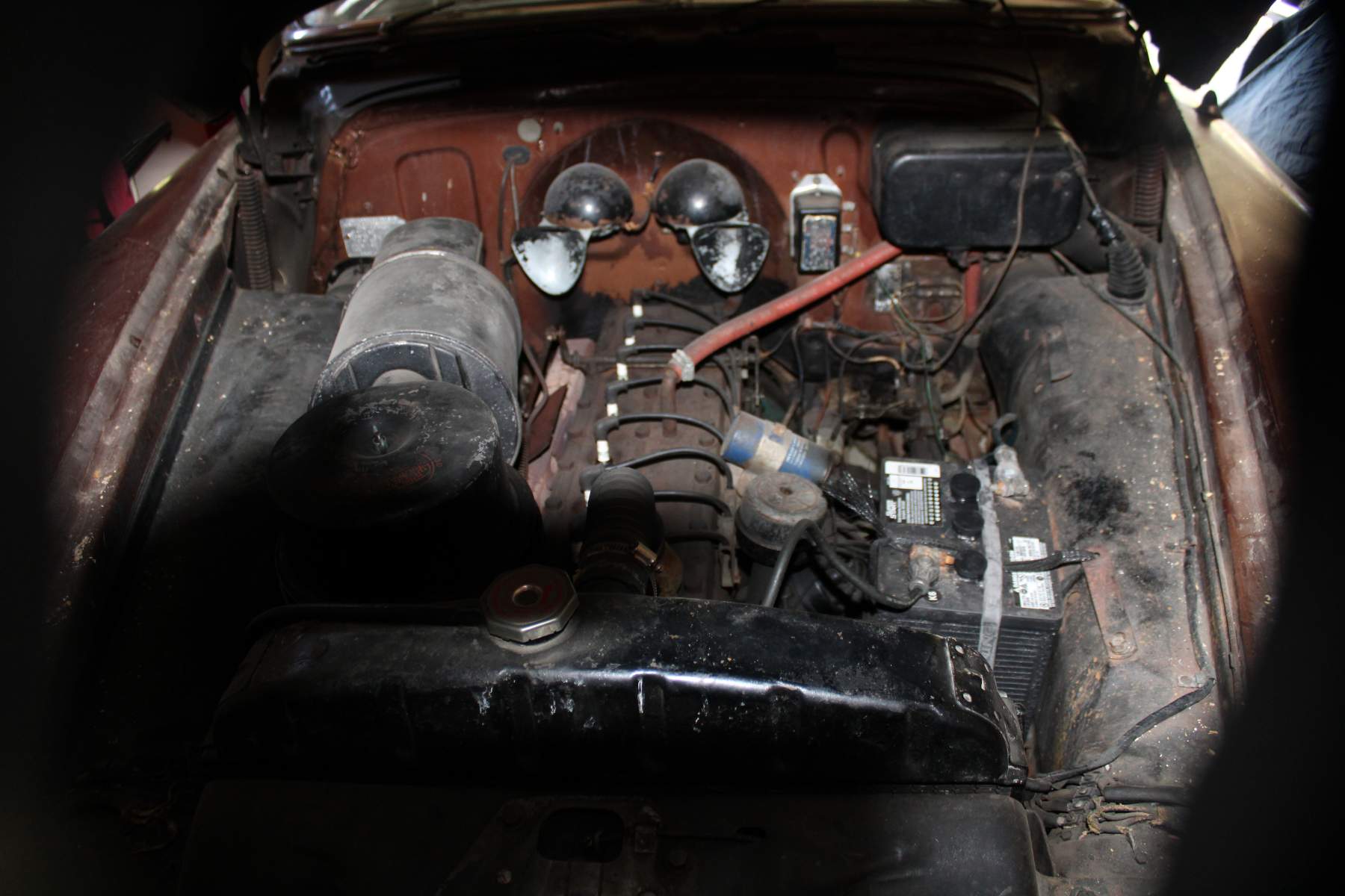

Can you post some engine pics..??
Yes, it still has the original flat head inline 8 cylinder.  I am working on learning how to post pictures and will get them on this thread as soon as possible.

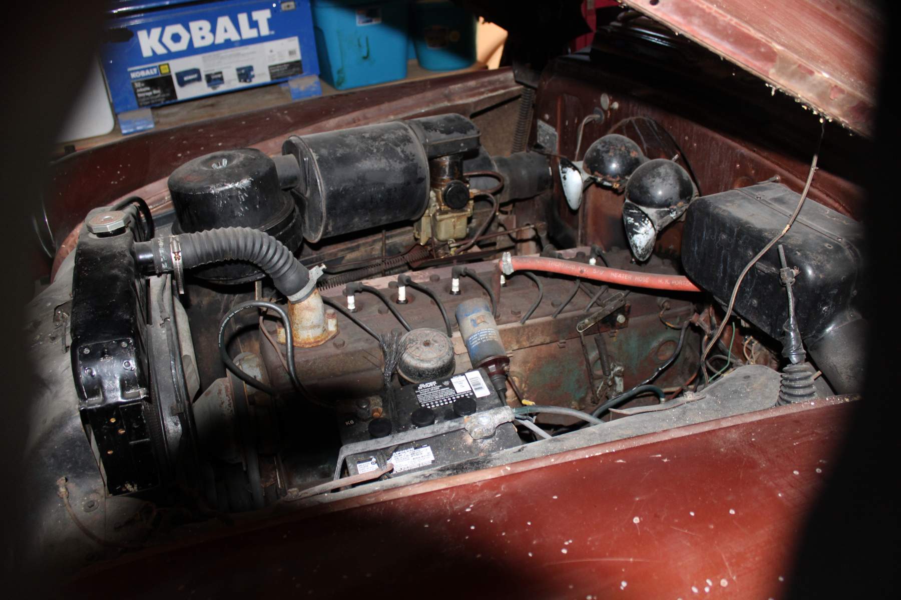

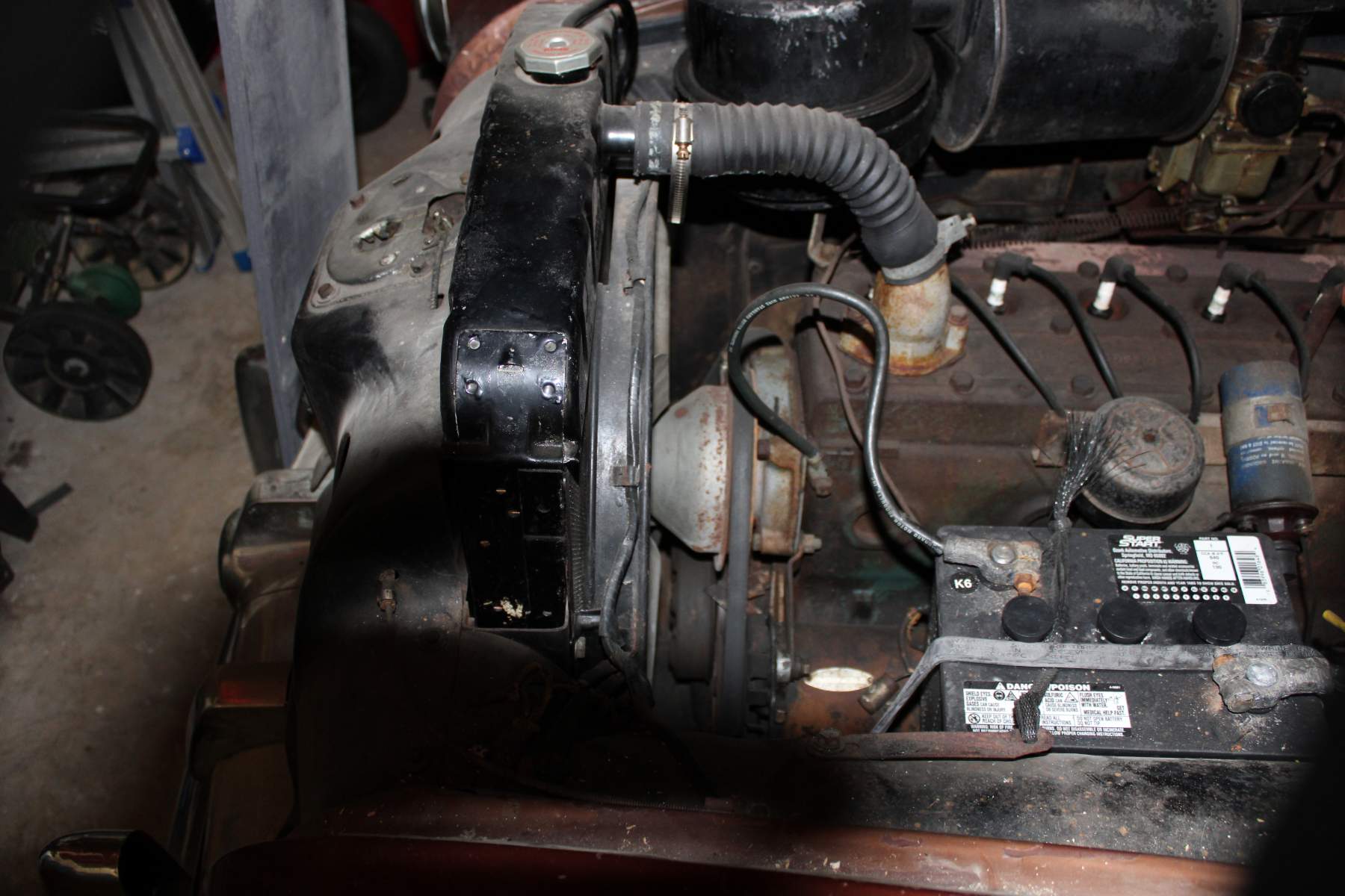

Here are some pictures of the engine.  Pictures of the car can be found under Hello from Cypress TX in New Member Introductions.

Hi Safetyart - you should be running a 268 CID flathead 8 running a Carter WCD 719/720 carb. That is what was stock for 1950.
