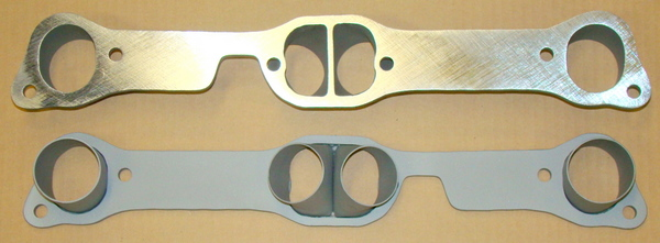

does anyone have a template for header plates, that they can share with me ?
 my plan is if i can get a template, i can take it to my engineer mate with his water lazer, and cut a pair of header plates and i will start from there .👍:cheers:

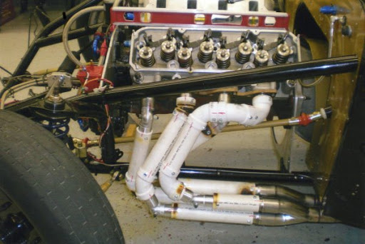

I’m sure you know this, but JustA in case! Tube configuration and length are pretty critical in headers! So polish up on your math skills! And as a plumber; no pvc, please! :rofl:
Edited by Last Indian
What? There was a sale at Home Depot!! Plus it beats welding!
haha, i was going to use copper !!😜

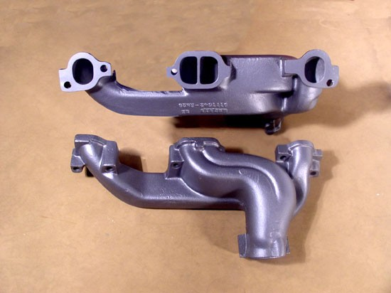

Kiwi -- is this what you are looking for?
http://www.headersbyed.com/__pontiac.htm    Headers by "Ed"
oh now they look sexy!!:cheers:

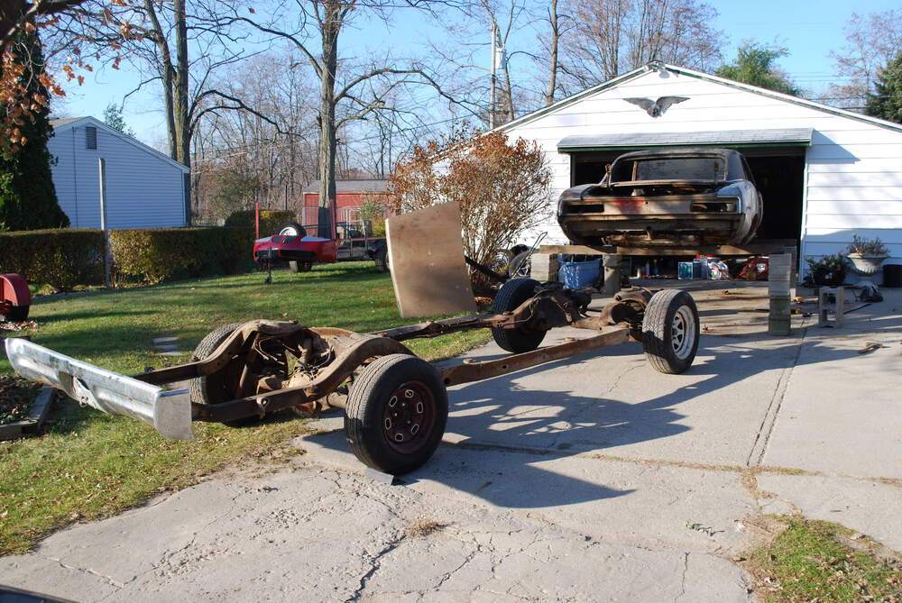

looking at JustA chassis again, it looks so similar to my 64 bonnevillle one, so.... would gto headers fit a bonneville??????🙄
Not likely. The chassis configuration between the full size B-body Bonneville/Catalina and the mid-size A-body Tempest/Lemans/GTO are different. So the location of the steering shaft will be spaced differently. It may work, it may not. I would not chance it though unless it was a hugger/shorty header.
That said, I certain you could run a factory header. Pontiac had a pseudo-factory headers for the H.O./RA IV motors back in the day. Ram Air Restoration Enterprises re-pops these factory headers. I run a set on my Lemans. You can use them with a 2.5" exhaust. They are a little cheaper than the headers from Flowtech too (not including shipping to NZ of course). They look stock and flow way better than the original log style exhaust manifolds.
https://www.ramairrestoration.com/pontiac.html?cat=12

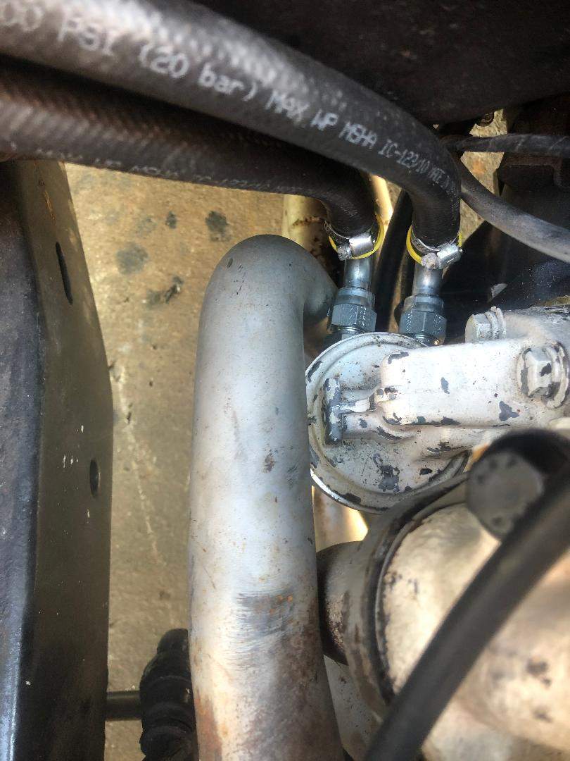

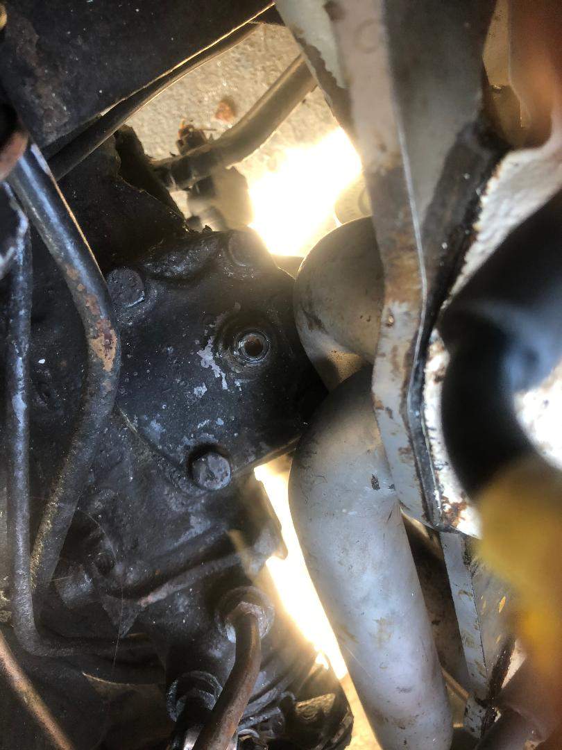

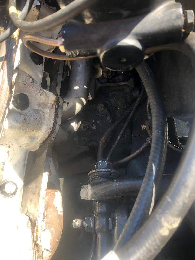

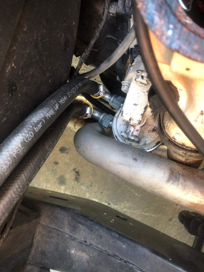

Not sure if this helps or not Kiwi. On my 63 GP I used GTO long tube headers. It was a mistake. I should've found something like the ones sir Frosty posted. I did look but couldn't find what I thought might work. So instead I ordered a set of Hedman from summit. (Pre forever Pontiac days lol) Anyways when I went to install them I had severe clearance issues.  I decided to keep them, fit them, run them until I could find/afford something else that would work. So I ended up dimpling or rather putting a small dent in the headers to fit around my steering box. The spacing around the starter is insanely tight and I'm now running a oil filter relocation kit because the bottom of the oil filter was almost touching a header pipe and the oil filter could not be removed without first removing the header. It would have saved me a ton of work and time if I would have went with shorty's or could've found something to work with my set up.

Nothings touching, now. Just extremely close
Oh shit those 2 ports are on top of the steering box!! and that one over your oil filter aint much better!,
ok, i am flaging the header idea, because your 63 is the same frame/ steering box as my 64  Wrongway:dancingpontiac:

anyone used the cast headers that Frosty posted ??? two lane ??
Frosty, i dont think these will fit a 64 frame,,,, looking at Wrongways headers there isnt much room to that steering box???🙄
Looks like to me that some one at Pontiac  fucked up when it came too those 2 middle ports and the steering box location :o

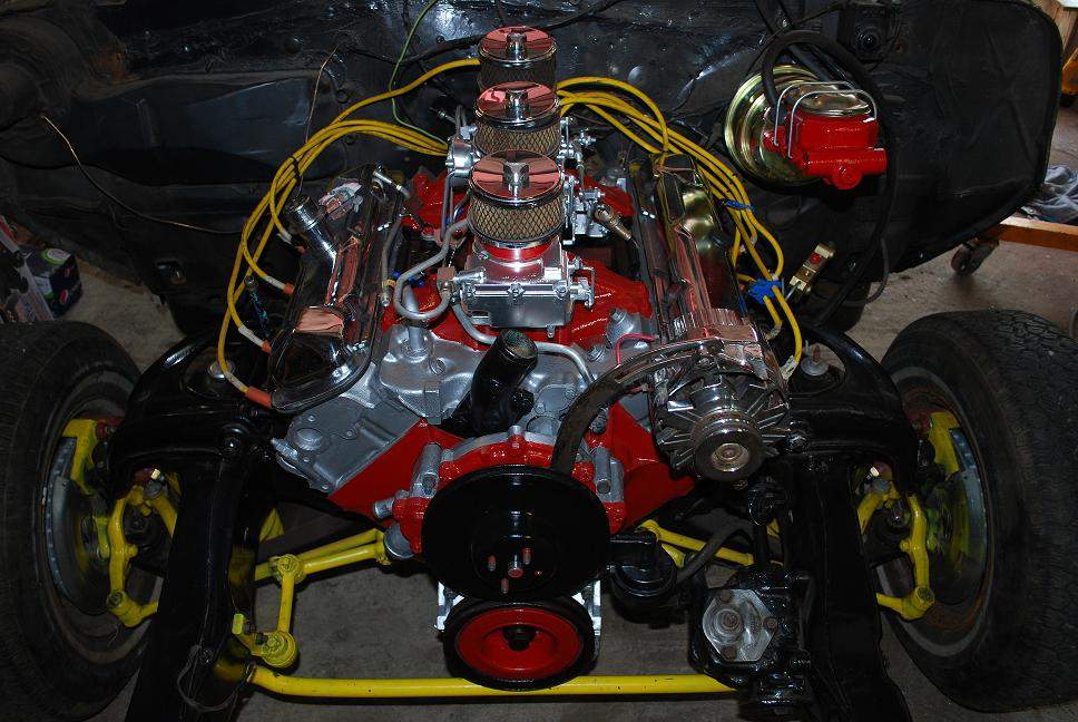

Never noticed your set up.  At best my experience with your ride is checkin one out at a show.  This is the best pic I could find of my GTO setup.  My steering box aluminum lid is in line with pullies.  My rag joint is under #1 exhaust.  Your LID us under the middle 2 exhaust ports and looks like its behind the A arm. Hmmm

Yeah bro, like under my master cylinder. Well if I ever get to drive her up there you can check her out all you want lol.
