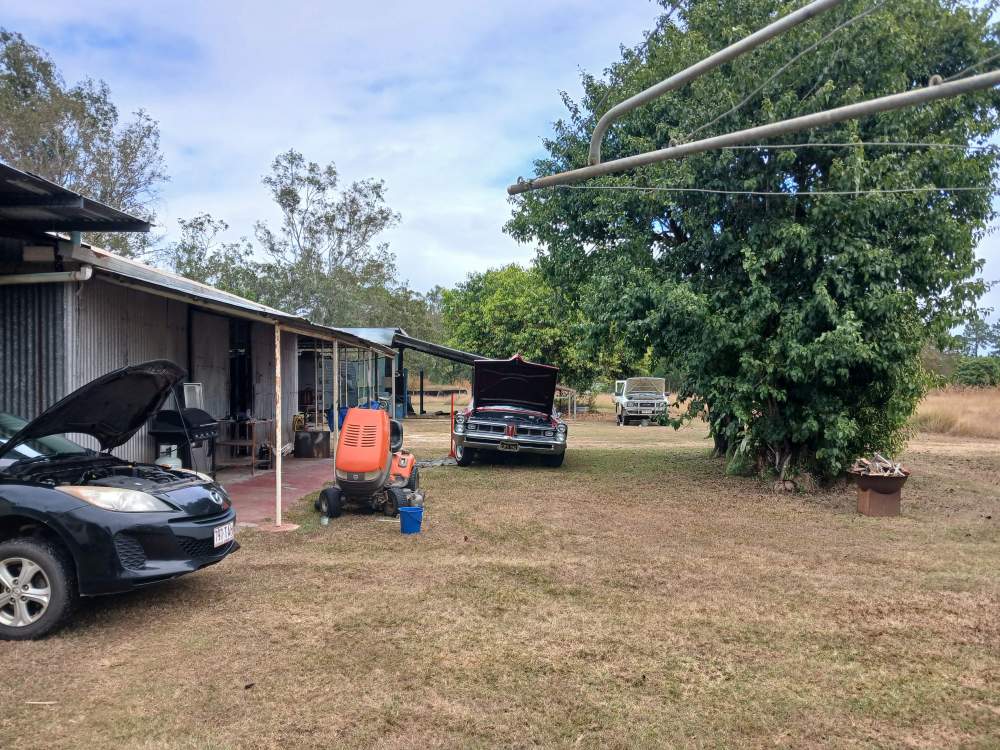

You know...I might be a redneck. The pic looks like a hillbilly meth lab but it's actually my place with me changing everything's oils all at once - a successful & rewarding experience. A mechanic will charge quite a bit to do an oil change, they'll use inferior quality oil bought in bulk and the job will be handed to the apprentice who will drain the old oil and as it's still dripping out will replace the drain plug and get the car finished because he's under the pump. I warmed up each engine (with a drive) and each drain was at least an hour. I use quality synthetic oil only ever bought when it's on special, because I'm a tightarse.

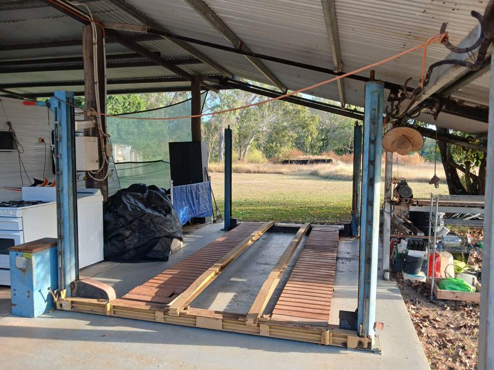

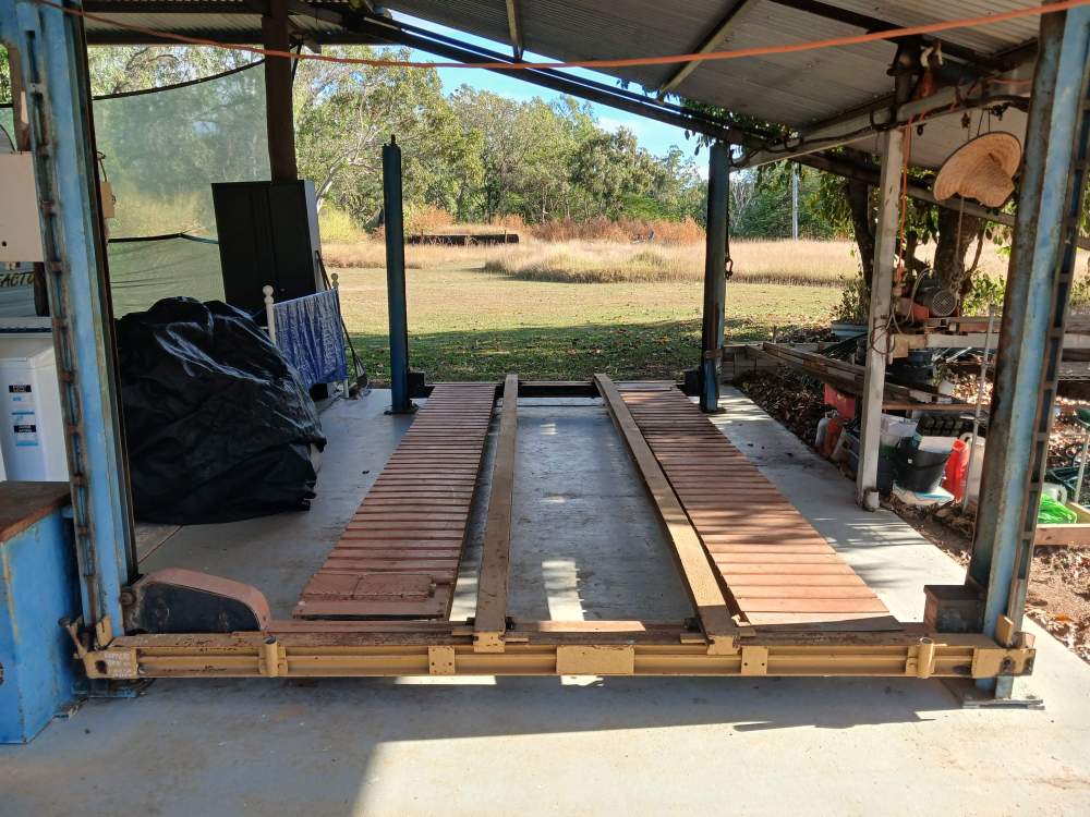

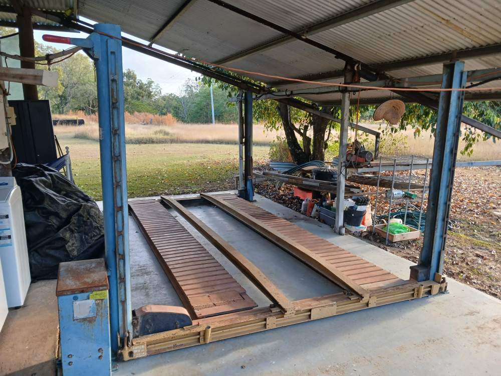

Here is the hoist. It's a UK made Bradbury and despite it's appearance is apparently a quality item. As you can see, it has chassis rails and ramps. I'm getting someone to inspect it soon. The sloping roof is made to slide away, so when I start servicing double decker buses, it won't be a problem.
The old fella was clearly thinking ! Doing a sliding roof works a treat !!!
And having it open like that, lets a lot more natural light around where your working !!!!
That’s the down side of my one , it’s so dark when you are working on it !
I have to have lights set up so I can see !!!!!

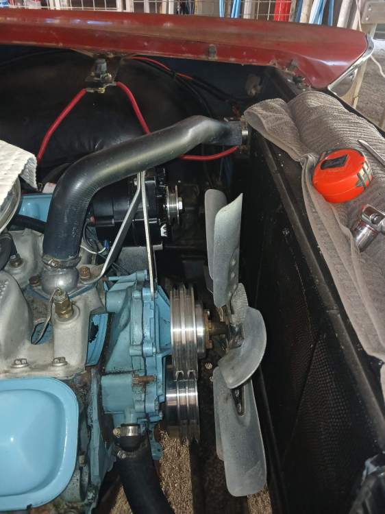

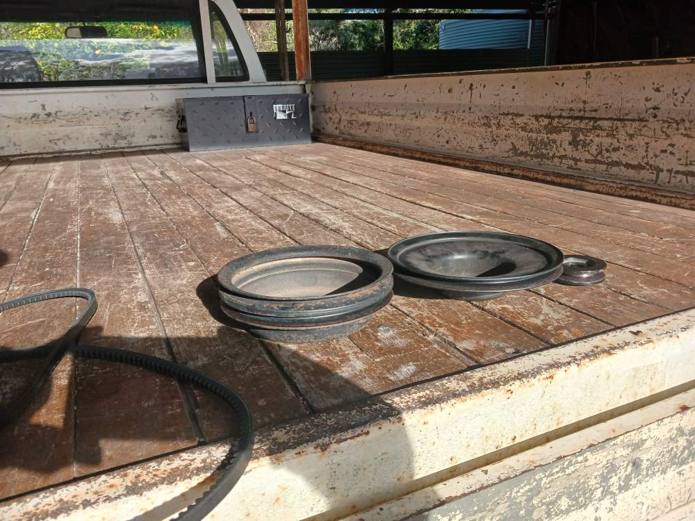

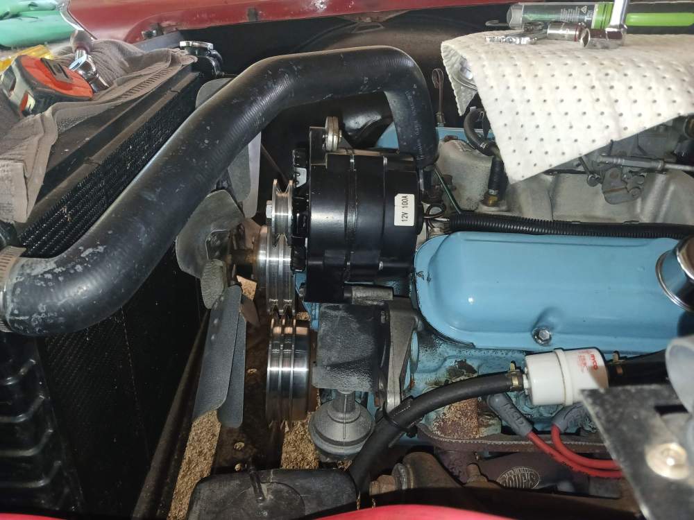

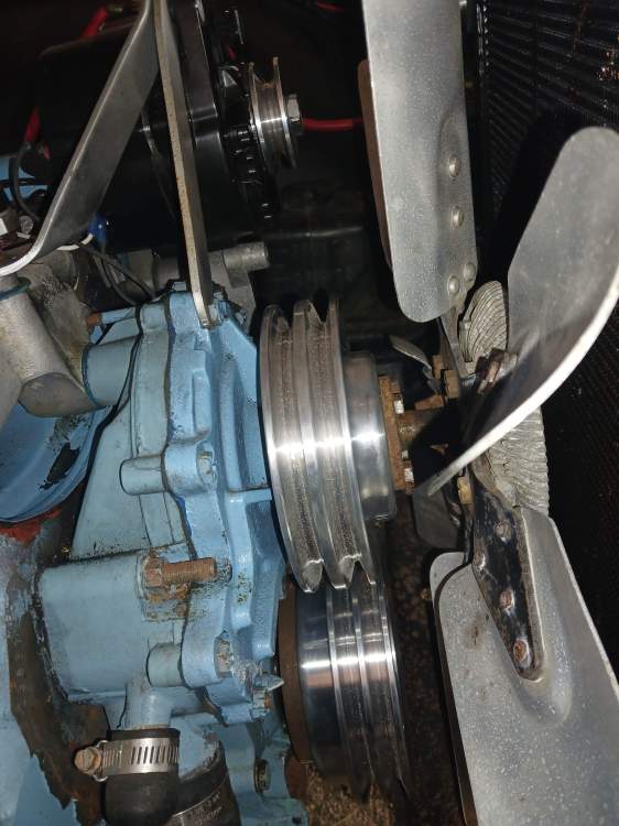

Today I ran out of things to do and my shiny new billet aluminium pulleys were eyeing me off so into the breech I jumped. I thought the alternator pulley was going to be the one to give me the most grief but it came off surprisingly easy - didn't even need the rattle gun. The other two were pretty easy and all of a sudden I had an armful of old Pontiac pulleys. I used a micrometer to measure all widths and they were about the same but the alternator (being the latest addition) just seemed to be of a whole different design AND was slightly narrower than the other two and the crank pulley was slightly wider than the water pump pulley. This is all new to me and I don't know how much wear is permissible but it doesn't matter anymore. See the pic of the fan belts - the top one has worn on the sides which tells me it was sitting too low in the pulley groove hence the summation that the pulleys were worn. Interestingly the new pulleys are of identical diameter to the old ones except for the water pump one which is a little smaller, so if anything the water pump will be shifting even more coolant than before.
With much swearing and threatening to kill anyone who dared to come near me (there was nobody) I finally managed to get the little bolts back in that hold the crank & water pump pulleys in place. Trying to line up 3 things at once with only 2 hands and little room there was much cursing. After the ordeal the old fan belt was waaaay too long so I used an electrical extension cord to give me an approximation of what belt to come home with on Monday. Old one was 11A1285 and I reckon I'll be shaving off a good 90mm with the new one, so a 13A1200 or so should do it.
Beer o'clock indeedly doodly.
Good job!!
They are now the blingiest items in the engine bay and the car's worth should have increased by $5k!
Honestly, the old pulleys look fine but something was causing the fan belt to wear rapidly on the sides. I cannot think of any other reason for that wear.

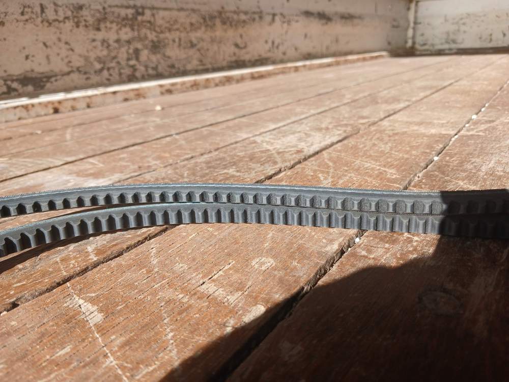

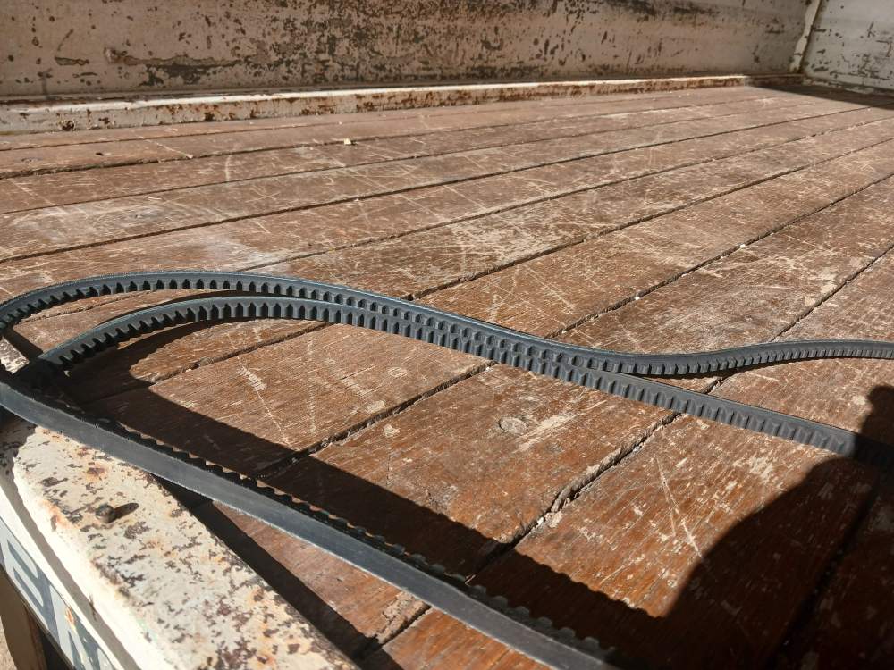

I had to borrow the missus' Mazda to pop into town and procure a Ponti fan belt. Now, fan belts are funny things. When you measure them, well the numbers don't seem to add up. With this in mind, I picked up a 1200 AND a 1220 and told the girl at Repco I'd bring back the one that didn't fit. Remember, I measured the requisite distance required at just under 1200mm but gave myself a few mm to play with on the plus side. Well, neither belt was even close! So, back to the shop and sprung for a 1250. I sheepishly returned to the Madaz and hoped to hell this belt would fit. The damn thing was about 10mm short but I was NOT going back to Repco a third time so I gently eased if onto the smallest pulley with a screwdriver and it's on. It'll stretch a little and I'll be sure to buy a 1260 replacement spare. I didn't take a pic because we've all seen a fan belt before. I hope that's the end of that.
Wise man once said
Chop your old fan belt to the right length and take that to the parts shop
That way you never look like a silly old man who keeps walking in swapping fanny belts rofl
Great advice. Next time I'll know. Obvious now when you think about it.
Now...where are my pants?

I test drove the car with it's shiny new pulleys and nice bigger 13A belt and no more noise. I'll never know what was going on...perhaps the alternator pulley as it didn't even look like the rest. Whatever, it looks a million dollars because that was close to the cost.

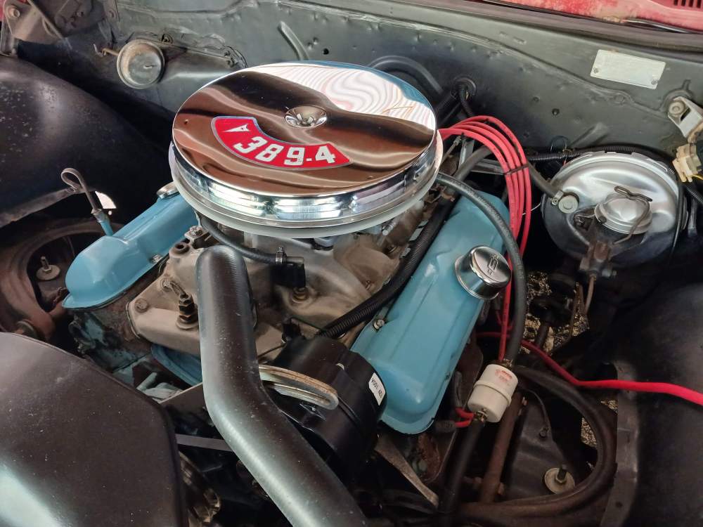

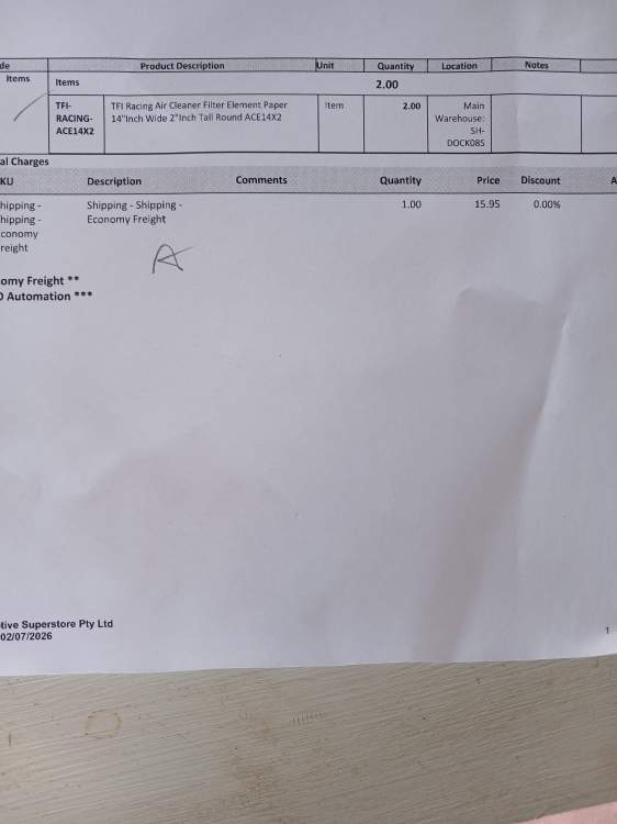

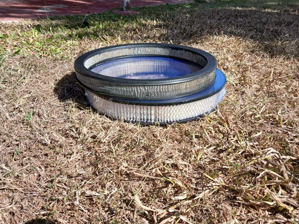

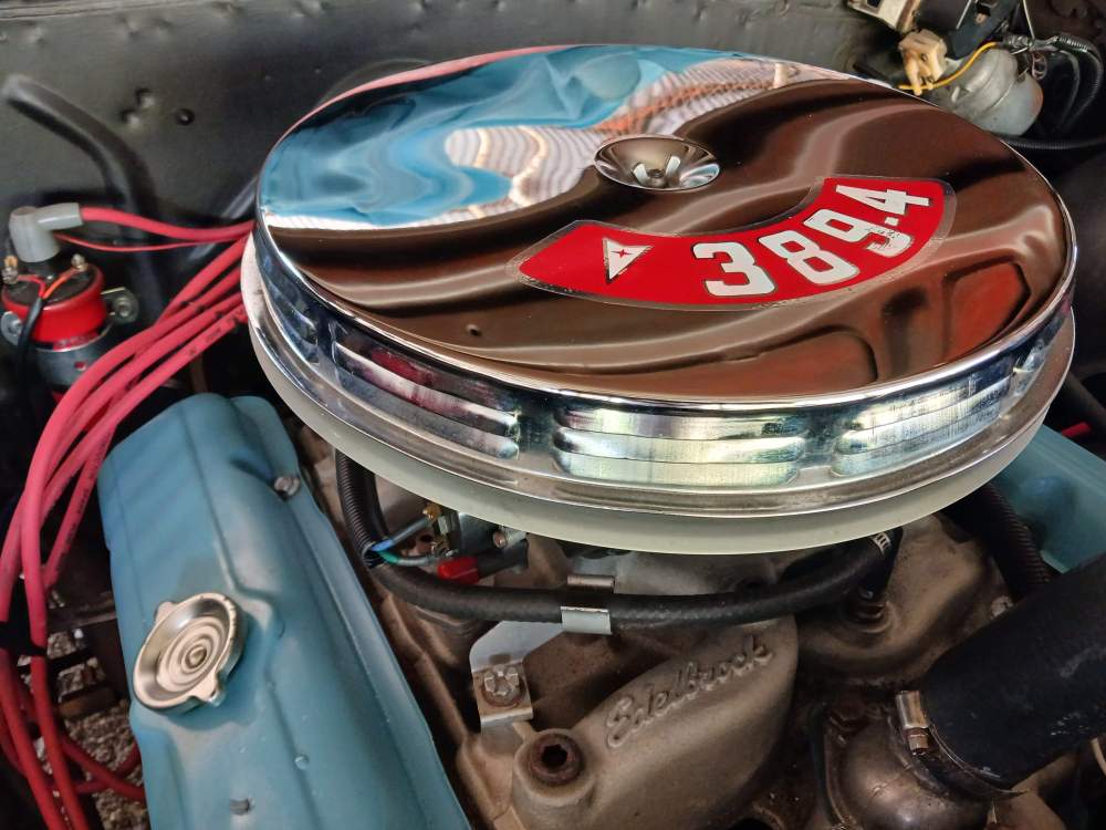

Quite a few months ago I reached out regarding the availability of a replacement air filter for my fancy pancake chrome louvred can. According to all the blurb on various forums they are very hard to come by. I searched high & low using all sorts of wording to try and snare a result. Just by dumb luck, in desperation I entered just it's dimensions and nothing else, so "air cleaner element 14 inches diameter by 1.5 inches high." And that did the trick. All of a sudden the screen was full of images of what was available. Unbelievable. I ordered 2 that were 2" high as they were half the price of the 1.5" ones. The top of the filter can now sits proud of the base by half an inch or so - that'll do nicely. The old filter had been on for years. I'll take her for a spin later this week.

That looks very sparkly - well worth the ridiculous cost ☺️
