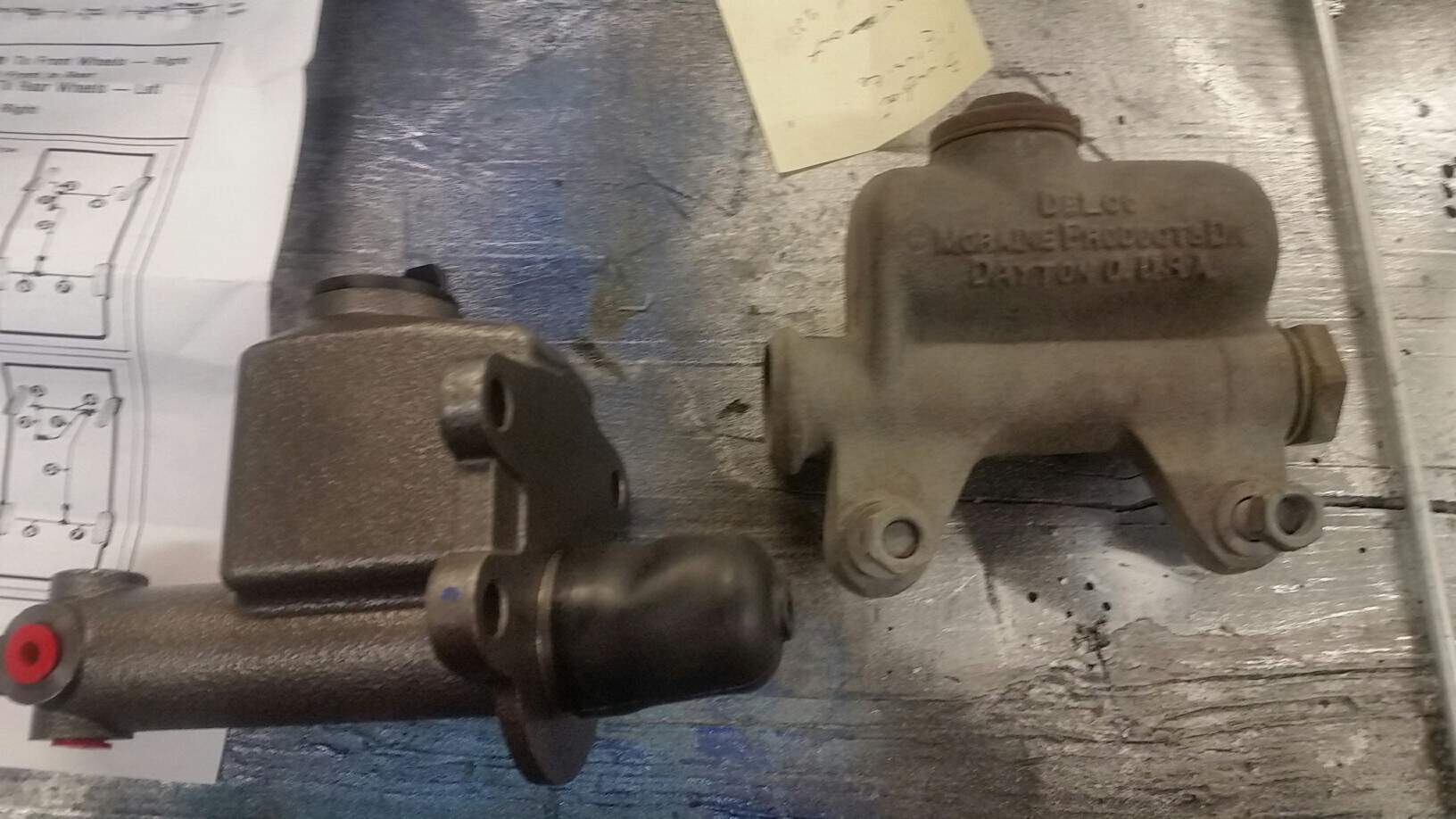

I can find no one that lists the correct master cylinder for my 55 Chieftian.  I have tried ordering 2 that say they have the correct one and both times it's one that mounts to the firewall.  Mine mounts to the frame.  See photo.  Everyone says the one on the left fits.  Mine is the one on the right.  Anyone know where I can buy a new one?

I'm glad you said yours is frame mounted much like the late 40s/early 50s pickups.

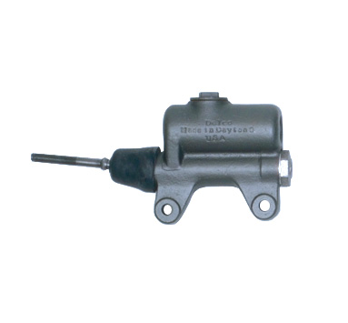

My first thought was to look at Kanter Auto Parts for that style of part. Their photo looks correct. It can't hurt to call them. '55-57 master cylinder  $164

I called California Pontiac Restoration.  They said that they carry the frame mounted MC.  Someone from HAMB said that they had them. THanks.
