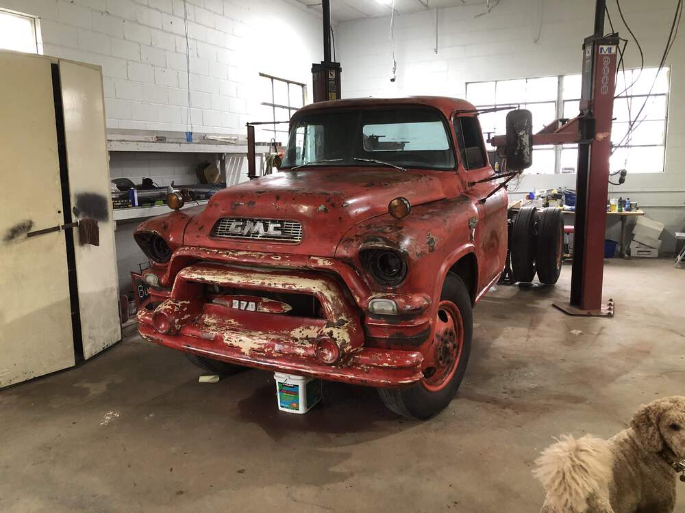

Thanks for the add into the group first. So I have a 1956 gmc truck with a370 c.i. Pontiac engine. I’m interested in putting a 1965 389 ci 4 barrel manifold and carb on it. From my research it seems the 370 and 389 are the same block. My worry is the 9 years separating them and if I’ll run into any problems involving the cooling system. Thanks in advance for any help

So if you are saying you have an original 370 motor, I am suspicious. GMC also used Oldsmobile motors in larger meduim-duty GMC trucks. In '55 and '56 the Rocket 324 was used. For '57-'59 the Olds Rocket 370 was used. Given the photo of your truck and it's dually axle, I suspect you could have an Olds motor.
Can you take some pictures of your engine and post them here please?
Now assuming for the moment your engine is indeed a Pontiac motor from the period, replacing it with a 389 will require you to replace your radiator. That is because the early 50s Pontiac V8s had a reverse flow cooling system, the 389 is not. So coolant ran into the heads and then the block in the early Pontiac V8s. So you will need a radiator to match your 389's water directional flow. Fortunately radiators for the 326-455 family of Pontiac V8s are plentiful.
It has an emblem right in the front 370 and I have a title for it it’s a 1956 GMC one and a half ton truck I know Oldsmobile never made a 370 from my understanding the 370 block was the precursor to the 389 they just bored and stroked it correct me if I’m wrong I don’t know that’s why am on her asking questions thank you for your reply

I agree with Frosty...The truck in the pic looks like it's a 1 ton...(dually)..
The Olds engine used in the GMC heavy truck is a 371 CID engine..4.00 bore × 3.687 stroke...and had some differences from the car engine...Such as hardened valve seats, heavy duty valves..(larger diameter valve stems)...beefier rods...different camshaft.. ETC..To make it more durable for heavy duty truck use...
This same Oldsmobile 371 engine Was branded ( for whatever reason) as a  "370" in larger 1 ton GMC trucks....
The 370 Pontiac engine...4.0625 bore × 3.5625 stroke....I'm pretty sure was  used...Or was it...??? in regular pickup trucks..???? and not in 1 ton trucks....But I'm not 100% sure about that...I would love to see engine pics too.....

Regardless of power train, That is one Killer Looking GMC 👍

I totally agree with Sprint6, it is a killer truck. Mike if you would not mind, can you give me the first six characters of your VIN. That will give me the model and build location of your truck. That should tell me what your truck was built with. The VIN will be on the drivers side door jam.
Two Lane, I don’t know if there ever was a 370 cubic inch Pontiac engine for cars or trucks. So I believe Mike may have an Olds, especially since he says it is a 1 1/2 ton. Pontiac engines I know of were used in light duty pickups.
