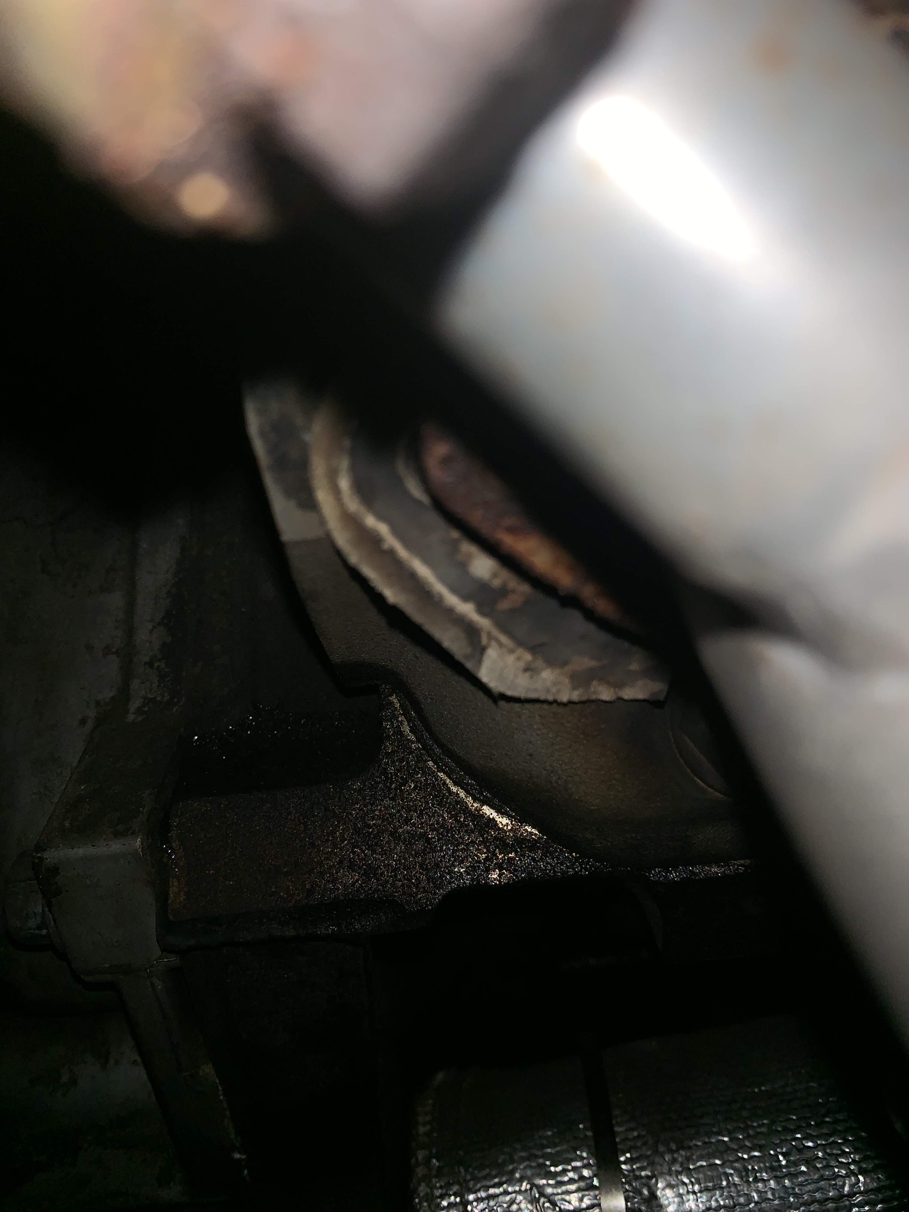

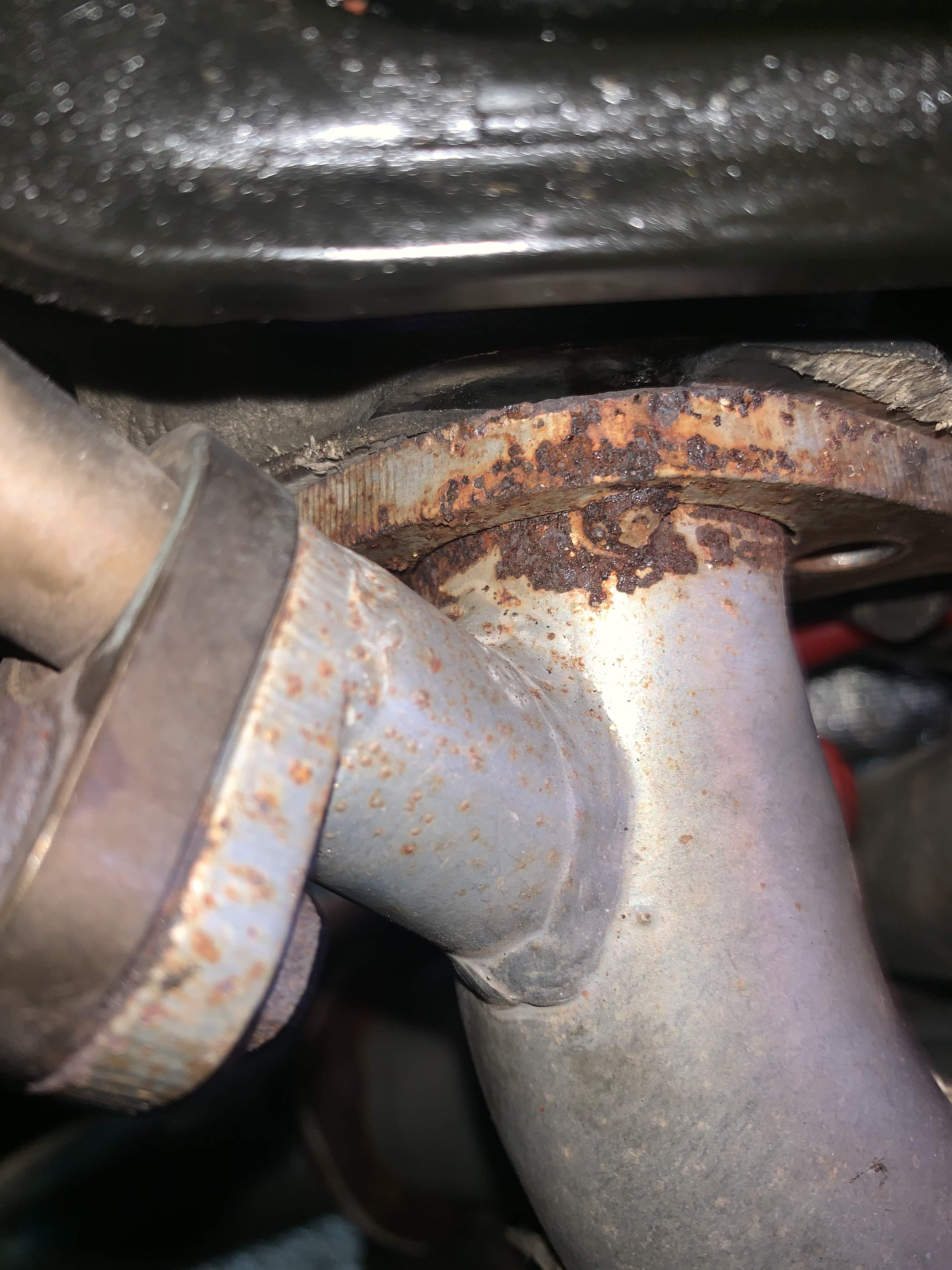

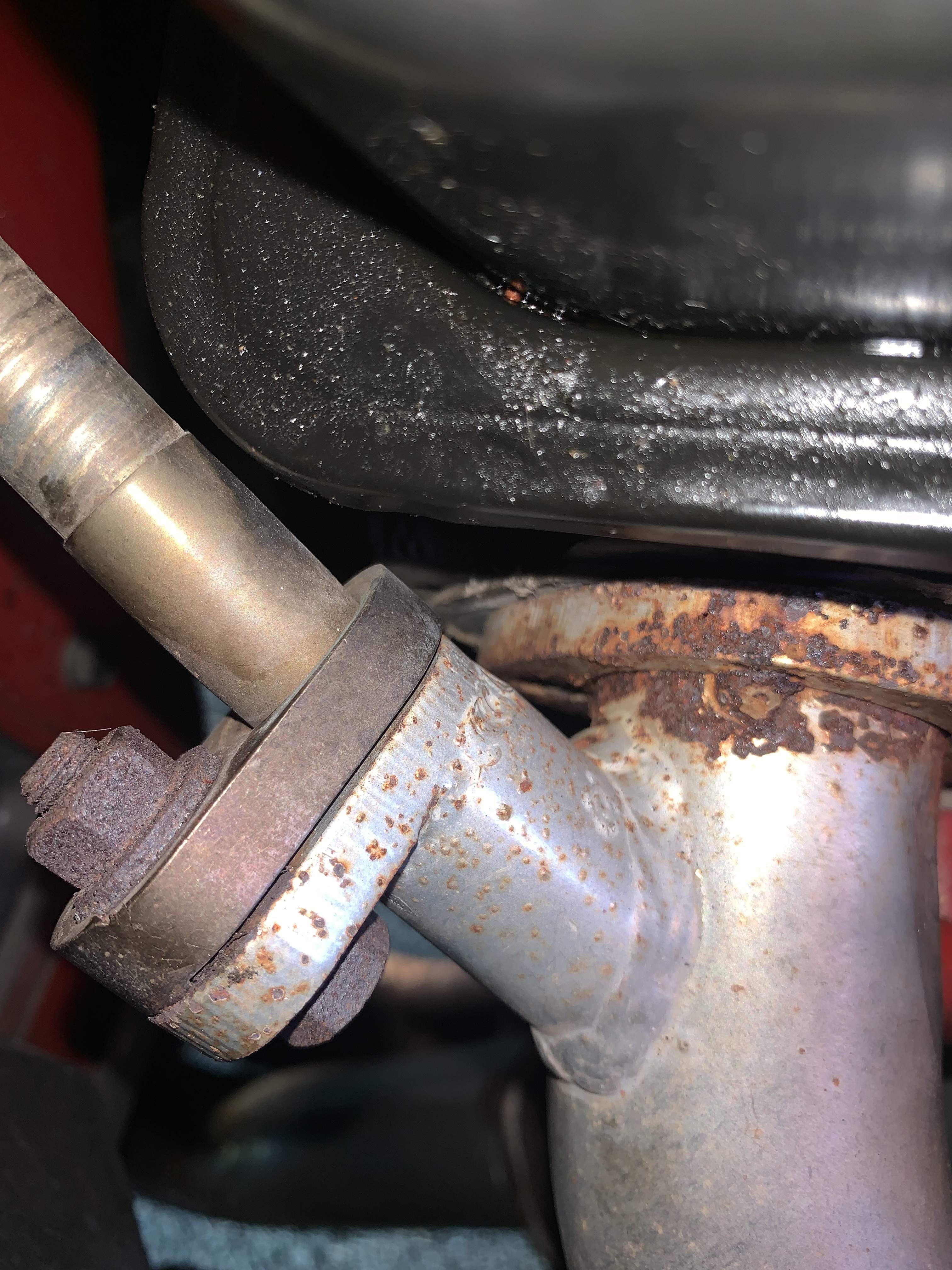

Drove my car one night (ran fine), parked it. Then started it the next morning and the engine was ticking. I looked where the ticking was coming from... and the 2 bolts on the rear flange of the passenger side header both had fallen out and the gasket was sliding around. The previous owner used gasket maker and header gaskets too....
