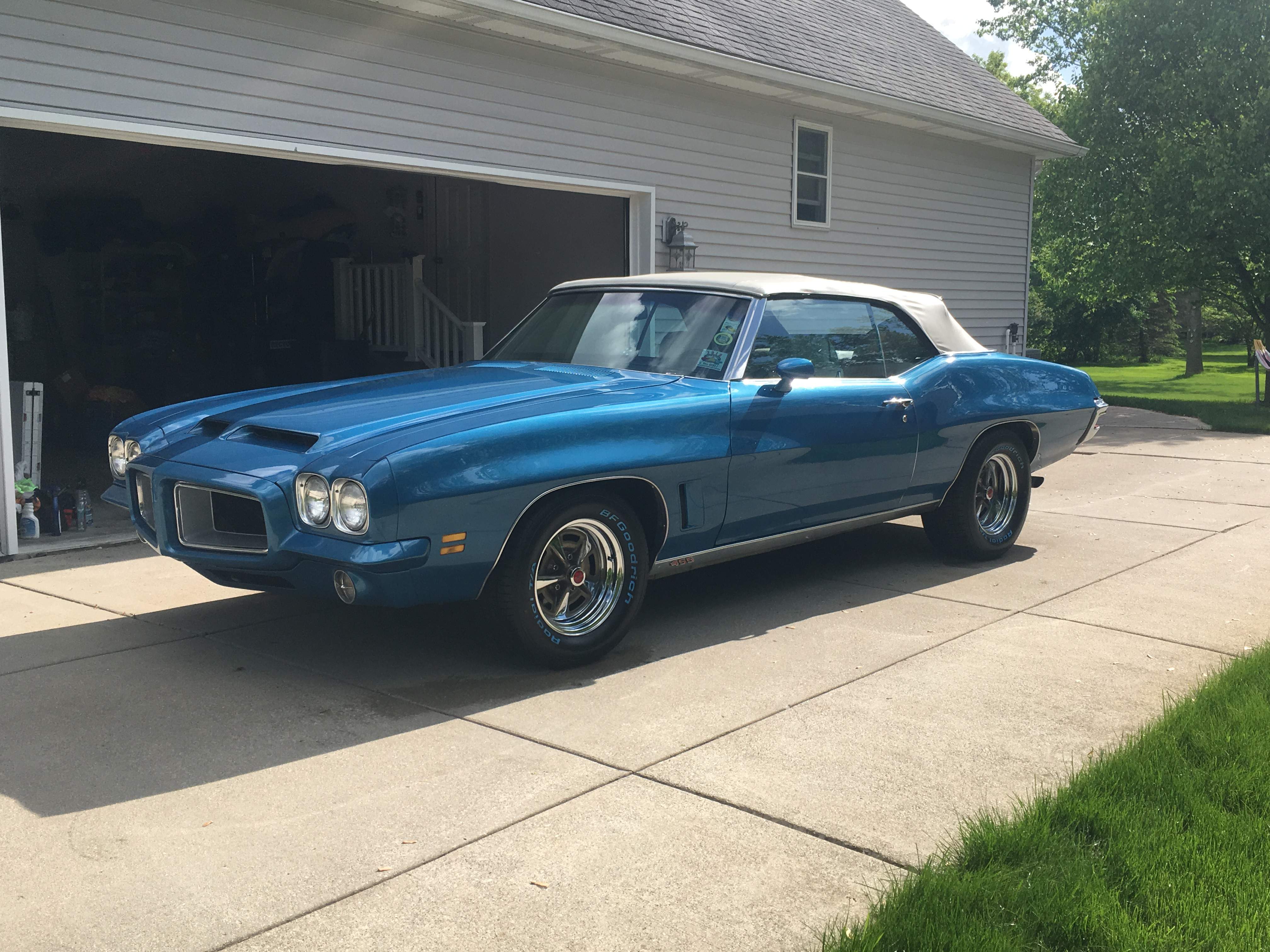

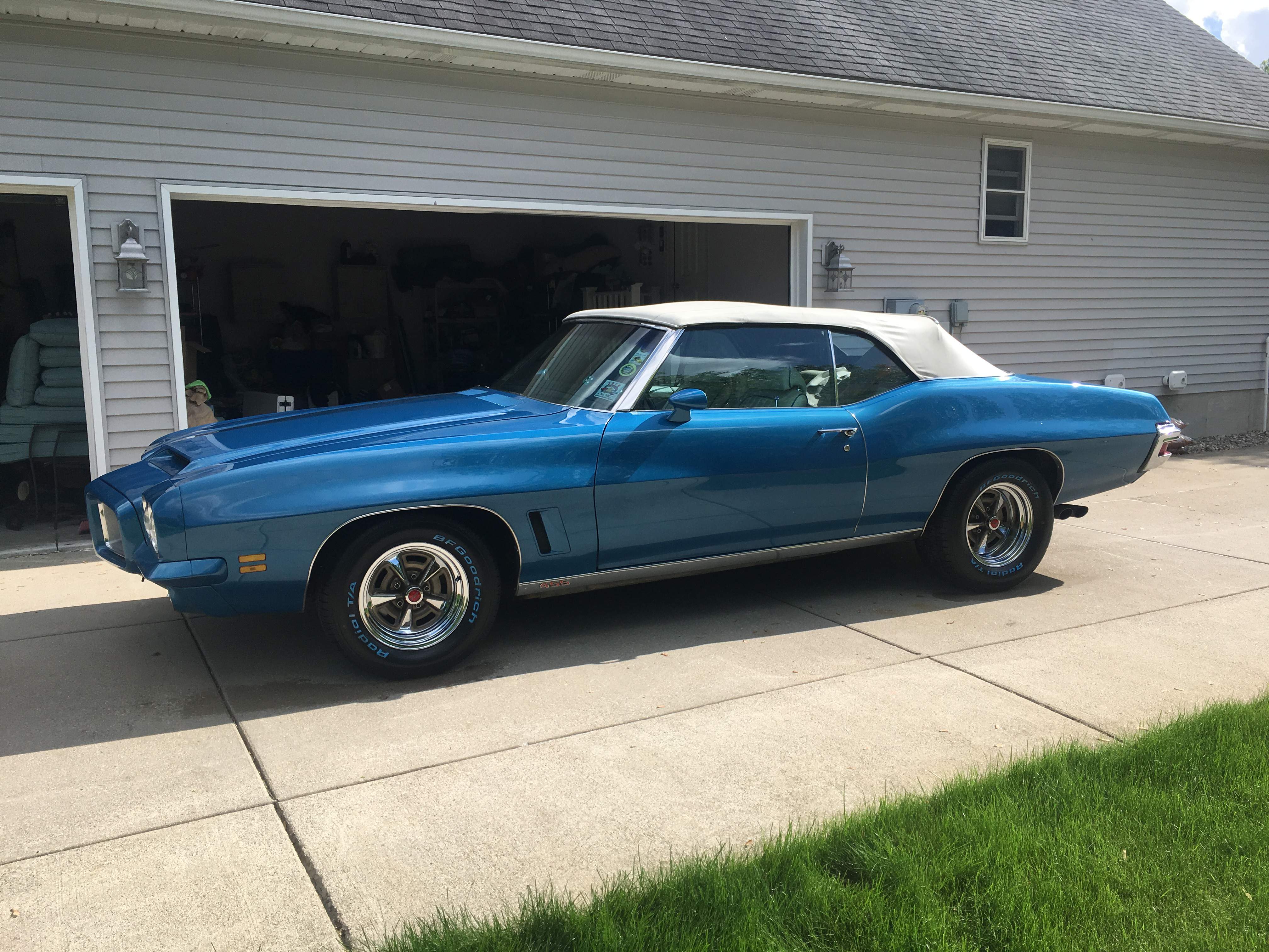

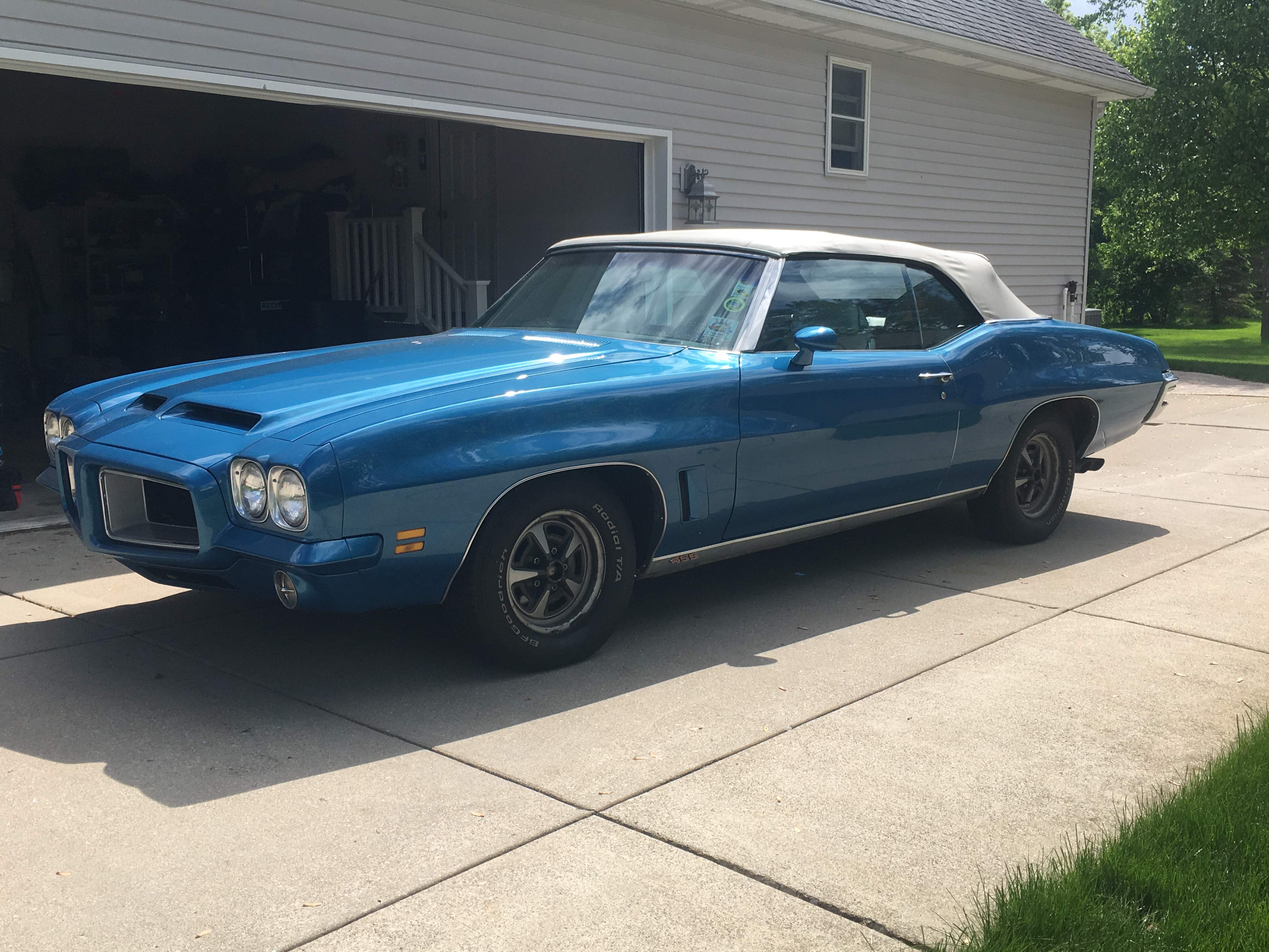

Okay Sunday was the big day. Lucy gets her new shoes.
Here is the before picture with the dirty stock 14x6 rims - minus the trim rings and center caps. The center caps went on the new rims.
Here she is with the new shoes. The new wheels definitely fill out wheel wells.

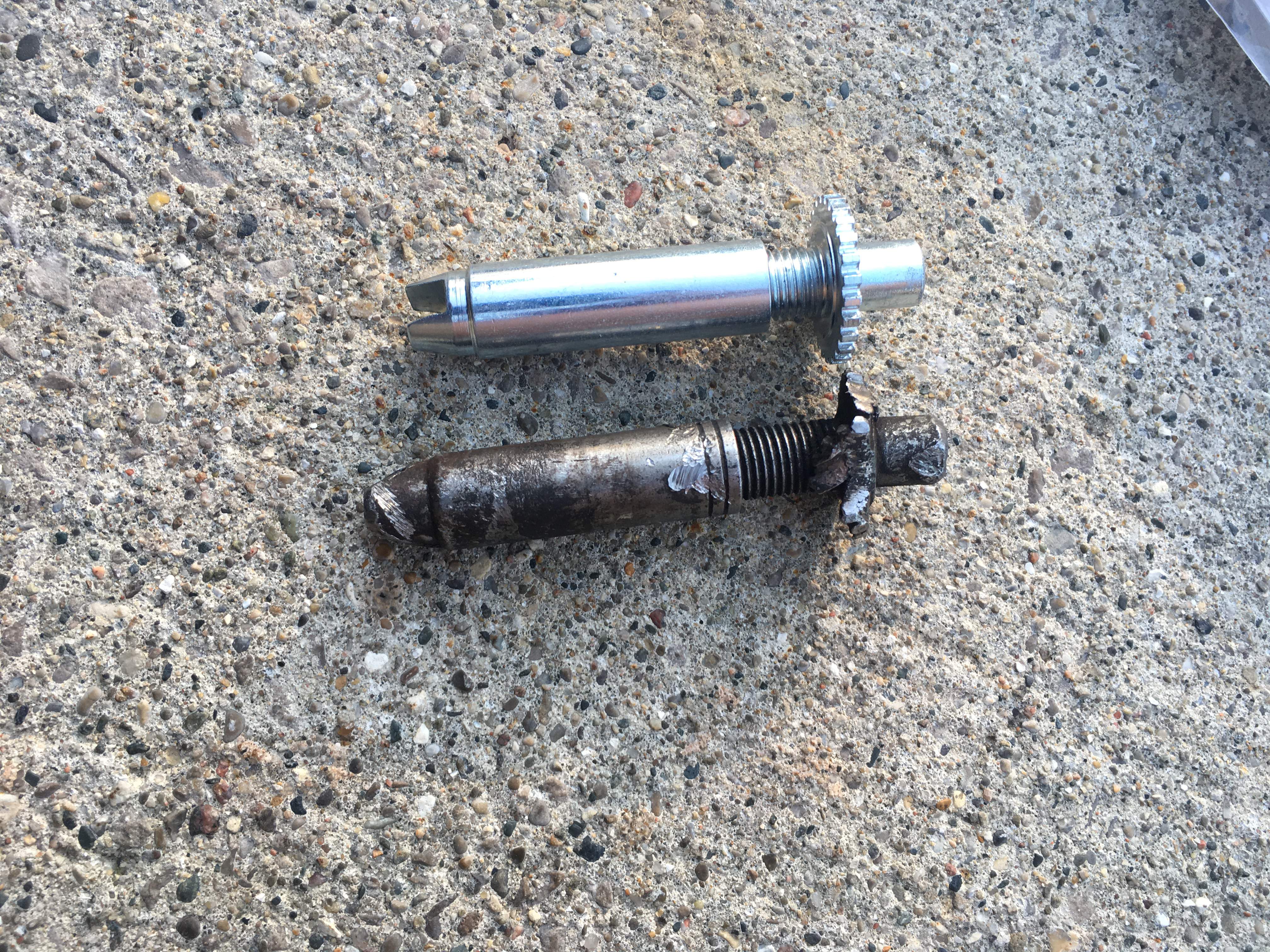

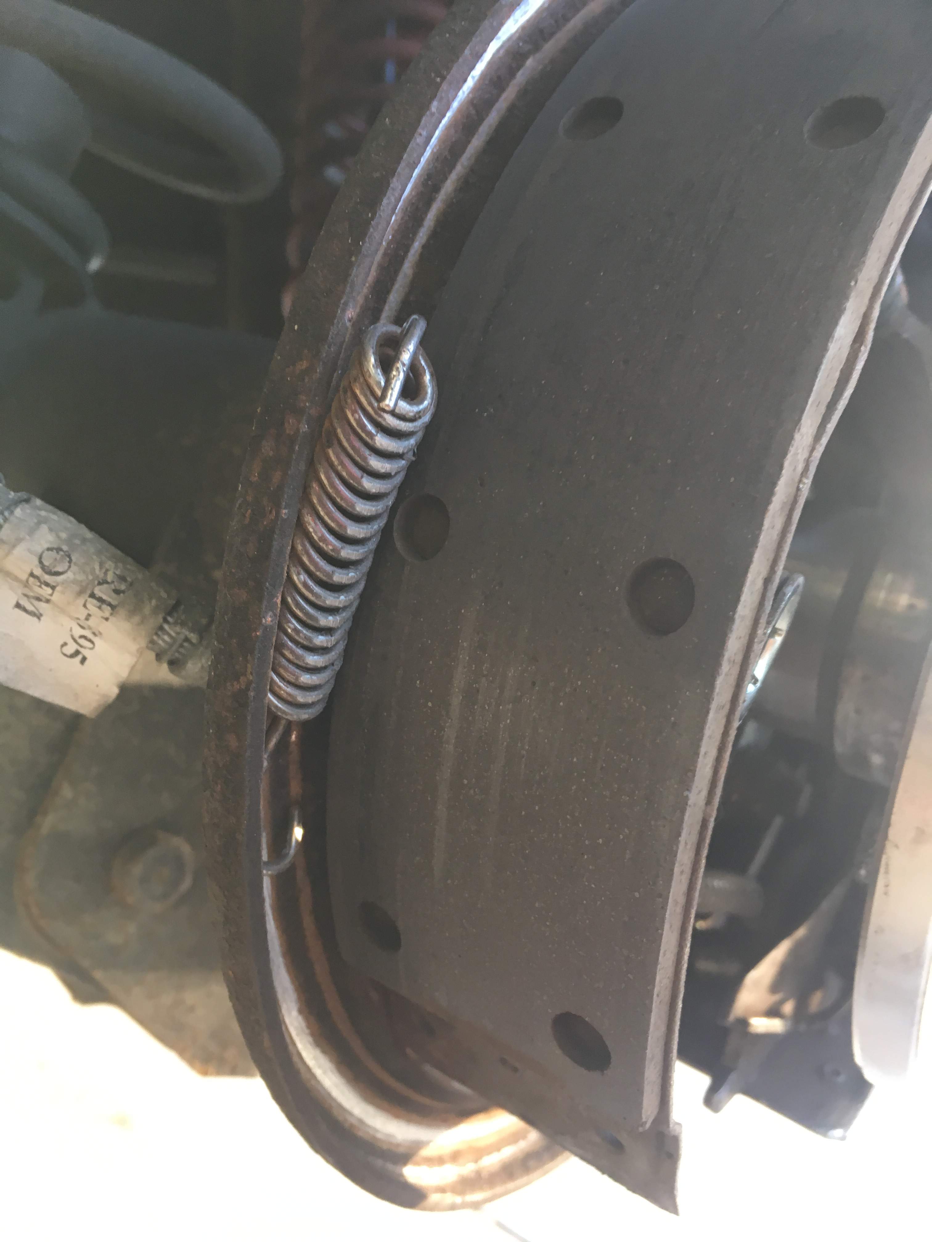

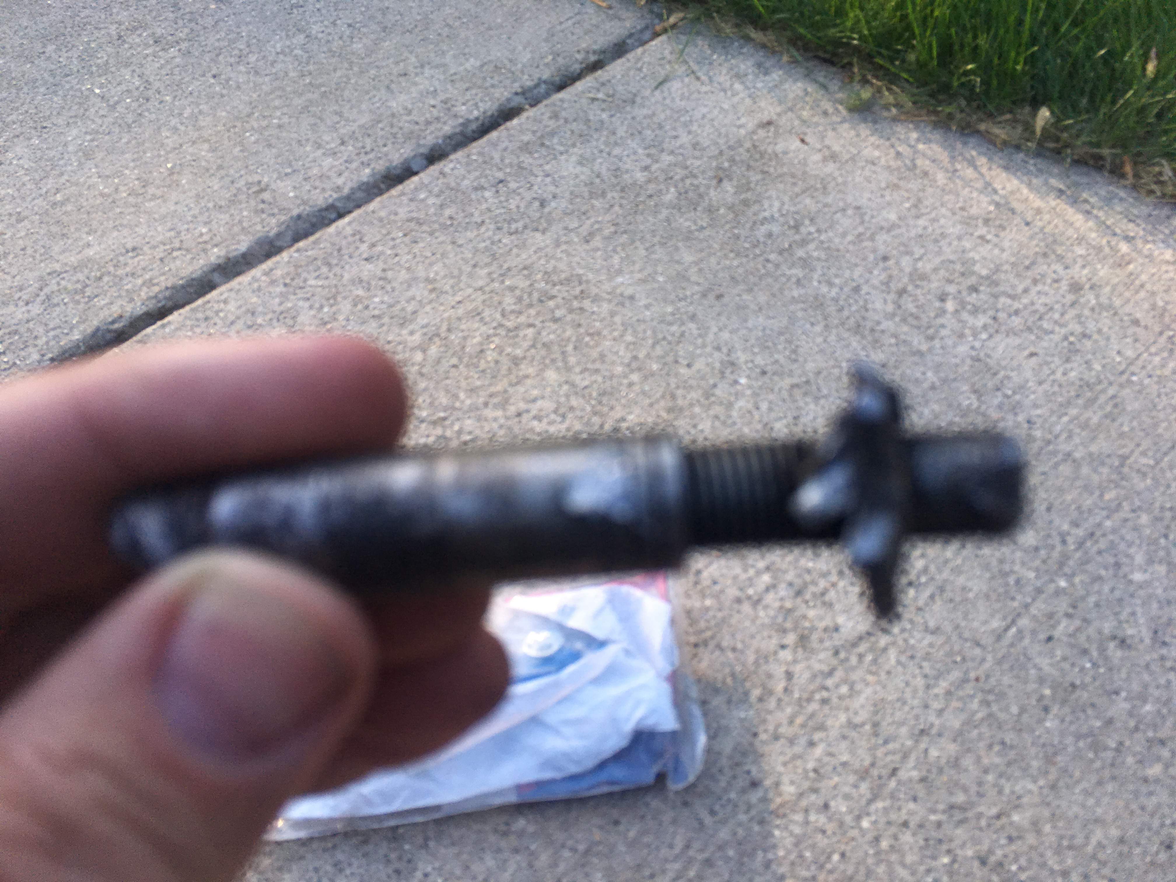

My wife, son, and I jumped in the car for a little test cruise once the wheels were on and we didn't make down the end of the driveway and we hear a horrible scraping noise !!!  I am thinking I have some sort of tire rub against something or the rear tires are too close the the fender lips. I get out, nothing obvious. So I back the car up and it's still scrapping! Uggh!
My son said the noise is definitely in the back. So we jacked up the rear end of the car. I took the passenger tire off first, I didn't see anything obvious. I notice that that rear diff didn't spin. Hmmm. I got the tire off and the star adjuster fell onto the ground, it was bent, and partially destroyed!
Then I found a spring embedded next to the brake shoes.
So two trips to two different Autozones later to get a new star wheel adjuster.
I was able to re-use the old spring and the new star wheel and put the driver's side drum back together.
Once the drum was back together, the kid and I tested the drums (we put some lug nuts on the drums) and put the car in gear while on the jack stands. No problems. We put the new tires back on and put the car in gear with it still on the jack stands. No problems. Finally we let the car down, double checked the lug nuts one more time, and went for a quick slow trip around the sub-division. No problems.
Finally, we got the wife and kid back in the car and drove it through town and the put the car way.
Whew!
A one hour changing of tires turned into four hours of fright, worry, relief, and finally triumph. I told Jacob that working on cars always takes twice as long as you planned.
For the record, there is a slight scratch on the inside of the brake drum. Not sure if I am going to do anything about it right away. I do plan to take the car to Tuffy after the Widetracker's Dustoff and have the front end alignment double checked, and I may have the brakes inspected while I am there.
What a day!
Oh my, what a frightening sound that must have been! Least it was only in your driveway and not out on the public roads.
New wheels definitely look great though! Worth the heartattack of the drum issue :lol:
Them sure are purdy....... Better brake issue than tire rub!

So 15x7 fronts, 15x8's rear sir? That looks awesome!
Thanks bud. Indyman Joe set me in that direction. That's what he runs on his '72 Luxury Lemans. It definitely fills up the wheel wells.

Well looky looky! Ain’t them niiice! Have a Frosty one on me!:cheers:! That’s why you should always carry a boat anchor. On the serious side, did the old wheels stick to the drum at all when you removed them.
Now that you mentioned it Last Indian, the driver's side rear tire did stick a little when I took it off, I had to push the drum back on slightly. I wonder if that is when everything went to hell-in-a-hand-cart?
29 minutes ago, Frosty said:
That's makes two of us. I just hope our bad karma with brakes is not contagious Joe!!!! :picard:
That would be my guess! I’ve seen it before. That tweek on the drum pulls the shoes or shoe, which pops the spring or adjuster enough to move it out of position. That is why I always use either a gasket between my wheels and the rotor or drum whichever the case may be or anti-seize, painted on the surface of the rotor or drum where the wheel hits, even on the locating hub. It also helps to stop the dielectric action of the dissimilar metals from causing corrosion.
