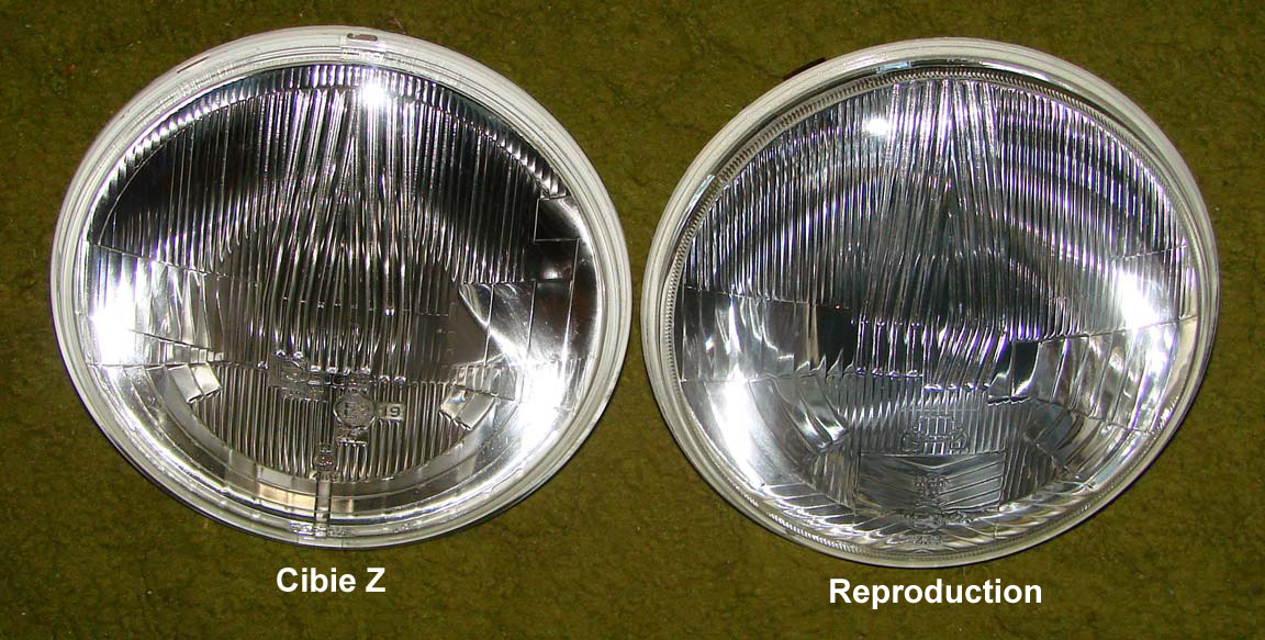

Well maybe things have changed, so you will have to do some investigating, but hands down the best headlights I ever ran we’re in my 69 Z. They were 7” round aftermarket Cibie headlights that were direct factory replacements. They were not sealed beams and they took an H4 bulb. I run HIDs in my Lacrosse’s and my Grand Prix and they still don’t come close to the Cibies. The Cibies I ran had used 24 percent lead crystal lens, a true mirror plating on the back metal reflector parabolic.  The actual performance came from the lens. While it was a 7” round light the lens threw the light down and slightly to the right no light existed above the horizon mid line. Just like a projection headlight in today’s cars, but without any loss due the thick magnifying lens and a multiple bounced light signal that has loss due to opacity issues.
See attached link.
https://www.demon-tweeks.co.uk/motorsport/headlights/cibie-5-34-inch-e-approved-headlight-conversions

I had some of those Cibie headlights in the 90's. They and the T3 replacement headlights are dinosaurs today. Those T3 light are barely any brighter than the crappy stock lights and SUCK the amps out of your likely undersized for them headlamps alternator.
The answer? HID headlights, for sure. My HID headlamps appear stock, use lots less amps than a halogen or OE light, and on low beam put out at least 100 times more light. I don't even use high beams for fear of blinding low aircraft. Ok, that may be a little exaggeration.  But one HID light puts out more light that 4 factory lights by far. Check out https://www.octanelighting.com  and thank me later. Check out the presentation I gave below, and no, I do not work for octane lighting.
April Tech N 10 DAPA headlights.pptx
I understand you may think you had some Cibie’s, but if you are comparing them to T3’s then you did not!
First of all Cibie are only non sealed Halogen lights! Which in the 1990 were still illegal in the US for highway use. Which made them difficult to obtain. T3 are sealed beam! Second Cibie’s are a special metal parabolic housing, that use pure silver that is plated on to the housing, with a patented specifically cut 24% lead crystal lense that distributes the light very similar to a cutoff projection headlight. This combination presents a wider flatter, but further out light pattern than any past or present sealed beam headlight! This headlight became the benchmark that all the marketers of today try to achieve. The very advertising photos they use to show are exactly the same type photo Cibie used in the late 1960’s. They also were quite pricey!
Third, with respect to light, any light, when used for illumination, but with concentration, there are two very important requirements! Number one is the design of the parabolic and it’s reflective surface characteristic! Then the all important Kelvin temperature. This temperature, color spectrum, determines how things are illuminated. This feature and only this feature is a more desirable element than the stock Halogen bulb! But in today’s world you could and can install an HID or LED bulb and have the best of both worlds!
The fact is that a 7” round parabolic is the best headlight shape followed by a 5” round! Followed by nothing! One of the main reasons manufacturers stated producing projection headlights was because their chopped up sculpted headlight designs just plain sucked! They needed a way to get back to an honest parabolic shape to be able to reflect light with the physical properties that come from that physics law!

It appears he can get you the Cibie lights. I would than recommend getting 5500 to 6000 Kalvin color hid lights! These will consume less power and run cooler then standard H4 bulbs. Since your cars don’t run computers there are no issues for you to get around so you don’t need cad/cam canceling adaptors or the like. If you talk to a good HID company like Retrofit Source you should be able to tell them what you’re doing and get what you want. When you’re done you should have a very clean installation and a setup that looks stock!
