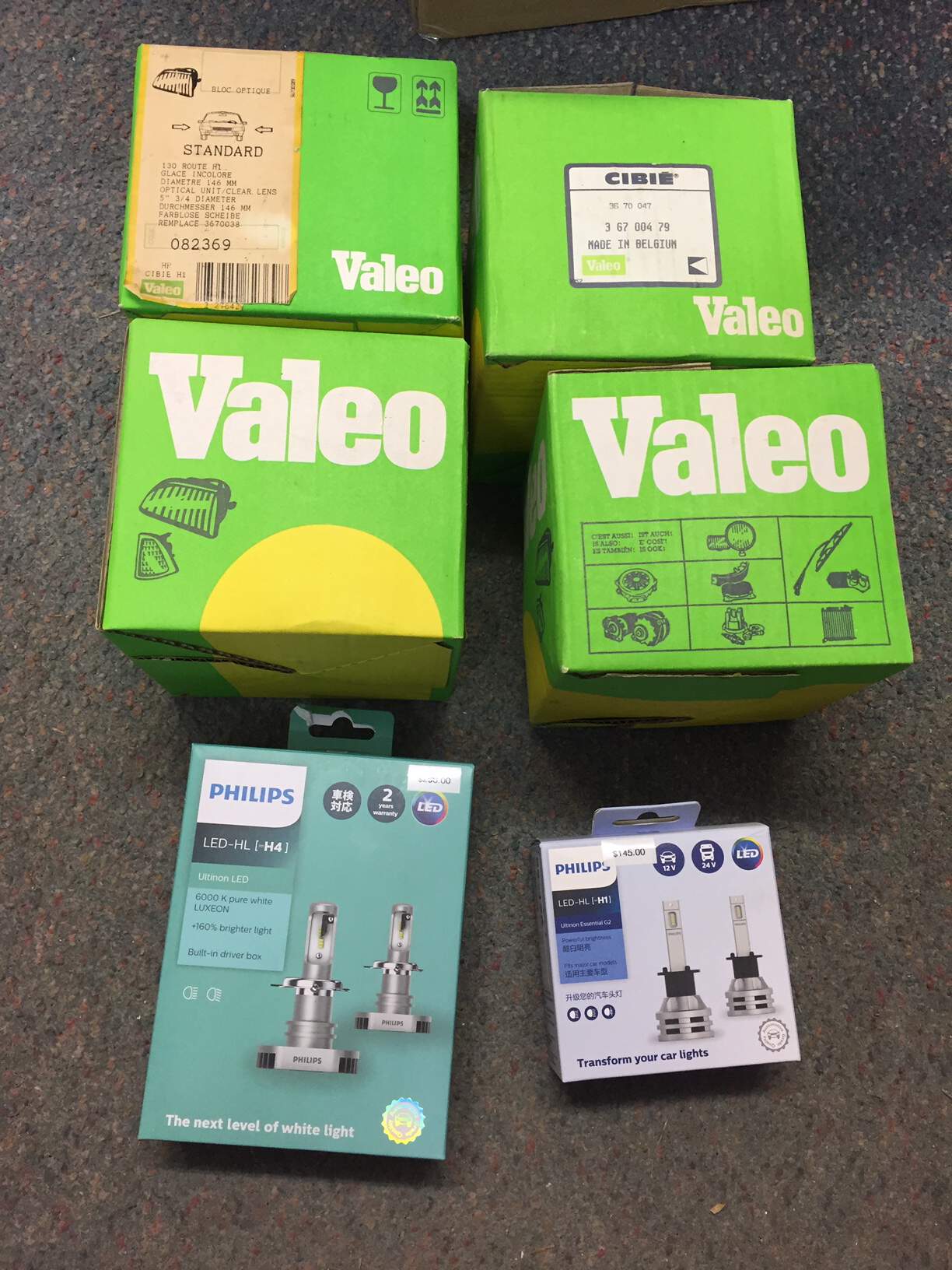

Today (friday) i have all my parts to change my headlights, i will be using the new girl(59 caddy) as my test bed for what i have.
 i have on hand 2 x h1 cibie seamy seal lamps and 2 x h4 cibie seamy seal lamps, made by Valeo and... i am going led !😜
 With philips units, not cheap by any means but i dont want to be changing them every year, i want them to last, and my research says they are just as good as hid units but draw less current and last longer.

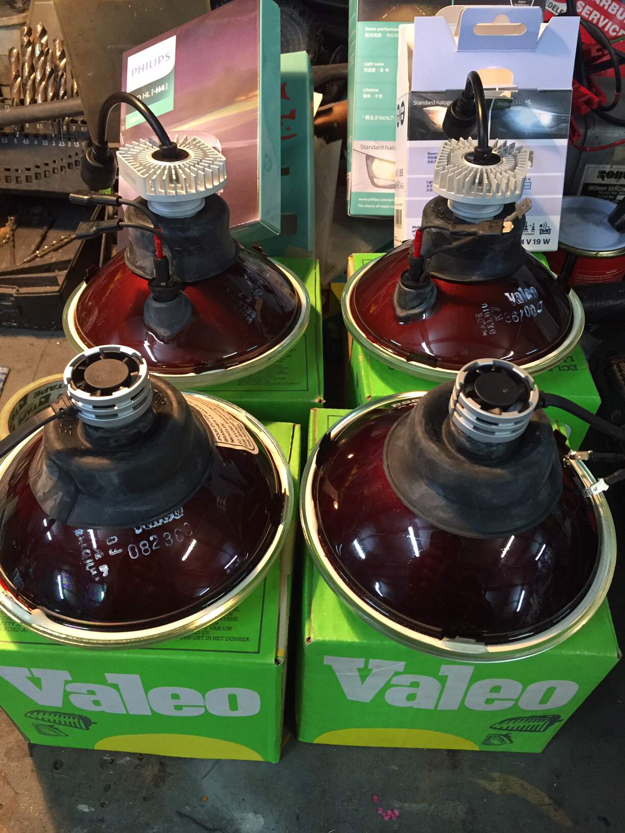

here are the Cibies with the leds all set to go. but first some pictures of what i am dealing with...

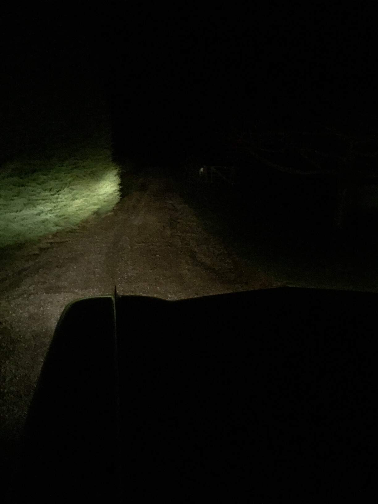

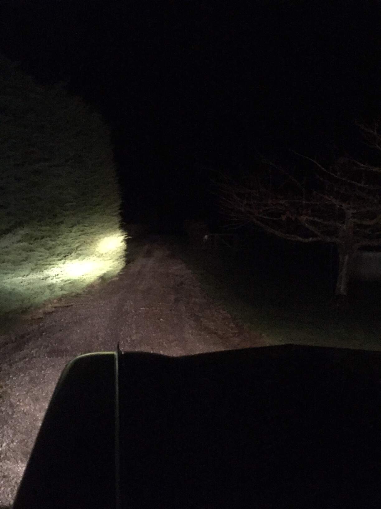

the lights were all over the place but here is some pictures of how useless they were

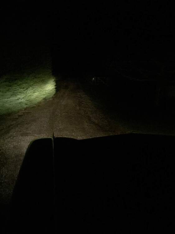

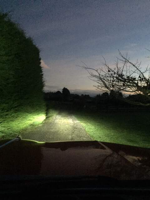

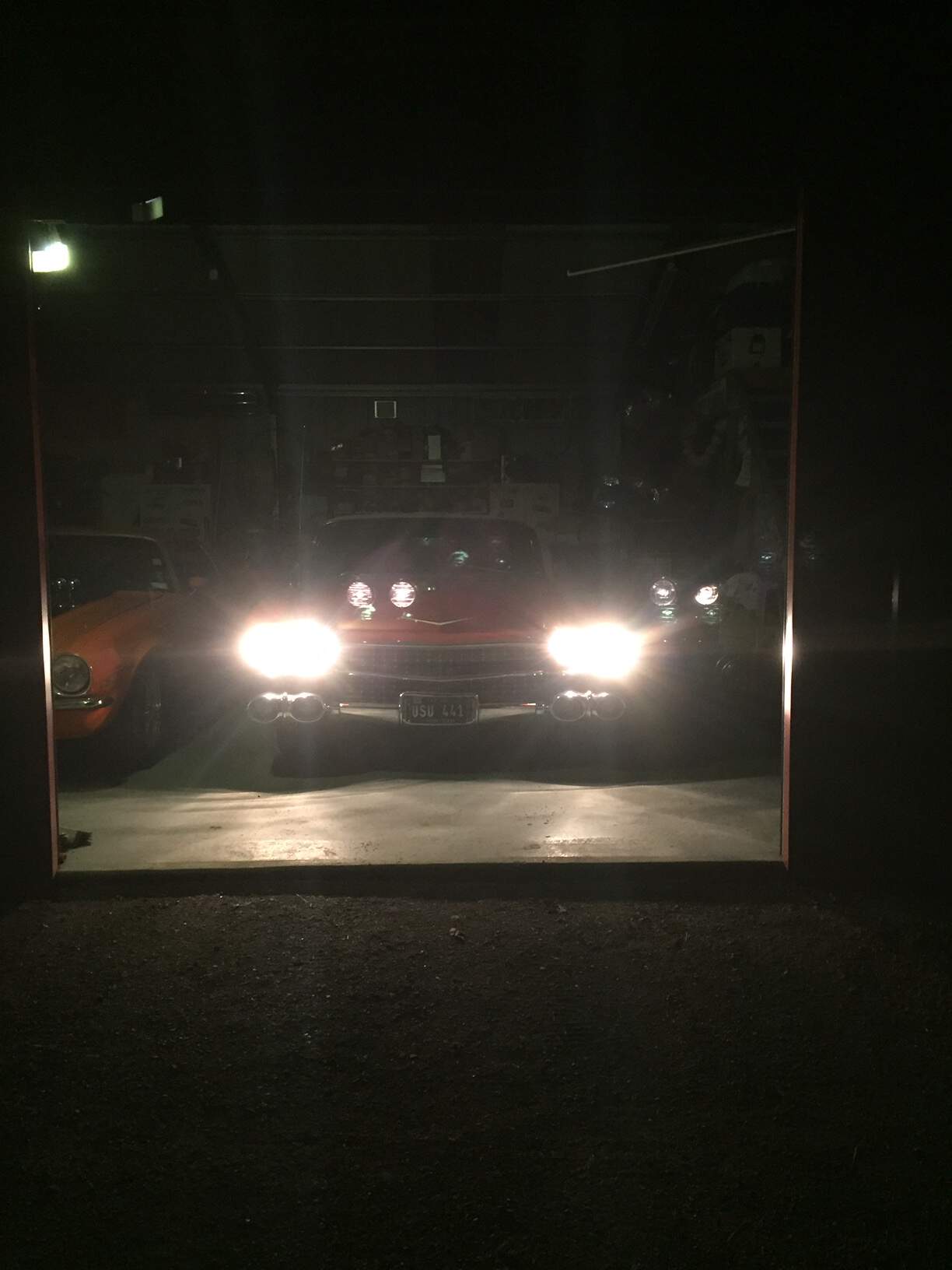

and here is the new leds on my drive way

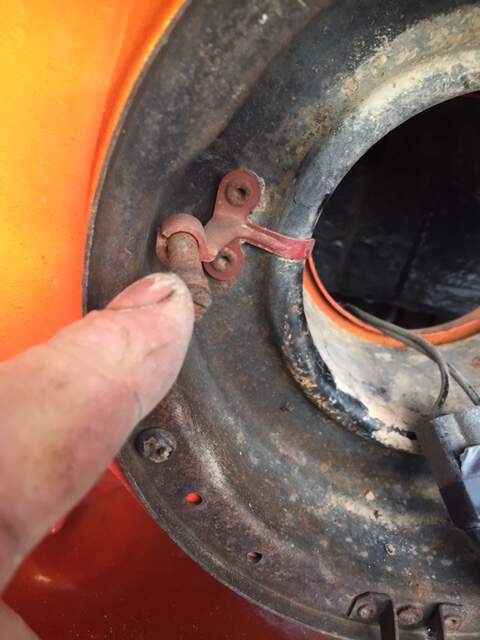

i did have an issue with the head light adjusters being all cracked and i have ordered new ones today
 which was why the old sealed beams were all over the place.
i went with the leds thanks to my auto electrician recommending them as to being way better than hids, no wiring issues and less load ment no requirement to add relays at all.
 total load is now 5.4 amps with all 4 lamps on.

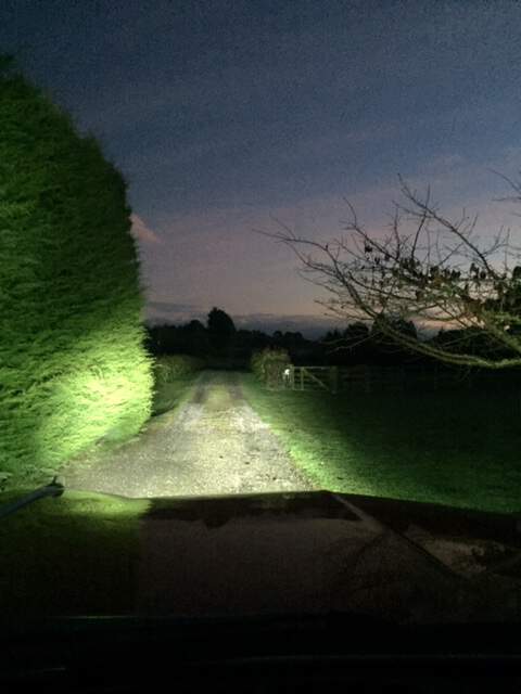

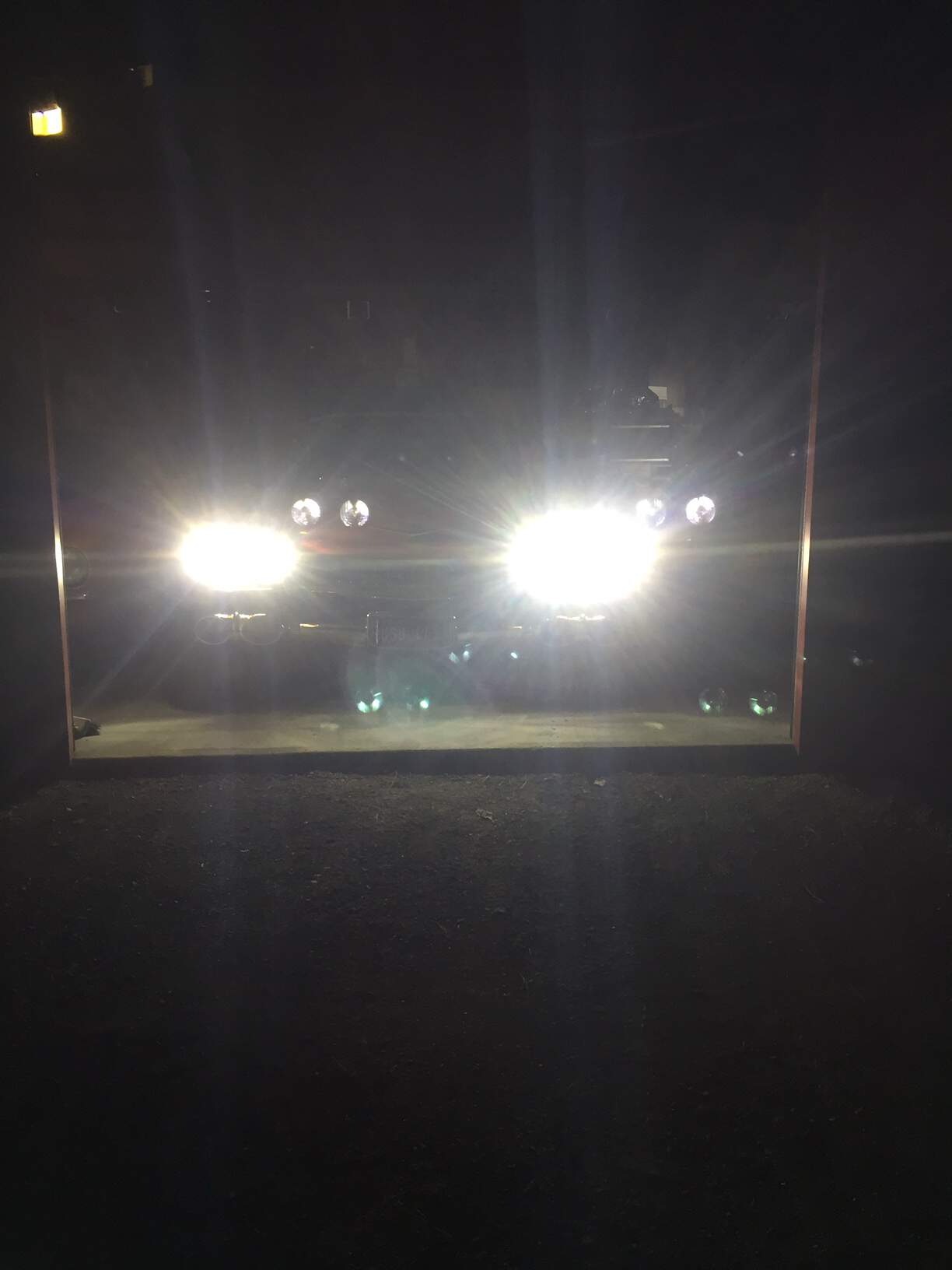

 below is the sealed beams on high and below the leds on high.
To be noted is what Last indian said, the cibies have a great line and i can see in the dark again!!!!:cheers:

Kiwi I’m so glad things came together for you. Different improvement in the illumination and I’m sure it’s more dramatic in person! FYI, I believe the HIDs and the LEDs consume about the same power, but as a bulb the HIDs will burn you were as the LEDs won’t! I think the LEDs ballast get hotter than the HIDs though. I’ve thought of trying the LEDs in the Indian, but I don’t think there is enough room behind the housings, as the LEDs need the ballast attached to them!

Yes last Indian, there is that big heat sink on the back of them, ( on the h4 bulbs) ( the h1 have fans )you would need to be careful that you had the room.:cheers:
Also the big thing for me with going for the leds is their life span is way better than the hids and i see i get a good 2 year warranty, and expected life is 8 years , but that must be based on normal usage, which i would be lucky to do 1000 miles a year in any of my cars total, even less at night.:dancingpontiac:

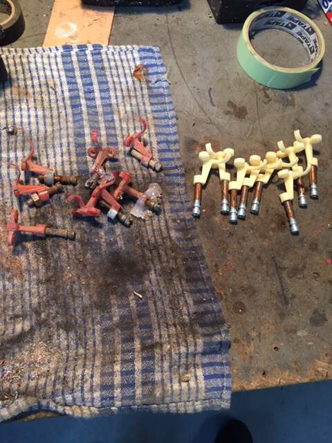

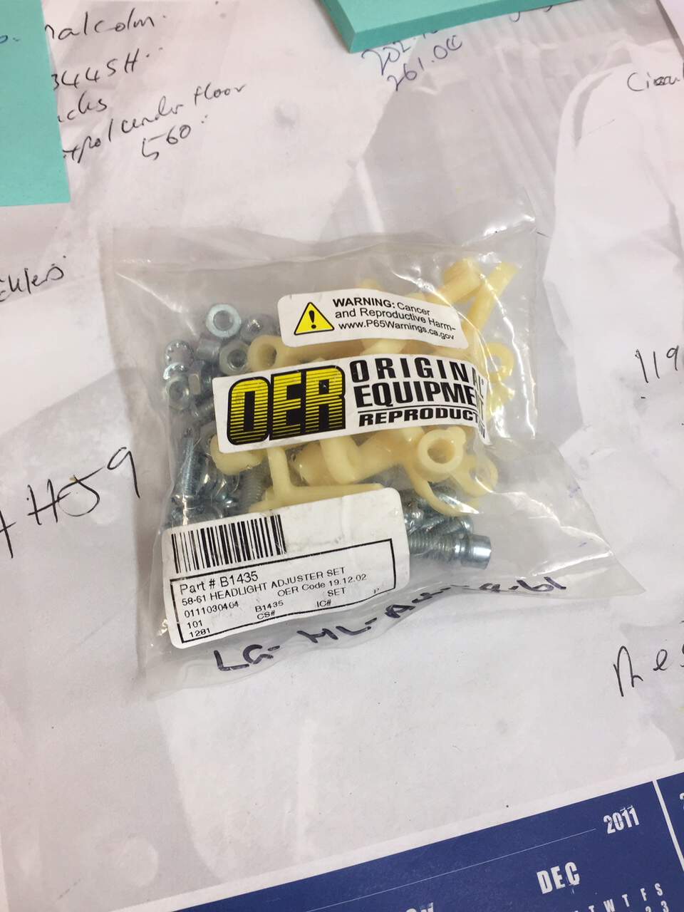

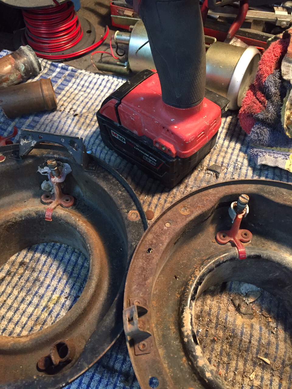

So today, Sunday, i got an whole hour to work on my light project in the caddy ginny pig :o
 i bought the new light adjusters out of my good mates shop in Auckland, Chucks restoration supplies👍 at a cost of $53.00
And removed the head light buckets, with all their old worn, cracked adjusters and 61 years of hard work🙄
assembled the new clips and just for the hell of it, i put anti seize lube on them, which may or may not make a difference long term.

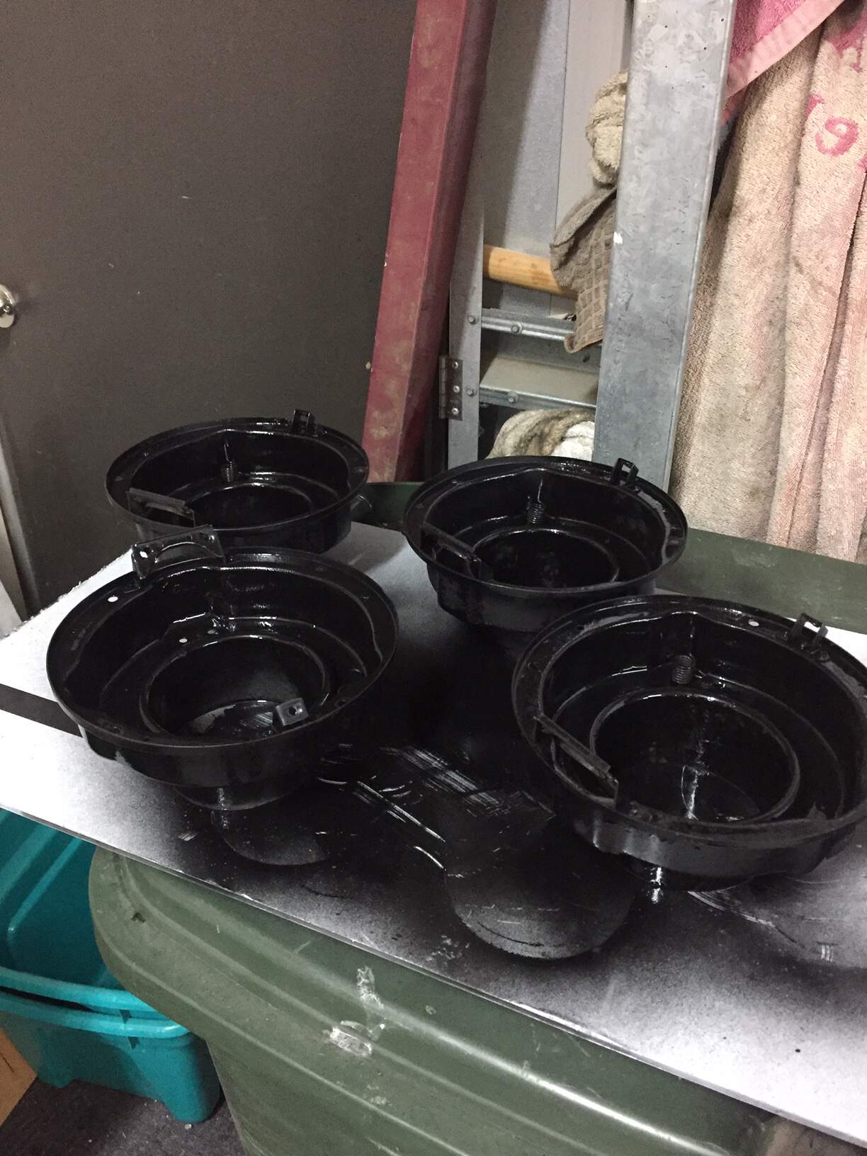

and gave the head light buckets a clean and rattle can recon, just make them tidy.
 its so damn cold here that my paint wont set, so thats it for today.
i will assemble them when i get a chance.... still waiting on my grand daughter... she still hasnt made it into the world yet and shes 4 days over due now !
To be noted is that these adjusters are just the same as any one with a 58-61 pontiac has too!:o
