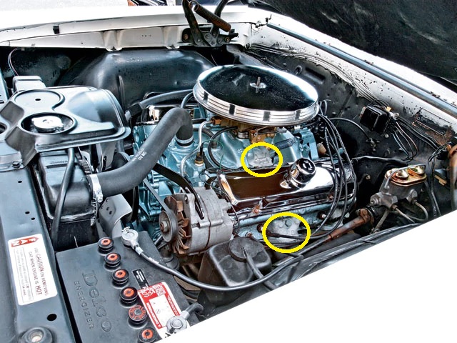

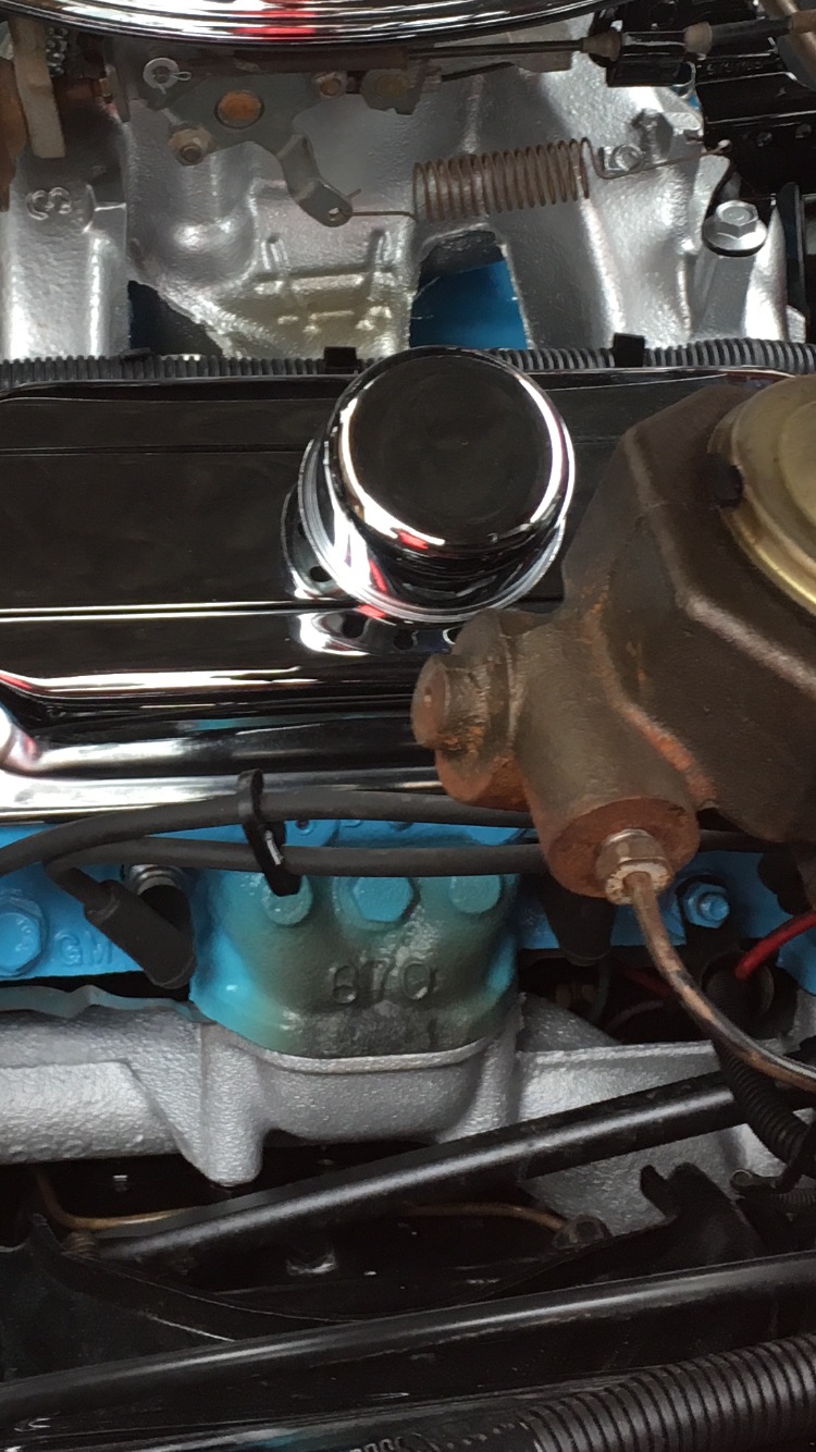

The paint is burning off of my motor in the same place on both sides of the engine and I was just wondering if this is a common thing or if something is wrong, if it’s something wrong any suggestions on how to fix it.
I'm afraid so, this is pretty typical of Pontiac V8 engines. Even if you use something like VHT's High Temperature paint, this will eventually happen. The problem usually starts at the Siamese inner exhaust ports but it will eventually spread to all the exhaust ports. It will stop about 1/3 to 1/2 up the heads. It just looks funky and not as neat as you'd like it to be - especially since you went to the trouble of painting the heads to make them look pretty in the first place.

Eastwood, brush on silver exhaust paint will solve your problem.  Same prob with all Pontiac V8's as Frosty said.  I touched up my exhaust manifolds last spring.  Paintwork had to be 6-7 years old at least.  Awesome stuff, quick N easy fix when needed.
