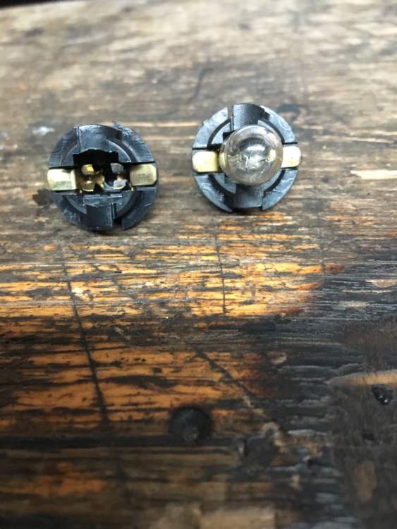

I pulled my dash twice to get all the lights working. Very lightly very very very lightly sand the sockets where the tabs on the bulb holder touch the circuit board. do not sand the circuit board! I found by doing this all my bulbs worked the second time. pic to follow
