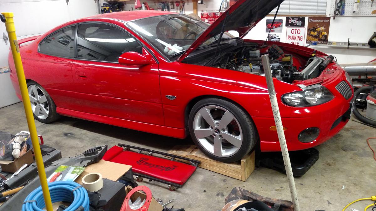

In 2009 I purchased a GTO from my sister that she ordered new.

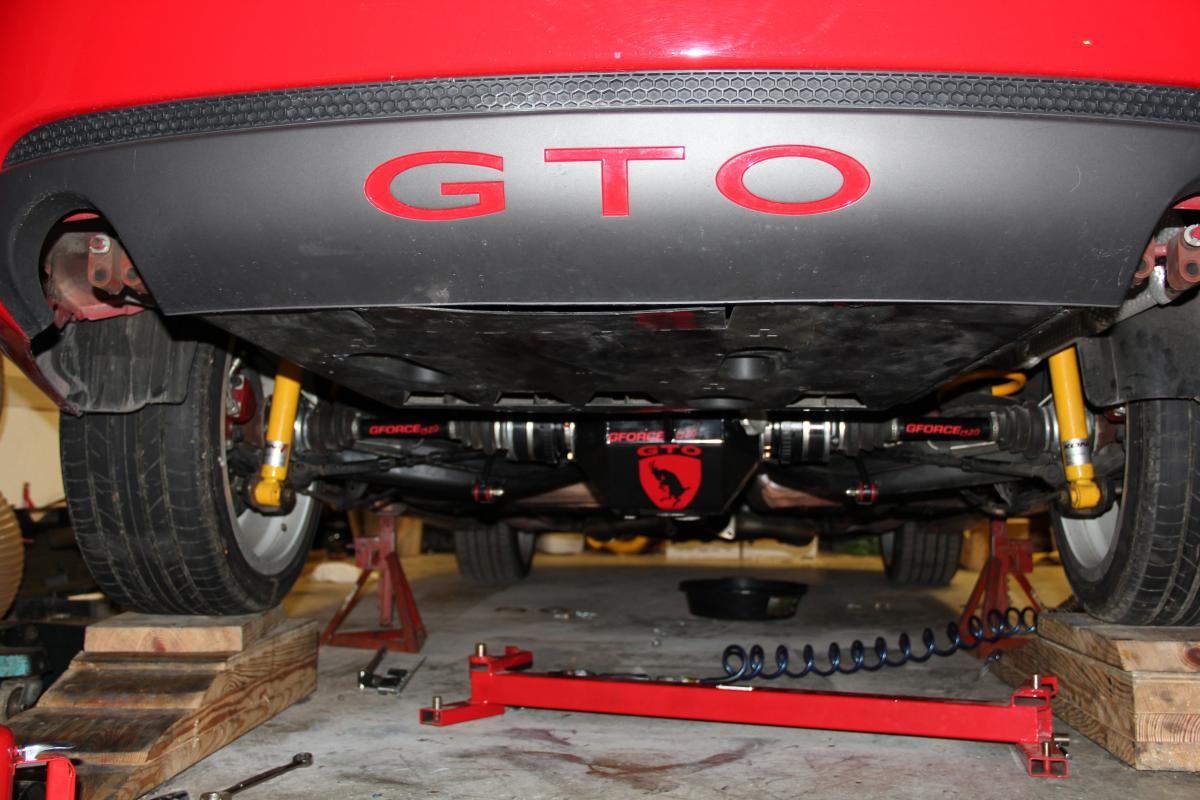

It has 24,400 miles. Right now I have it disassembled and I am installing a 1900 tvs , blower cam and getting the heads ported along with all the new parts that goes along with the build. I have already done all poly bushings , Konis and King hd springs , headers and a Gforce 9inch rear.

Goddamn that's nice. What else you got goin on with her?
Once I get the motor put back together I am going to make a suede intake out of fiberglass and fiberglass it to my radiator cover ( like a duo speed ) and switch to an ls3 maf before I take it to get tuned. Than before spring make a lip for the front.
Nice are you doing the fabrication yourself or are you hiring out? Are you going to keep the original engine? Interior mods?

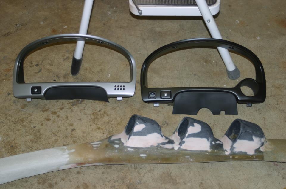

I have made a pillar pod (which I still need to cover with headliner to match the interior. )
and added a gauge to the gauge cluster ( black one. )out of fiberglass and that added 4 gauges.

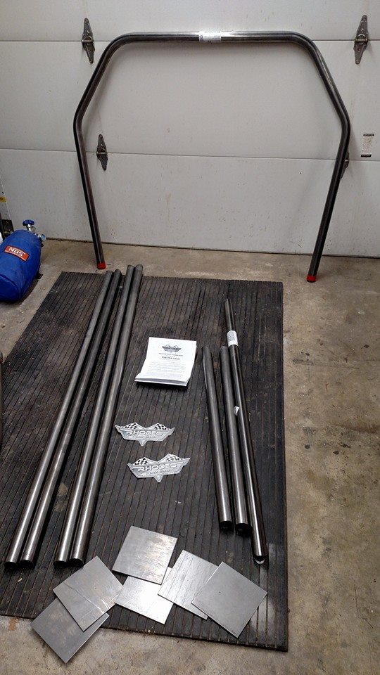

I also have a roll bar that I will weld up and modify.

When adding the rollbar, do you have to add sub frame connectors? Now's the time to look into that. Great lookin build. :dancingpontiac:

I am going to modify the 8 point roll bar and install it now as a 4 point but it will be bolted in for now so I can get it out of the way next winter.
My plans are to mini tub the car later to get more rubber under it and at that point I will weld in the bar and you won't know it was ever bolted in.

Do NOT mention the rollbar or show pictures to you Insurance agent. You'll be surprised that most Ins comps won't even touch your car with a bar in it. I'm forced to pay almost 3X the amount on a 6 mo policy for my Sunbird, as I do for an entire year on my GTO. Justa....heads up.

Now I am thinking about Just making it a bolt in bar in case I need to get it out...
A bolt in is better than no roll bar.
Check your sanctioning body rules first GoatBoy. A bolt-in cage may not be acceptable to some racing groups for fear that the bolts will shear in a roll over. While I agree with JUSTA on the price of insurance, a bolt-in cage has the potential to limit the sanction groups or classes of races you can run in. Just saying....do your homework and then make you decision of cost vs. benefit.

Goatboy - Most sanctioning bodies want your roll cage to be welded and the usual minimum is 4 point. Also, on fire extinguishers they have to me mounted and not with the thin sheet metal mounts. Ridged mounts only. Also, if you use a fire system or bottles like I do. They need to be layed down and the nozzle or head of fire bottle pointing inward or out ward so that it can use the contents properly. Never point it towards the front or rear of vehicle since force of acceleration or breaking will cause contents not to disperse properly. Before you install your roll cage and this is just a strong suggestion install strut supports and weld in sub frame connectors which will stiffen your chasis before you put roll cage in. Make sure to level car frame before installing sub frame connector. Because if you weld or bolt the roll cage in (hopefully weld) it can and will tweak your frame if it is not true then you alignment could be a bear to adjust and cornering a pain.
