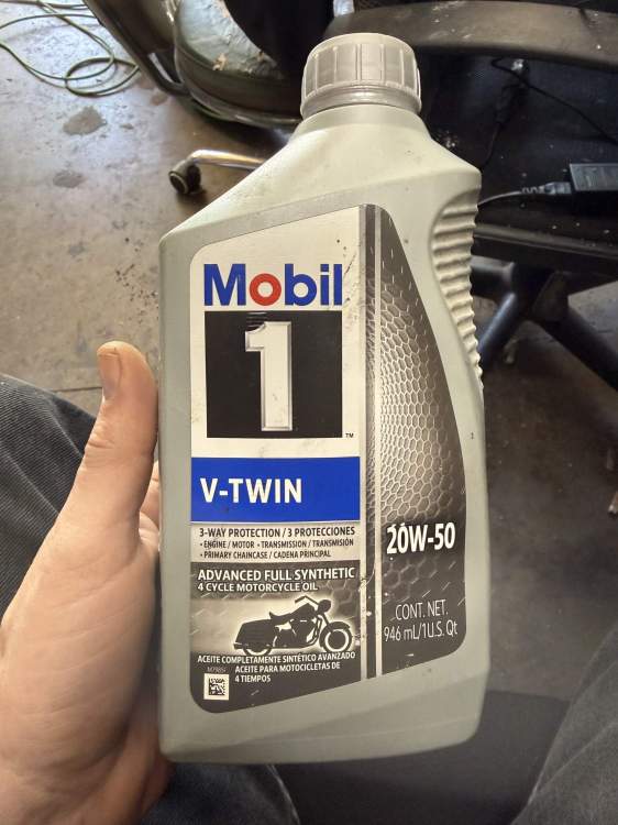

So as normal I over think things and have a question. Please forgive me for asking a NON- Pontiac question. So, Mr. Indian, when I bought my Harley new in 2003, I was told to only use conventional oil in the engine until after break in. The reason I was given was that synthetic would not allow then engine to get hot enough to properly seat the rings. I always assumed that was BS but was never sure. I was also told that after break in IF I switched to synthetic not to do it all at once but replace one court of synthetic at a time during the next 4 oil changes and once I was running synthetic in my engine I could also run the same oil in my trans and primary. So, I also always used HD brand oil as the manual instructed. One day while at HD picking up stuff for an oil change, I got talking to their oil guy and asked him who made HD oil. He told me that Harley bought their oil from the cheapest vender, when the vendor contacts expired, they got new quotes and that became their new oil company. That was when I switched to Mobil 1 V-Twin full synthetic 20W-50 in all 3 of my box's and have used Mobile 1 in my bike ever since. Now back in the 80s and 90s when Shovelheads and Evo's where in Harleys I remember using the same oil in my truck and bike. I would literally buy 2 gallons of Trop-arctic engine oil and do both oil changes, 1977 F100 360ci and 1976 sportster 1100 cc at the same time. My bike now has an 88ci (1450 cc) air cooled engine, is there any reason why I couldn't use Rotella T6 in this bike? If I can, do you think it would also be safe to run it in the trans and primary?
Thank you for any knowledge you can pass on. Not sure if I can or will switch from my current set up but would like to have then knowledge and option to if the need arise.
Wrongway,
The short answer is yes. Yet for the HD I would suggest Amsoil 20w50 synthetic! A far superior product! Since the bike is a low volume & protects multi-functioning parts that would be my suggestion.
