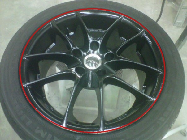

Started repainting the ROHs tonight, started with the worst wheel. This wheel was dismounted recently for a flat repair, so the lip not knicked bad by the newbie at the Goodyear down the road from my house.
Dry sanded with 1000grit paper:
First dust coat:
After two medium coats under teh heat lamp:
Throughout the rest of the month, the other three wheels will be touched up in the same fashion.

Nice. Did you clearcoat them?
Need to paint my wheels as well...
No clearcoat. I used gloss black Rustolium Engine Enamel. It's very durable paint, and very glossy by itself.
Id still suggest using some cleacoat, even so you can have the finish last a bit longer. But thats me lol.
Considering there was 30K put on this paint finish before the season ended, and it was still nice and glossy, I think it'll be fine. :D Clear won't do much when the outer lip felt like flaking off. ;)
