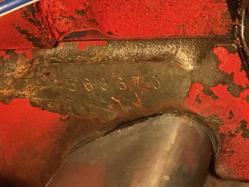

This looks like the front of your block.  Check the rear deck around the distributor.

You should look on the front passenger side of the block, near the water pump. There should be a two-letter code and underneath are 5-6 digits. Those digits should match the last digits of your car's VIN.

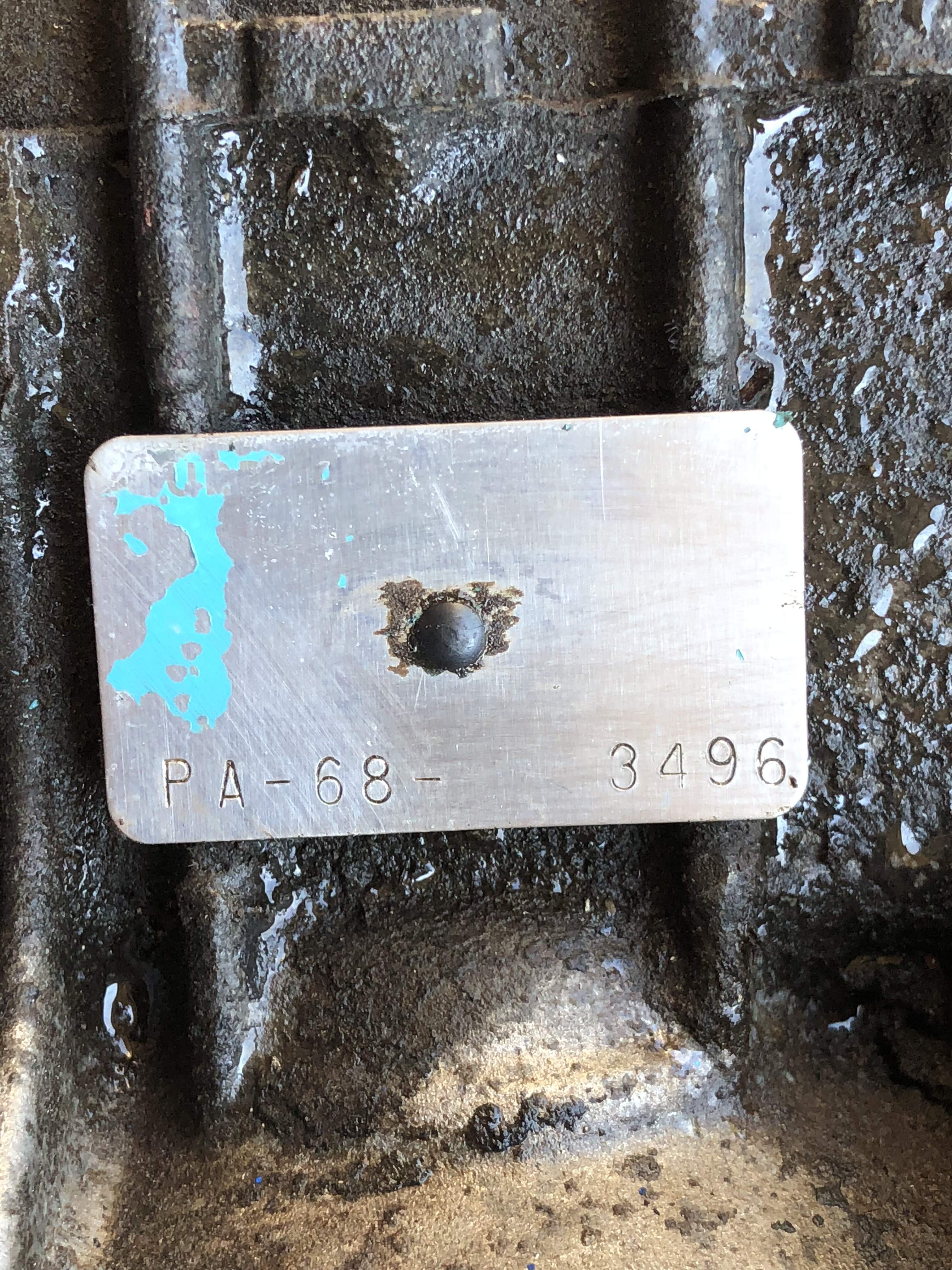

Yes - sort of. The transmission has a serial number on it, however, it does not match the last digits of the VIN. Instead it should read some like this example:
68 PY   1325
68 is the model year for 1968.
P is for Pontiac division

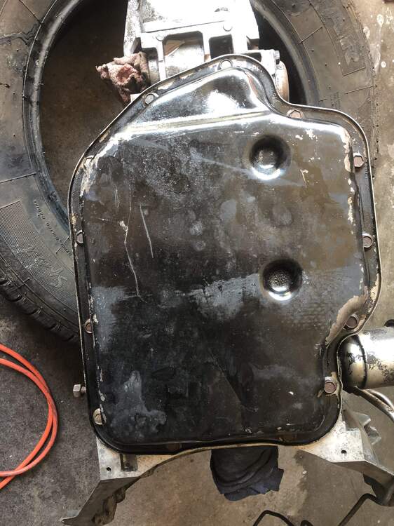

Y is the designation for a 400 Turbo Hydromatic transmission (you can validate what type of transmission you have from the shape of the oil pan too).
1325 is the transmission's own serial number. If you have your PHS documentation, you should be able to tie this serial number to the car's build sheet.

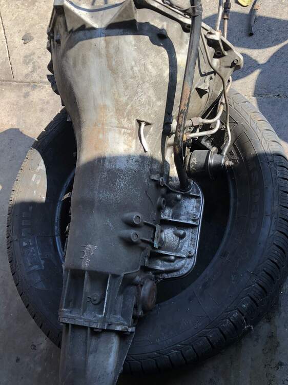

Here's a couple of pics of my 68' Th400 with the tag from when it was out and the shape of the pan.
