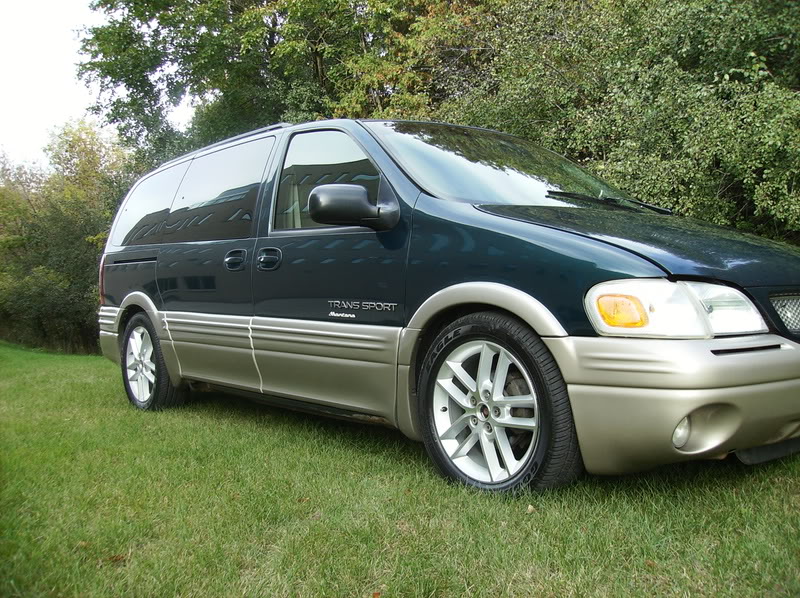

Just remembered this lowered Montana. You might want to contact him and figure out what spring/struts he used.
http://www.gtan.ca/showthread.php?t=5647
Fixed the image for you :(
