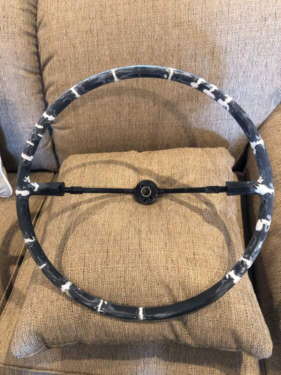

Well, this is not fun!!  However, the cracks are filled and most of the sanding done.  I ended up using JB Weld plastic weld.  It filled the cracks good, but harder than heck to sand.  Used the dremel with sanding drum to get the bulk of it off.  Gotta have a light touch using the dremel because it will gouge where you don't want it to in a heartbeat (wonder how I know that)!!!!  Trying to determine the next step:  primer, filler primer, or?  I'm going to go to a body shop in town and ask them.  Also, thinking of painting it semi-gloss.
I tried to add a pic of the wheel at this stage, but for some reason it's not transferring from my phone to the Mac.  Pic of the JB Plastic Weld is attached.

Jerry once your happy with the repairs go primer/ filler. i did 3 layers of primer and wet sanded between each coat, before i was happy with the surface. i used grits all the way down to 1500
top coat i used, hammerite gloss ..... it took nearly a week to dry hard !!
one tip.... i used a round piece of wooden dowel and wrapped my sand paper around it when doing all the finger bumps.... all 49 thousand of them !!! hahahaha:rofl:

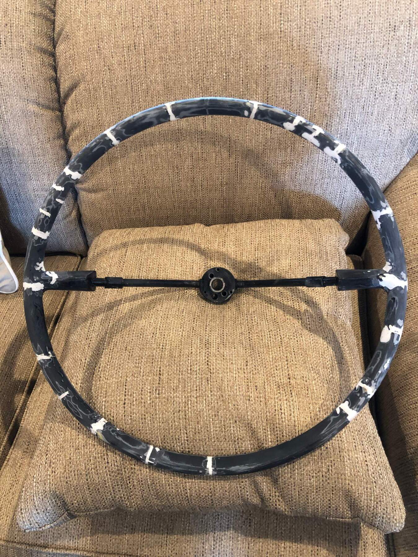

Thanks Kiwi for the info.  Not sure what hammerite gloss is??  Here is my progress so far.
here ya go Jerry

Well, I thought I had done a good job of sanding until I put the primer/filler on!  Whoa; I may not have any wheel left when I finish sanding.
Frosty, it was straight gloss black.  Will probably do a spray epoxy if I ever get to that point!
Have a great weekend.
yip !!! that is exactly what happened when i put the first coat of primer on!!!..... more sanding mate :rofl:lots more sanding!!!!
 then lots more again!!:stars:

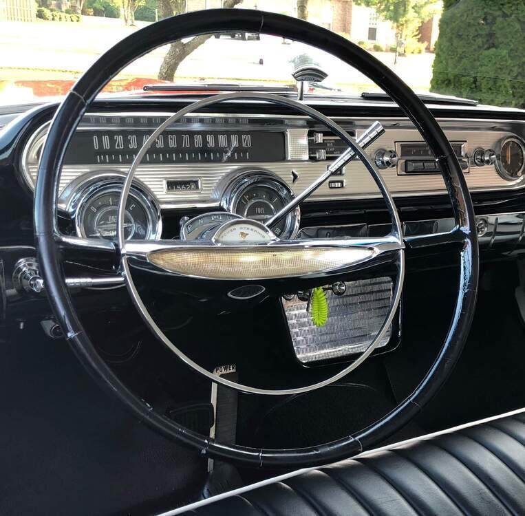

Well, here it is!  Perfect no, much better, yes.  Finally said I was never going to get it perfect, so I quit!  I used VHT epoxy paint.  Four coats and will do a couple more after 48 hours.  Nice shine and went on evenly.
So what have I learned?  1.  Don't do this again!  2.  Pay someone to do it!  3.  Use a more sandable epoxy- that crap is HARD.  4.  Be more careful with the dremel sanding drum.  5.  Buy more Crown Royal and Coke!
Appreciate all the input from you guys.

Beautiful job.  Well worth the effort!  Can't tell me your not proud of that.
Jerry !!!!well done mate 🍻🍻🍻🍻
welcome to the “been there done that “steering wheel restorers  sub club of forever Pontiac !!! :rofl:
