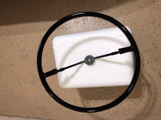

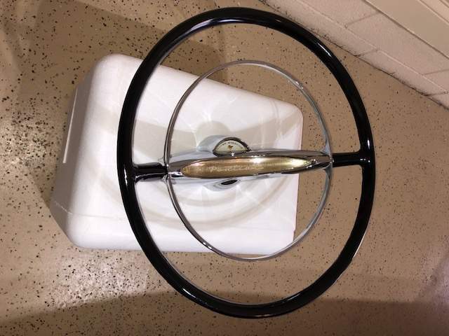

  • Well, here it is!  Perfect no, much better, yes.  Finally said I was never going to get it perfect, so I quit!  I used VHT epoxy paint.  Four coats and will do a couple more after 48 hours.  Nice shin
  • Wheel is back on!  Pics of before and after.

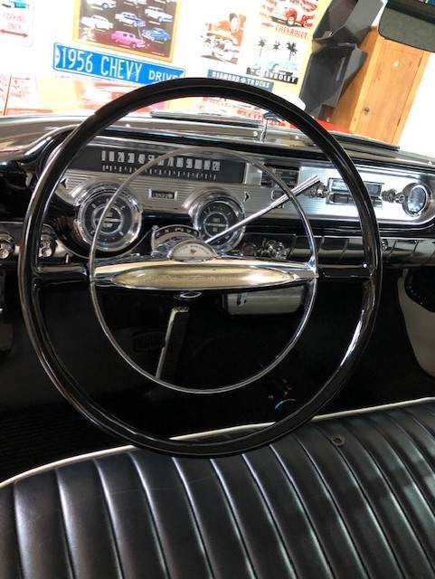

    Jerry, from what I have seen '57 Star Chief wheels are like Unicorn's teeth. When I replaced the awful wheel on my one, I fitted one of the 15" '57 Bel Air ones from a reputable seller on eBay (if the
Care to give us a picture of what you are looking for?
Jerry, from what I have seen '57 Star Chief wheels are like Unicorn's teeth. When I replaced the awful wheel on my one, I fitted one of the 15" '57 Bel Air ones from a reputable seller on eBay (if there is such a thing) as the stock one was simply too big for me. There are some Chinese ones around that don't have the steel ring in the circular plastic rim, but thankfully mine did.
I then sourced a centre cap with the Pontiac name and Chief Pontiac logo from a member of Canadianponcho.com, as the 1957 Canadian Pontiacs were basically Chevys with a Pontiac front and rear end.

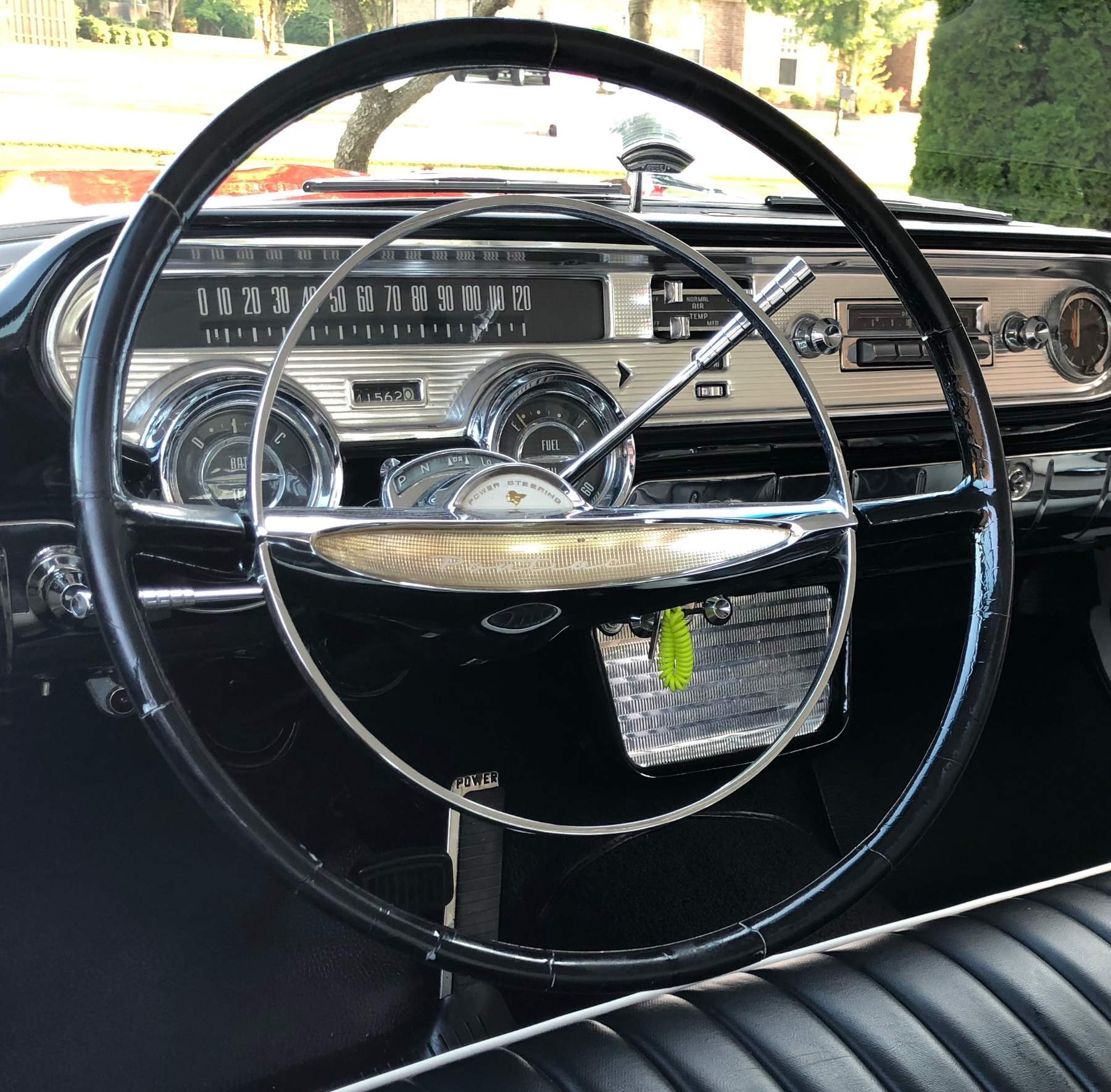

This is my wheel now.IMG_1161.thumb.jpeg.e4ca3c165344a998192c4d71d202e1d0.jpeg

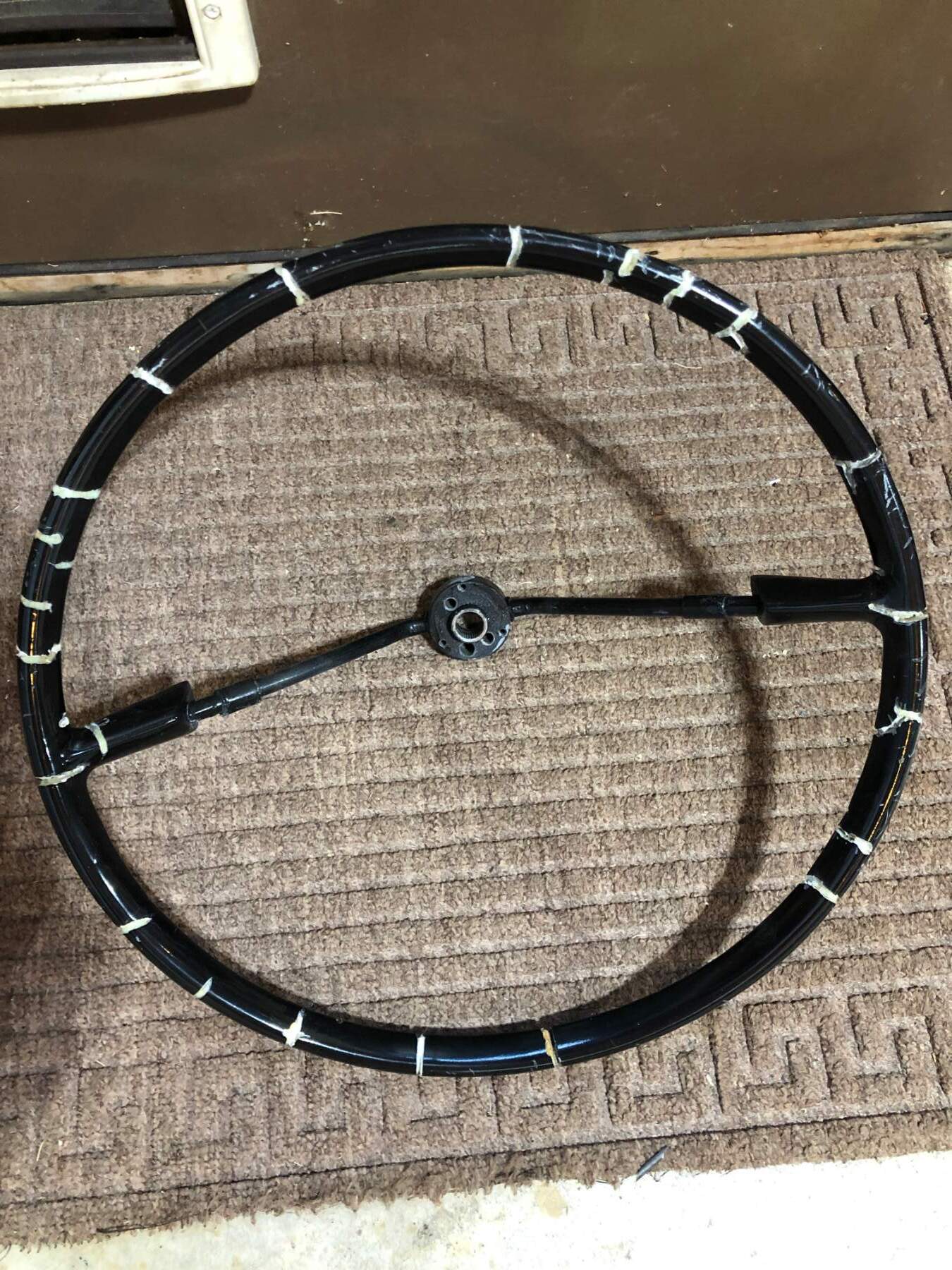

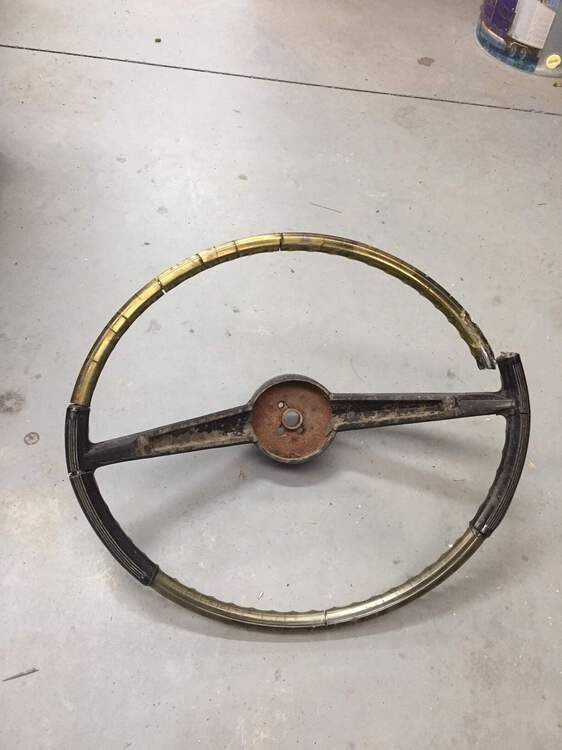

wow! what's wrong with that Jerry? if your concerned about the cracks...i have been there done that ! and fully refurbished my frontal impacted car's wheel...and it was a complete mess!! not only was it cracked, it had had the jaws of life cut it clean through!
i can copy and paste the part of my rebuilding 64  thread if your keen to fix it your self?
the one thing i am going to do is get my upholstery guy to make me a nice leather lace up rim cover... i kinda like cow hide steering wheels...it justA has a nice feel. as opposed to manufactured plastic steering wheels :cheers:
I'm with Kiwi on this one. That is a very repairable wheel. It just takes some time and patience.
Kiwi Boni, I would like to see the procedure you used to repair your wheel.  I have watched a couple videos on it, but thought if I could find another wheel, I wouldn't bother with it.

this was what my wheel looked like.... if you go to page 4 of my thread you will see what i had to do to do too it
the one key ingredient to the whole restore is patience lots and lots of patience!!!!

Thanks.  You did good!  I'm going to attempt mine next week.  Not sure what to use as a filler but I think I'll do Marine Tex.  Lots of good reviews.  Or maybe just try JB Weld.  Any advice on epoxies?
I think any good 2 pot sandable resin would work
Call your local body and paint supply shop. See what they have as far as sandable epoxy resins. They may have a recommendation based on the age or type of material you are bonding it to. Acrylic vs normal plastic will probably make a difference in what they recommend. I'm guessing the steering wheel is acrylic.

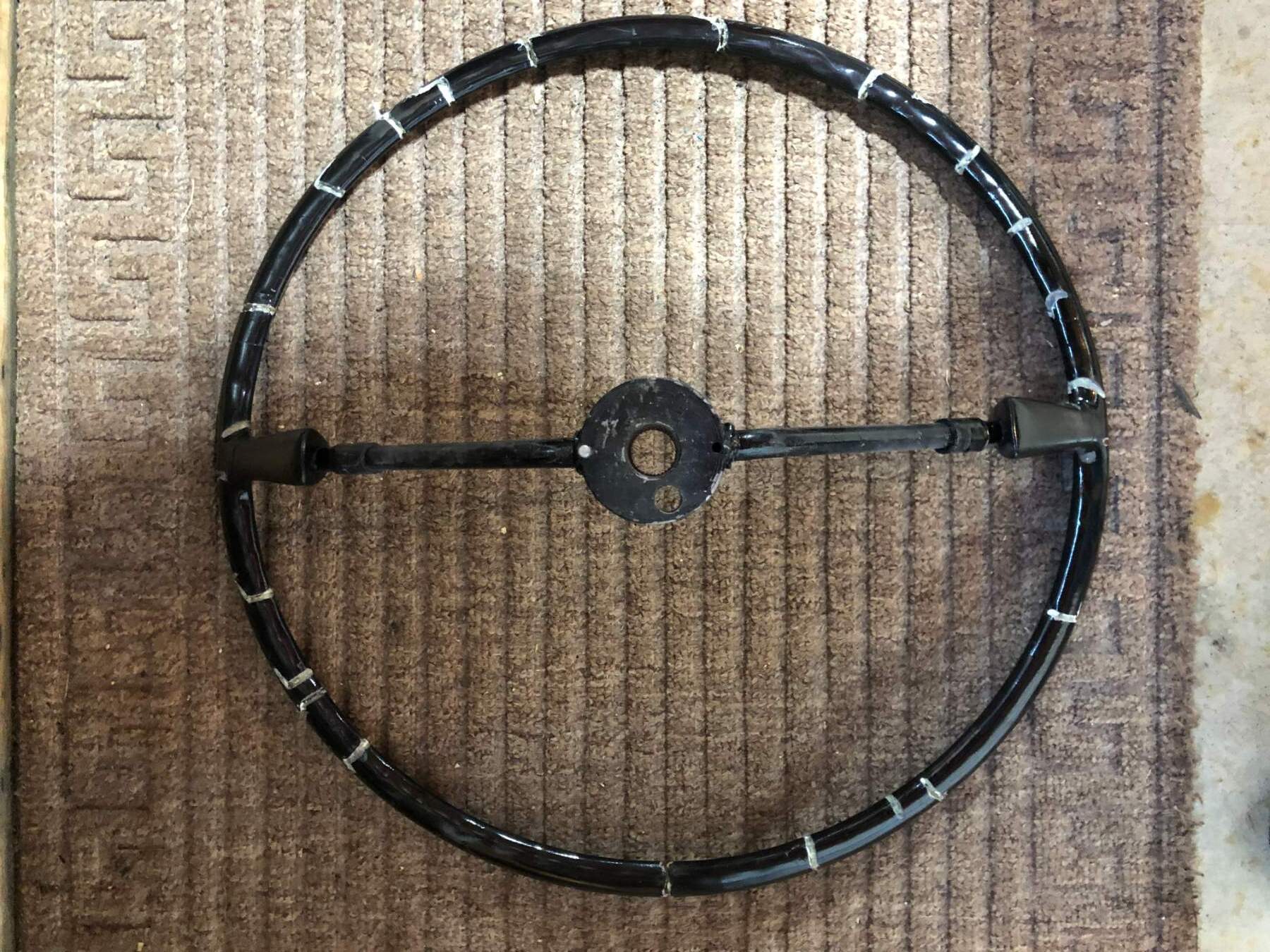

Well, the fun has begun!  I feel I should have my dentist license after the grinding LOL.  Monday will clean it up some more and then try JB Weld on a couple of the cracks.  If that doesn't go so well, will try something else.  Someone has worked on this wheel before.  The "bumps" on the back side are quite smooth.

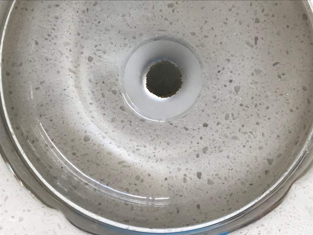

I used JB Weld to fill in the hole in the middle of my wife's mixing bowl, which used to have a blender through the bottom, as she liked the glass bowl to use. After filling the hole in (about ½" diameter) over several times, I then ground it smooth with some grinding stones in my cordless drill until they were super smooth to touch. This was five years ago and it's still going strong.

Very good test for jb weld Russel 👍👍😀
First of all...Washtubman??? There's got to be a story behind THAT moniker. I also endured what Kiwi went through and brought my terribly battle scarred steering wheel back to life with epoxy putty, sandpaper and lots of patience. Once set, that stuff will last forever. I also fitted a quality leather cover over it to make it a bit thicker. Believe me, your original wheel was in fine condition compared to our mutual shared horror stories. Good to see you gave it a crack and stepped up to fix it yourself. Kiwi is the master here and it's always fun to see what new drama he's immersed himself into.
FIRST UPDATE:  I'm not proceeding with the JB Weld.  It's too runny to build up above the cracks, and I don't want to apply multiple layers.   So am going to try something else, not sure yet what!

I also used fibreglass resin to go over the entire rim (after the epoxy putty) to build up the rim thickness and to make everything nice & glossy smooth. Epoxy putty shouldn't be 'runny.' You form a paste using your fingers and when it starts to get physically warm (epoxy chemical reaction) push it into the cracks. It will work a treat.
