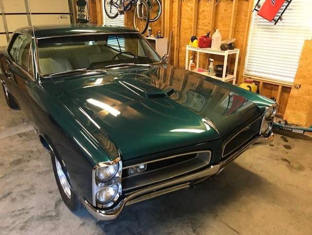

Thaks guys.  Here is a pic of my 66thumbnail_IMG_7055.jpg.e5817adab301912171004530b12370a4.jpg
Beautiful ride!   I would look into a carb style fuel injection.

Oh Tallmike!!! what a great green that is!!👍 it looks fantastic mate:cheers:
