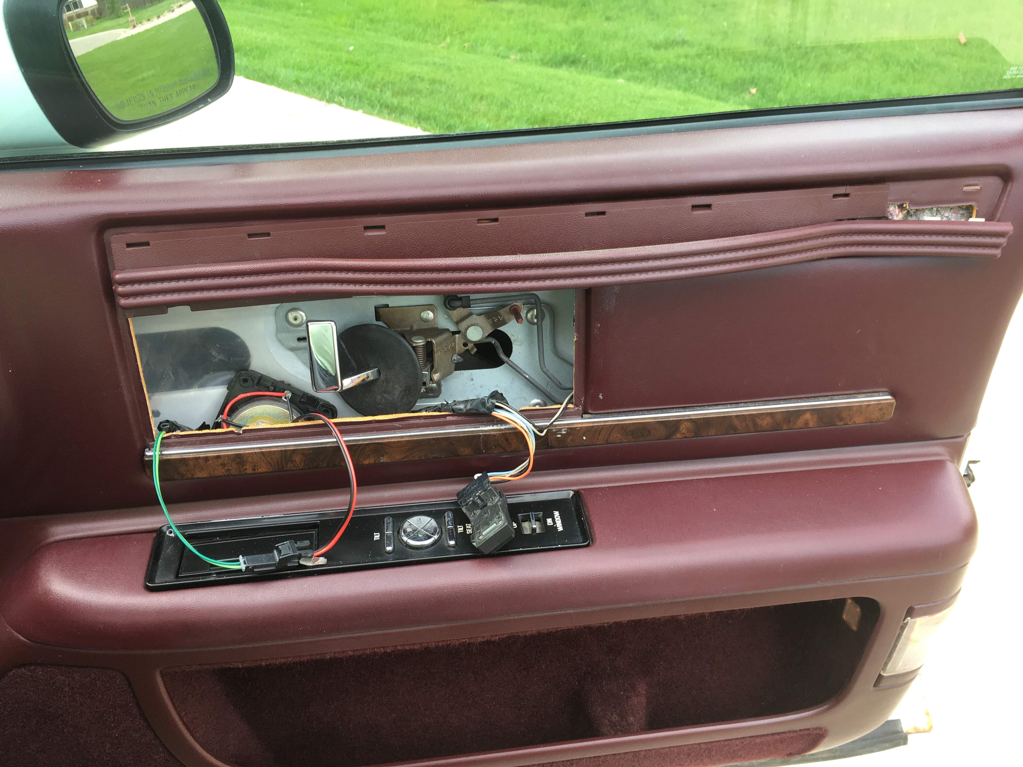

Here is what I started with. The plastic panel was busted and I spent a year searching eBay and Craigslist for one. Finally had to purchase the whole door panel to get the part I needed.

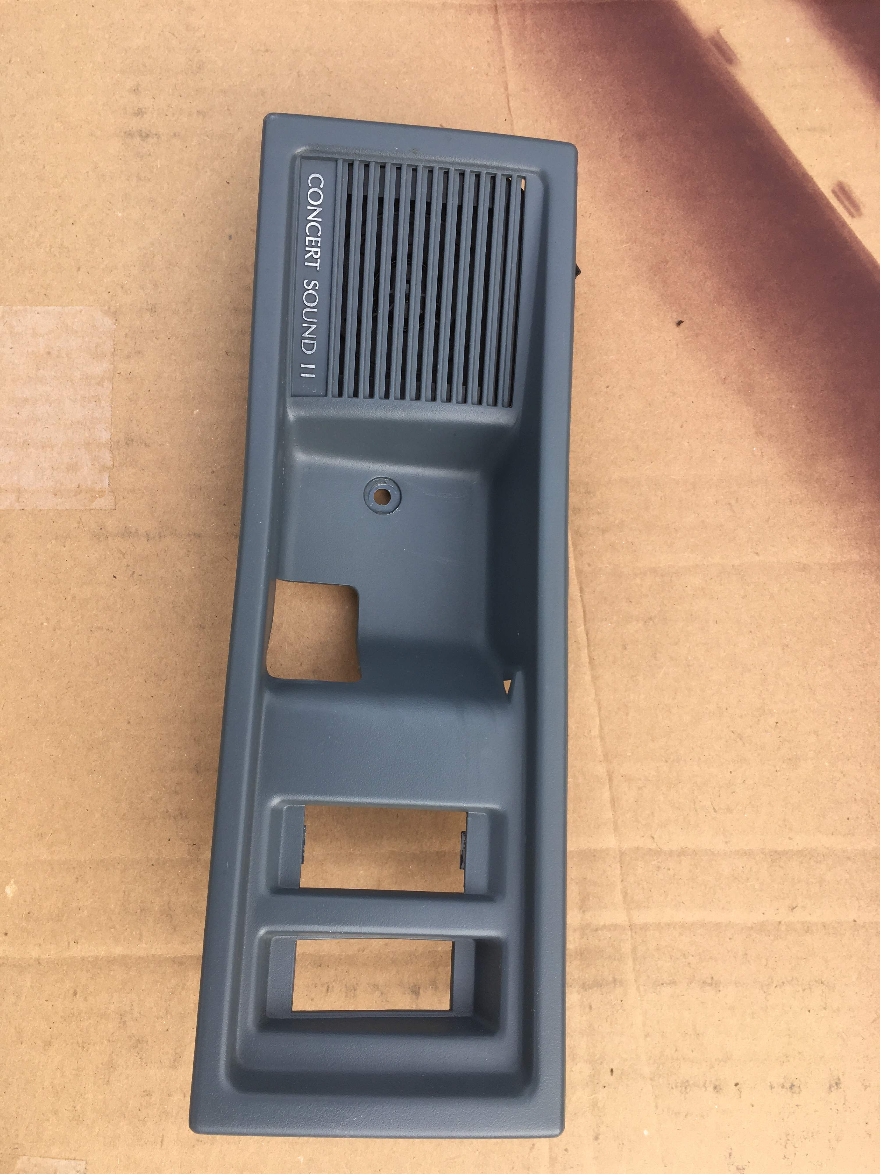

Here is the major piece I needed - plus I used the simulated wood grain trim that's about the pull strap.

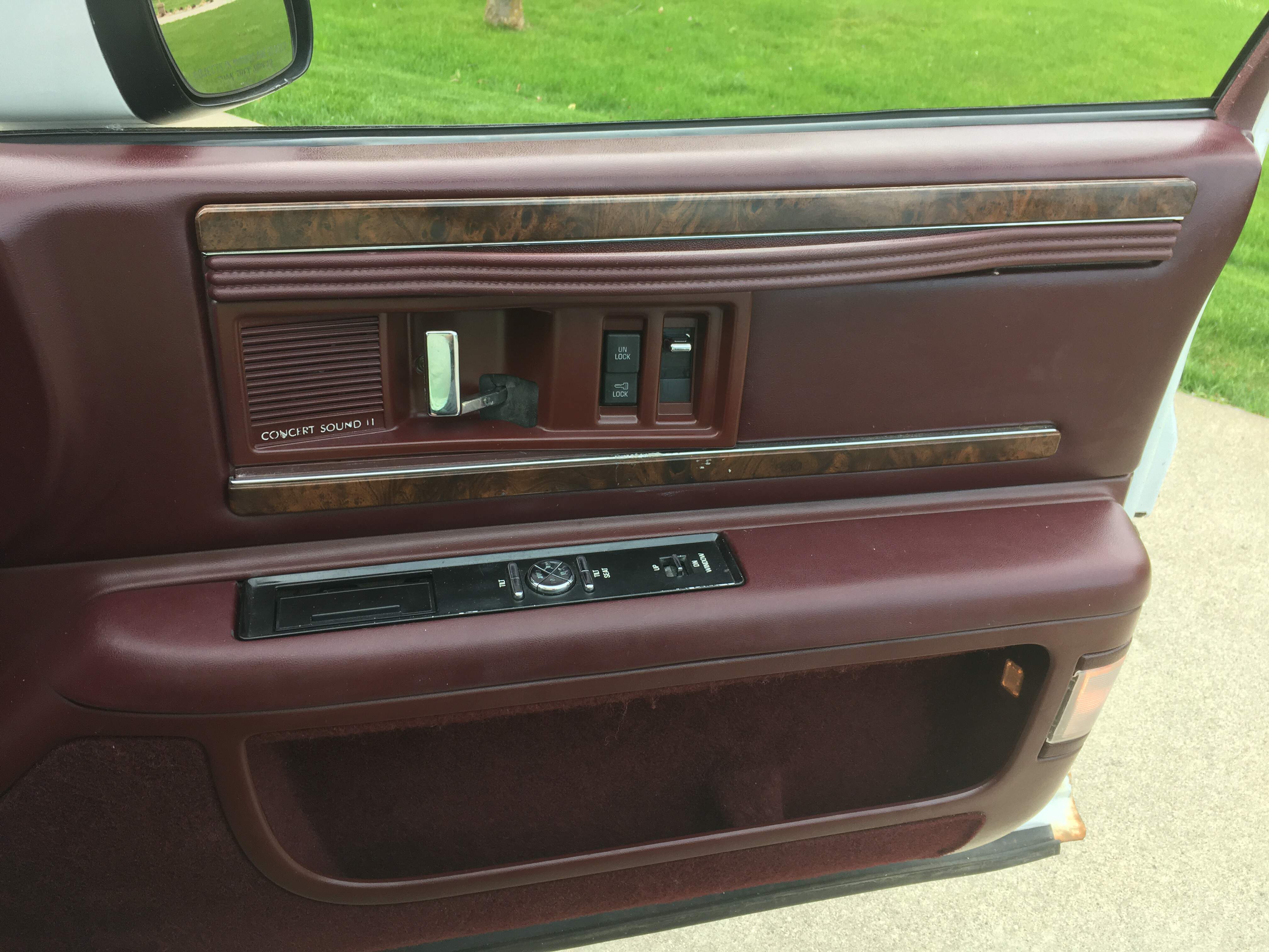

Here is the finished product.
The challenge for me on the Roadmaster was this car is a Roadmaster Limited, so the door panels are not the same as a base Roadmaster. The base Roadmaster is interchangeable with the Chevy Impala - but I couldn't use either. I had to find a Buick Limited or an Estate Wagon for these parts. It was tough. So I appreciate what you are going through with the Bonneville.
