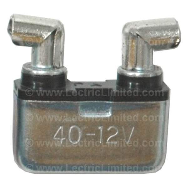

Hey Frosty doing good I hope.Still waiting to get my fuel pump and playing with top.I  put in the 40amp and it seems to work when I push the up button but when I push the down botten noting I can hear it click like it wants but nothing .And notice on the dia you sent it said a shorting bar but can't find one anywhere so ordered a curcit breaker which will come monday hope that will do the trick.Here is a pic of it.
Terry - I have exactly the same thing in Lucy.
As for not working in the down position, check under the dash and make sure all three leads are plugged in. Unlike most electrical connections, the power top has three separate leads going to the switch and not some form of electrical connector. So it is easy for one or more to come off.
