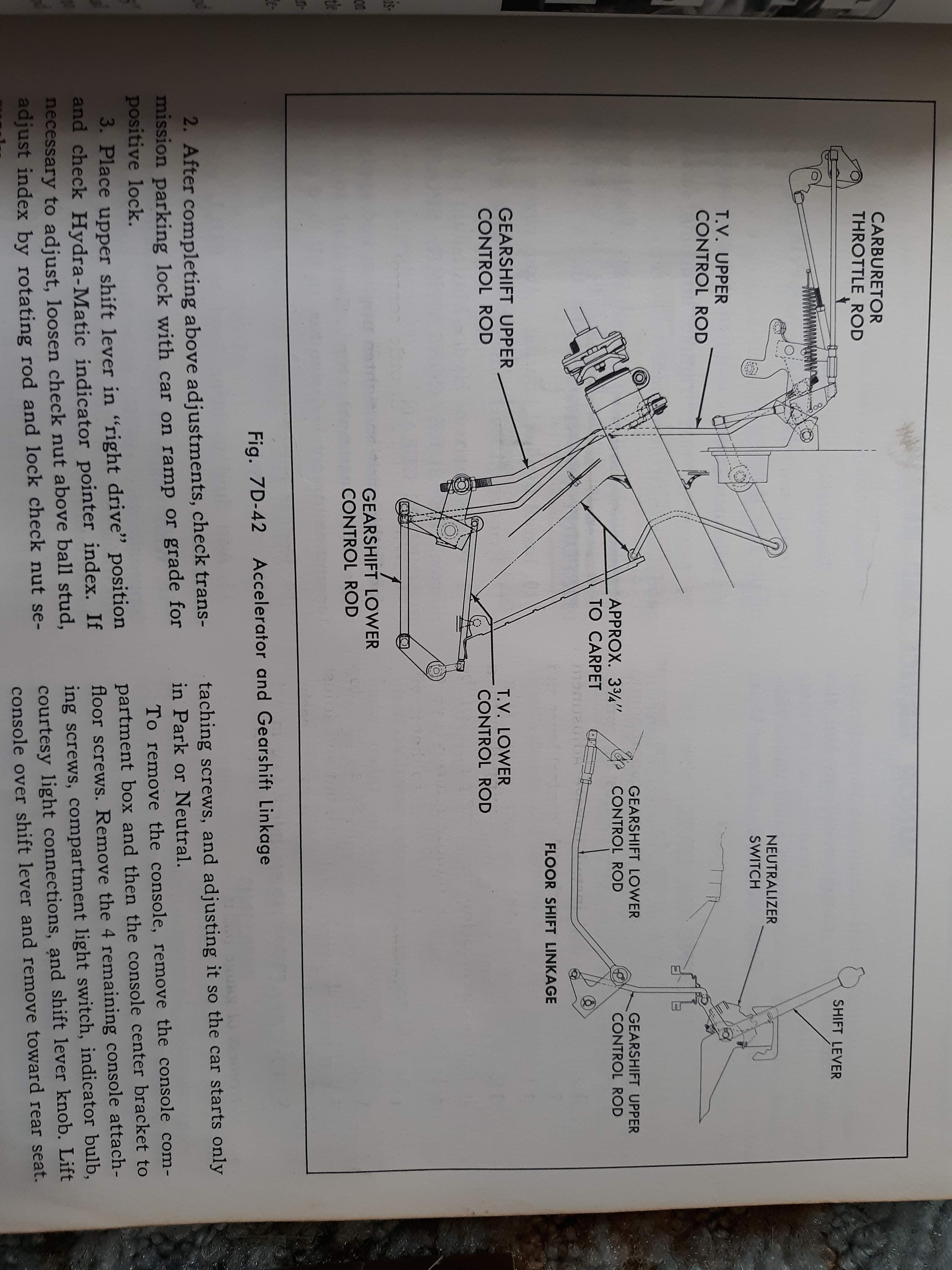

Now your reverse problem I think is something else. Is you car an automatic or manual? Since it is a 4-door Vista, I am going to assume for the moment is an automatic. I am wondering if your neutral safety switch has partially or completely failed thus cutting off the ignition when you go to shift. You can't restart the car because the engine is already too hot (problem #1).
I agree with Frosty and assume your speaking of the starter and not the alternator overheating.  Neutral safety switch.

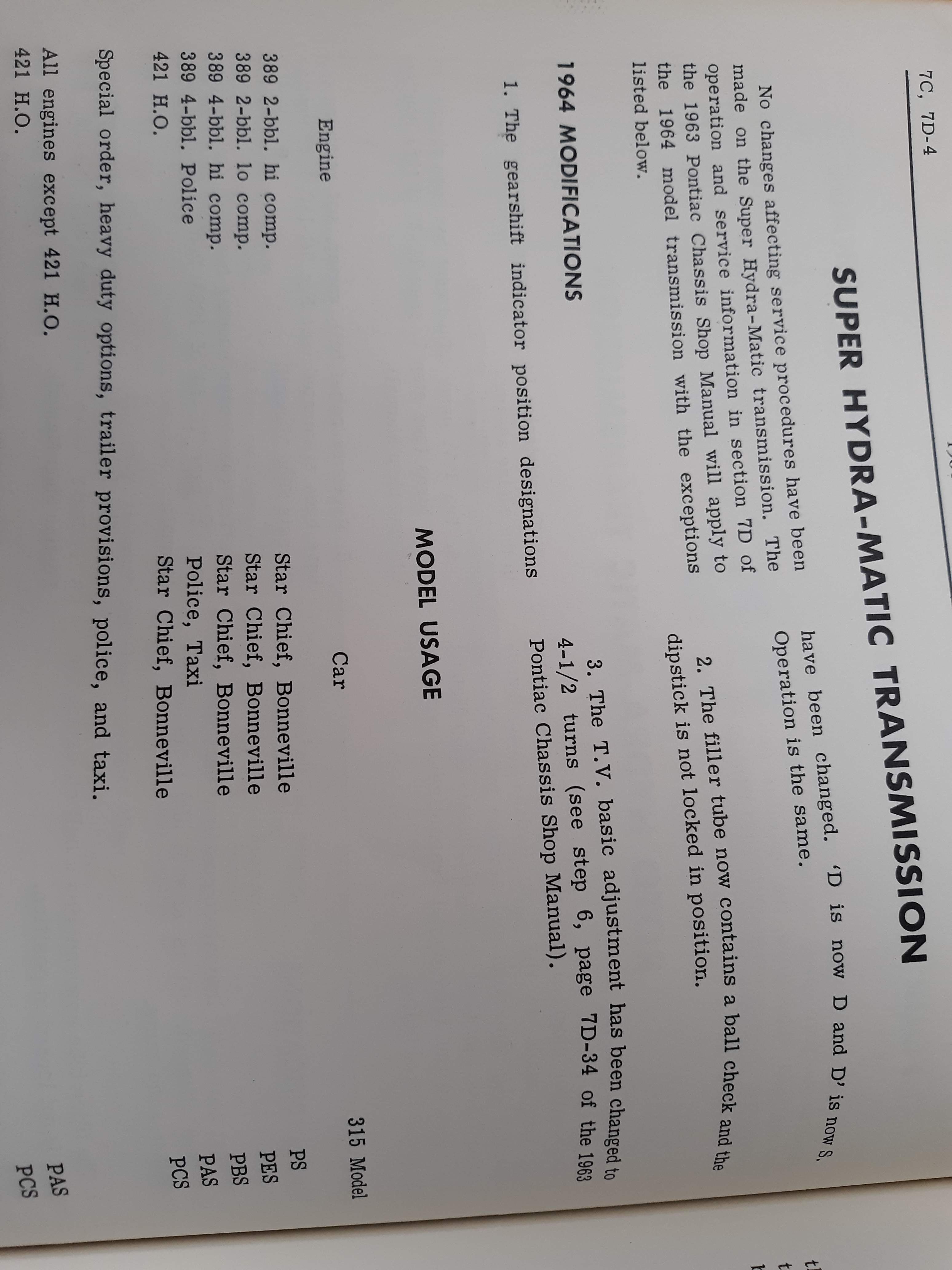

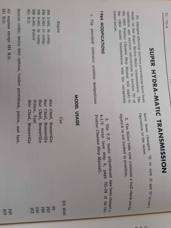

Am assuming the car is equipped with the Super Hydra-Matic transmission..?? Also is the car column shift or floor shift...?? On column shift cars the neutralizer switch is non adjustable.... But it is adjustable on floor shift cars..If has floor shift it's very possible that it has slipped out of ajustment...
If the car is equipped with the Roto Hydramatic (AKA Slim jim) the procedure is the same...

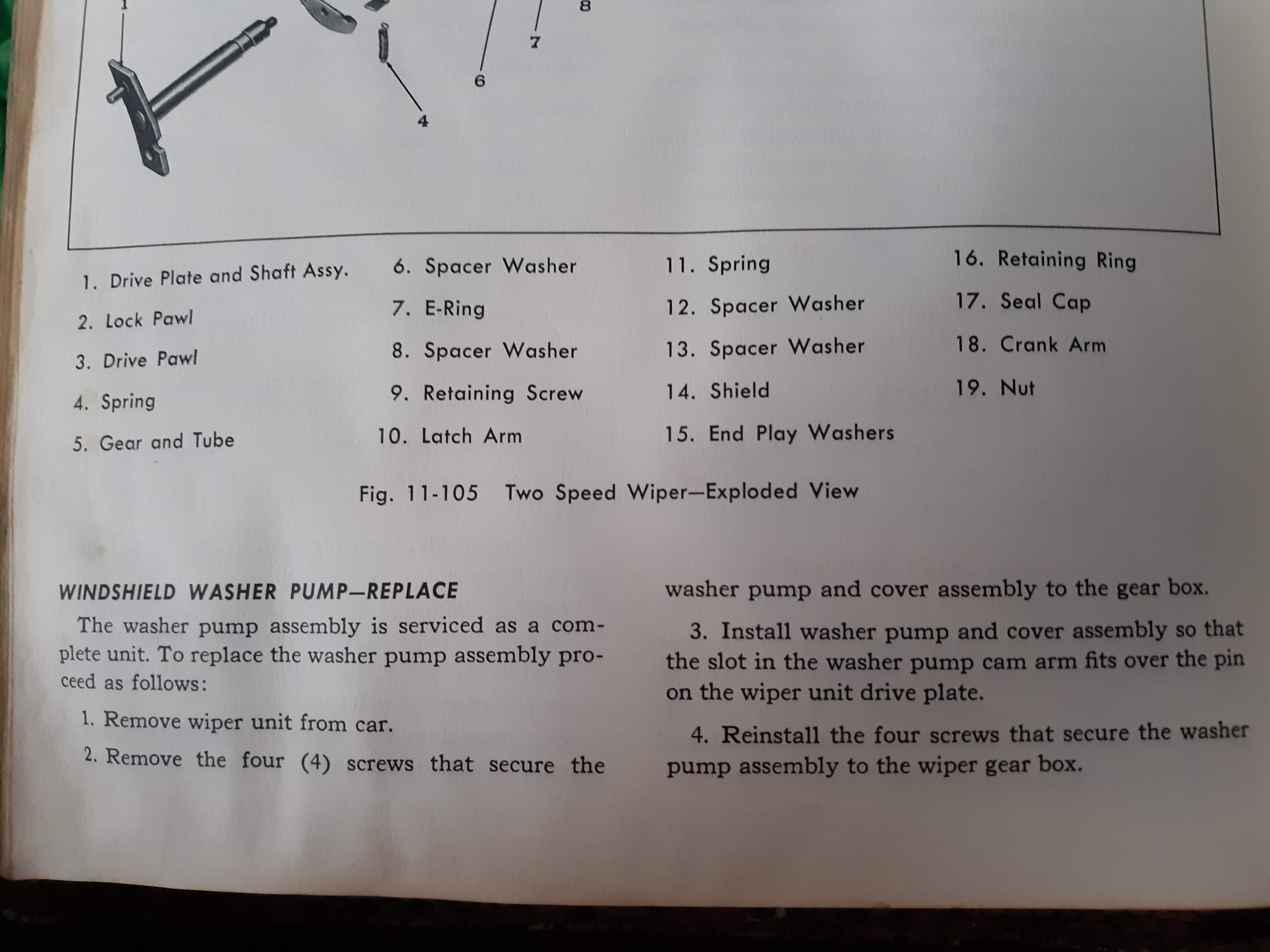

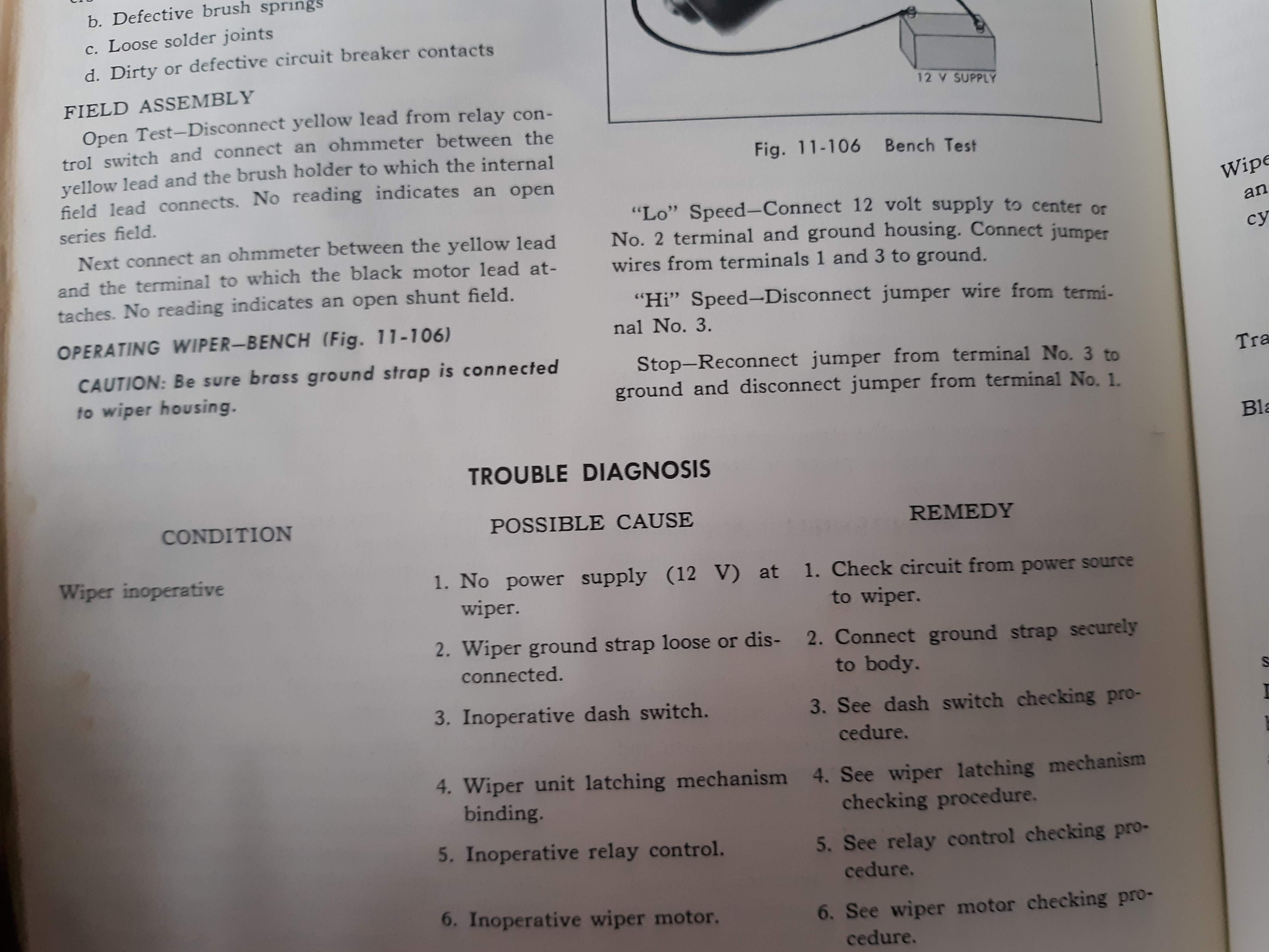

Thanks everybody. Not sure why I kept saying alternator. Yes, I meant the starter. The car is 100% stock and is a column shift automatic. Sounds like I was on the right track with the starter. Thanks for everyone’s input! I love driving my Bonny but it gets frustrating and embarrassing when I need to sit for an extended period of time for it to start again. One last question on the same vehicle. Wipers aren’t working. Fuse is good and switch has been replaced. Anybody know of a place to source a wiper motor? I have looked high and low and have only found one online through the auction site that starts with an E for big money. It’s a two speed motor with three connections.

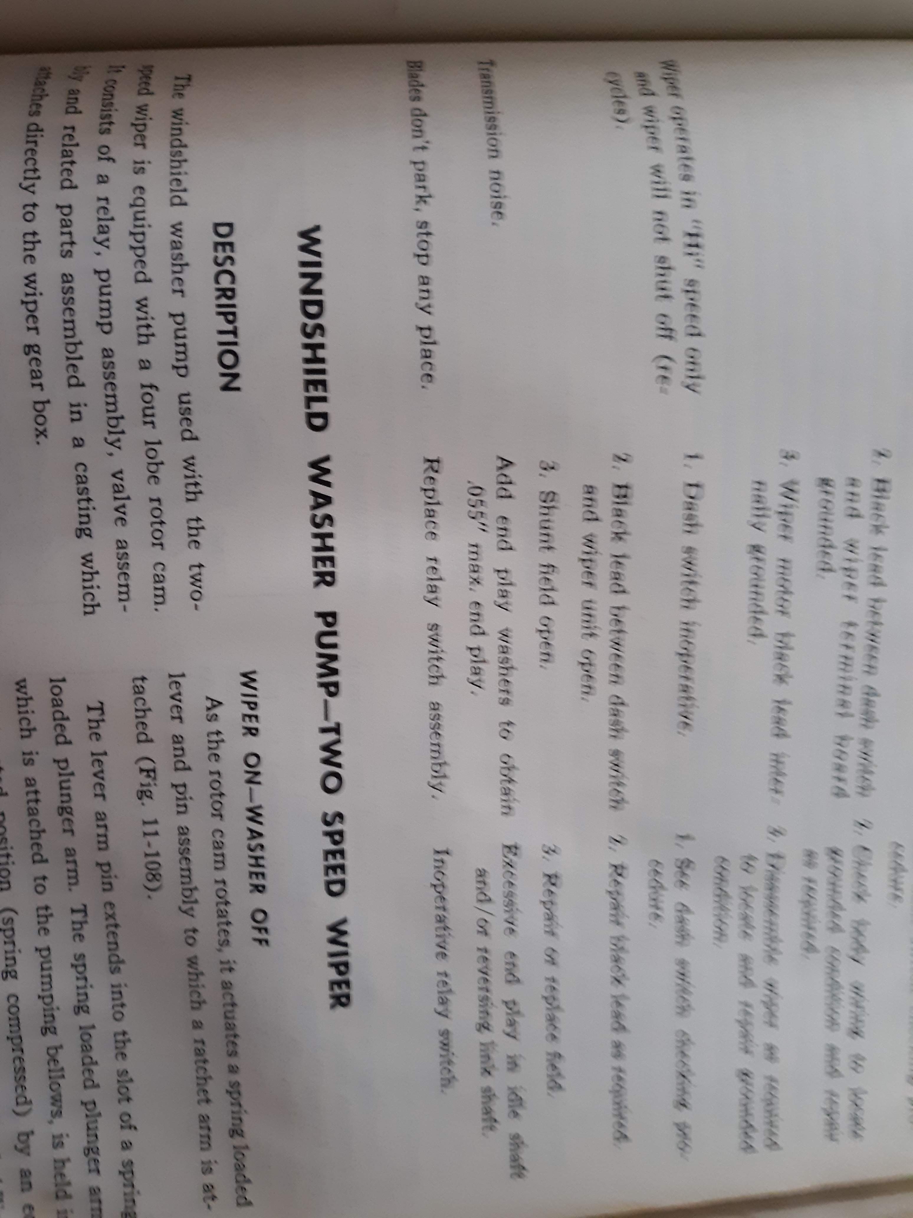

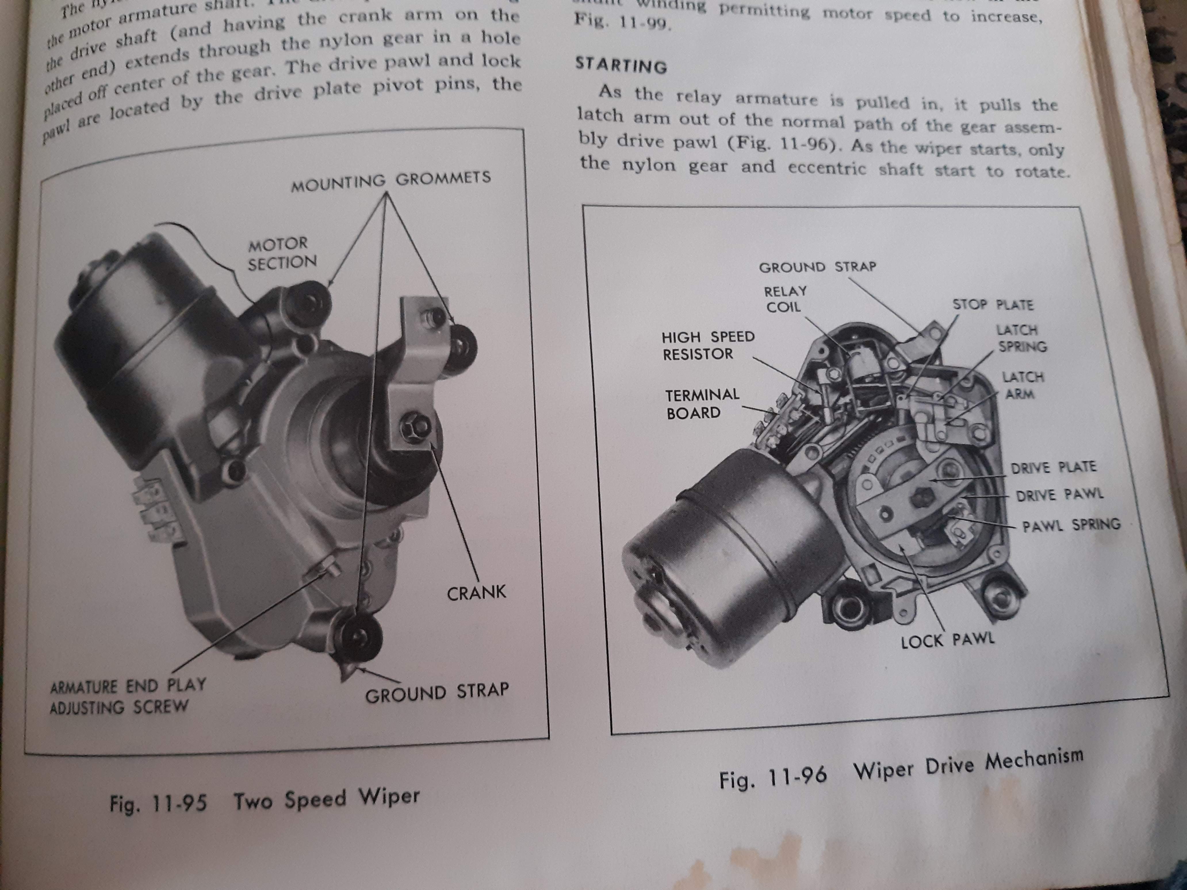

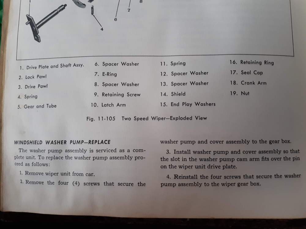

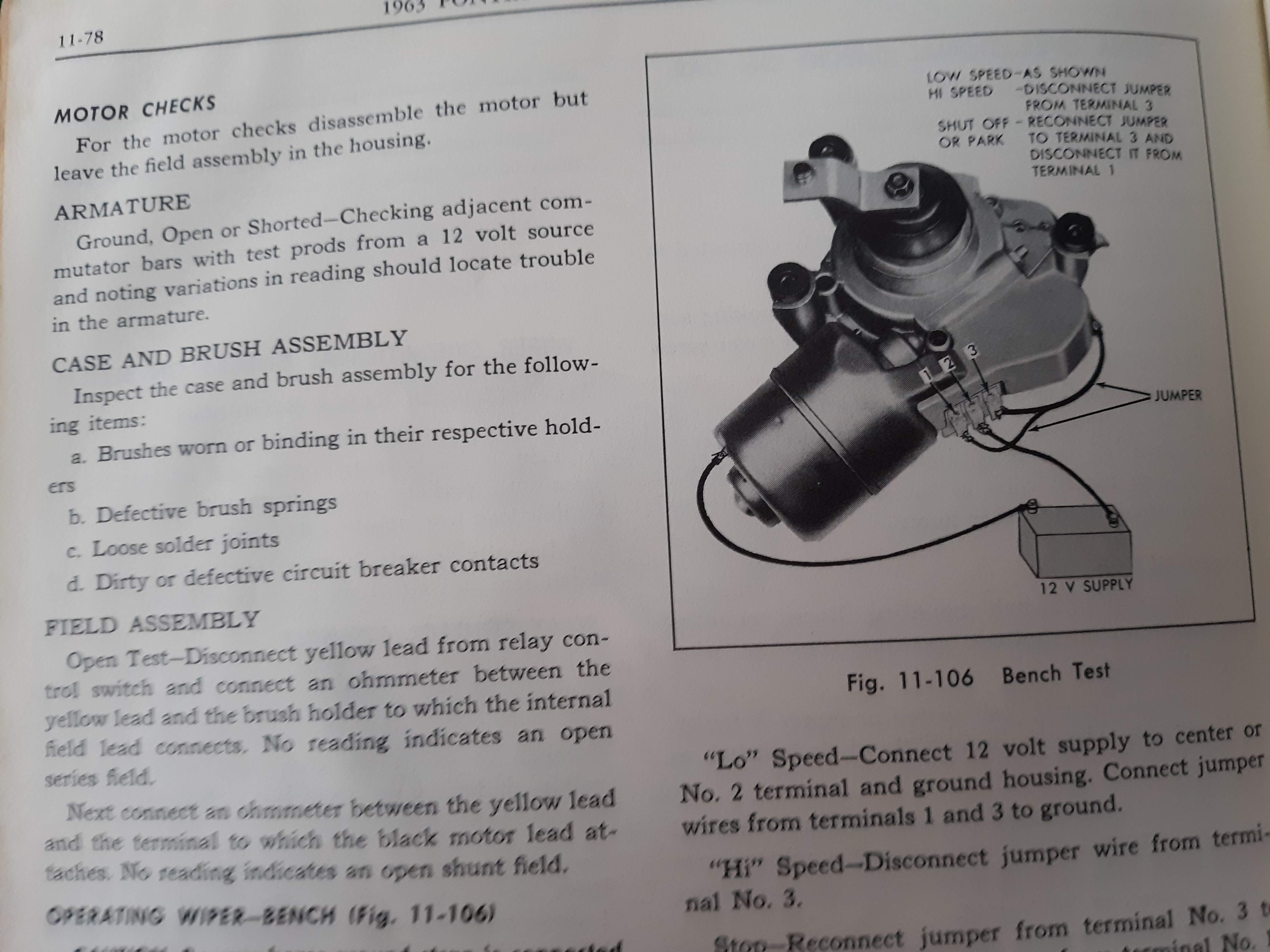

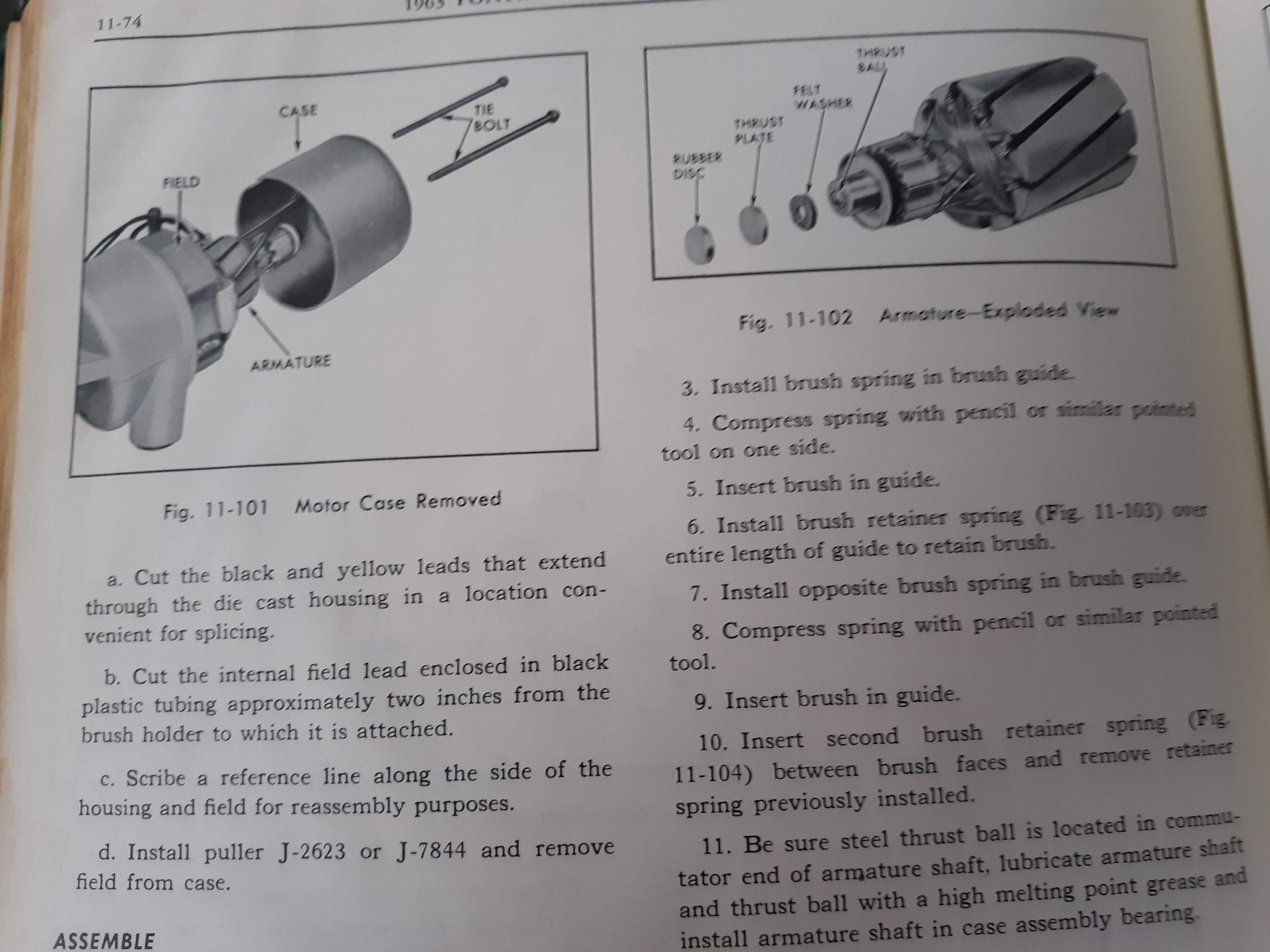

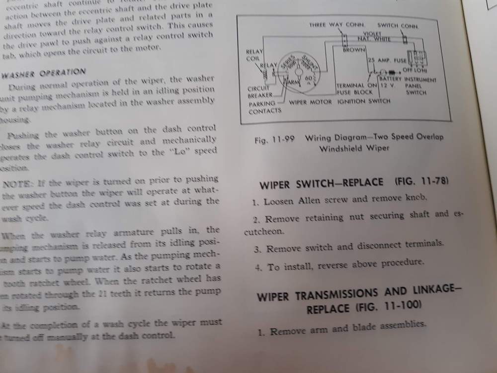

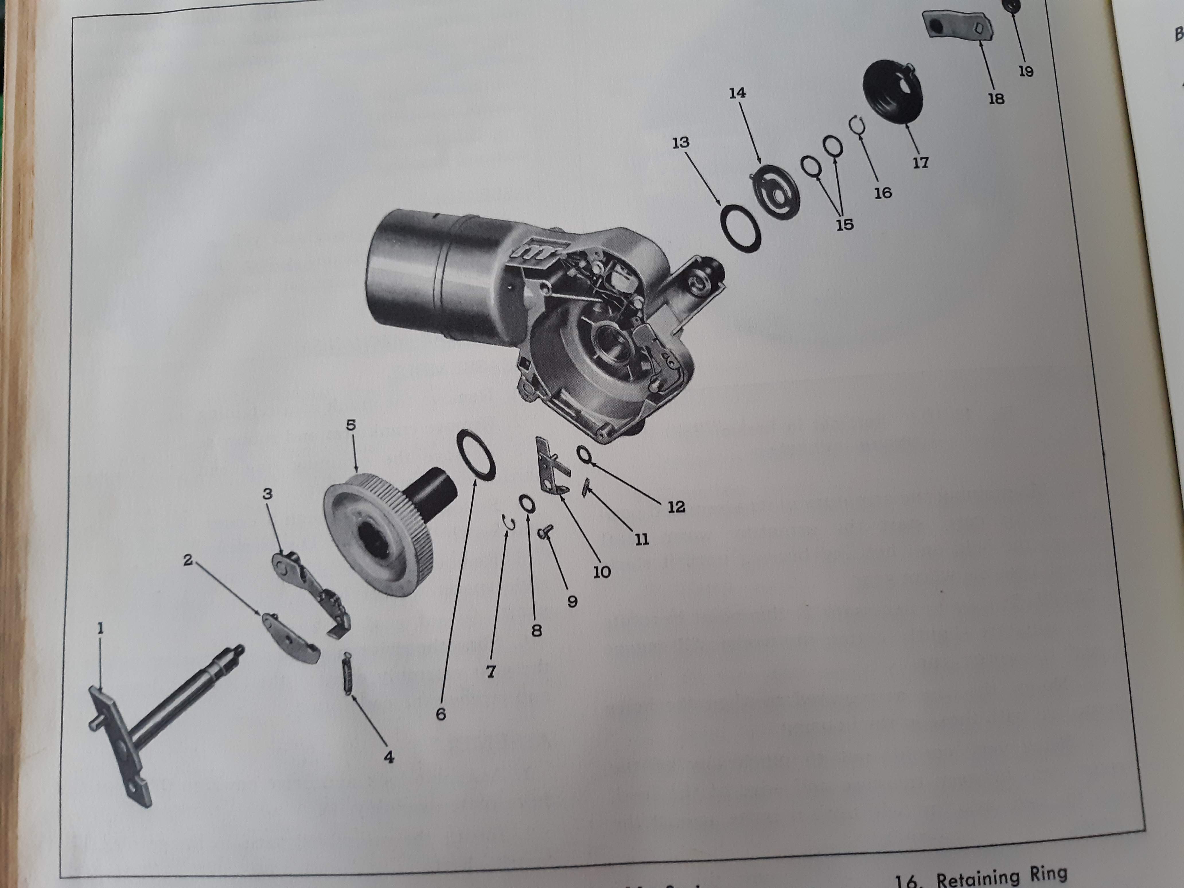

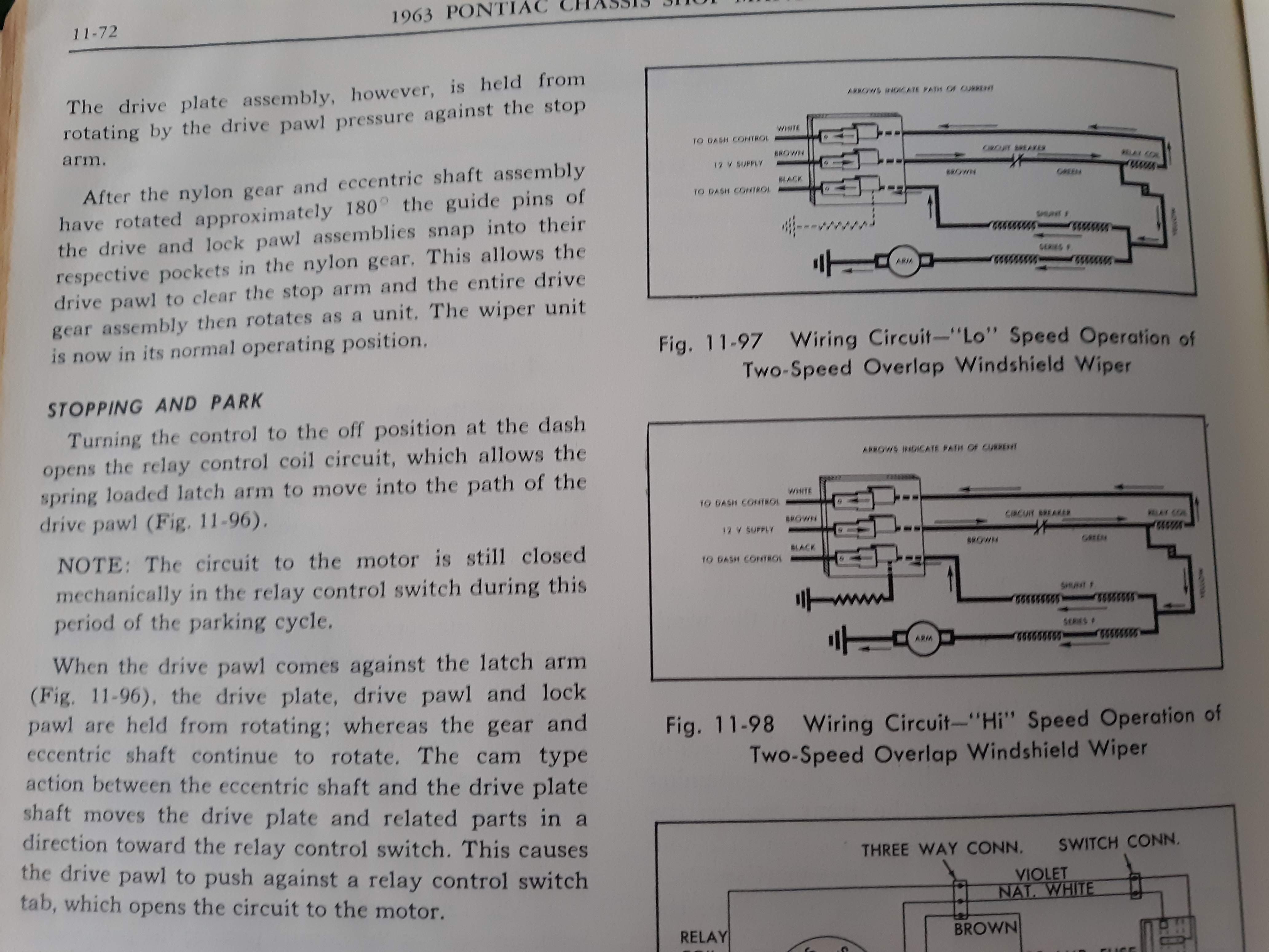

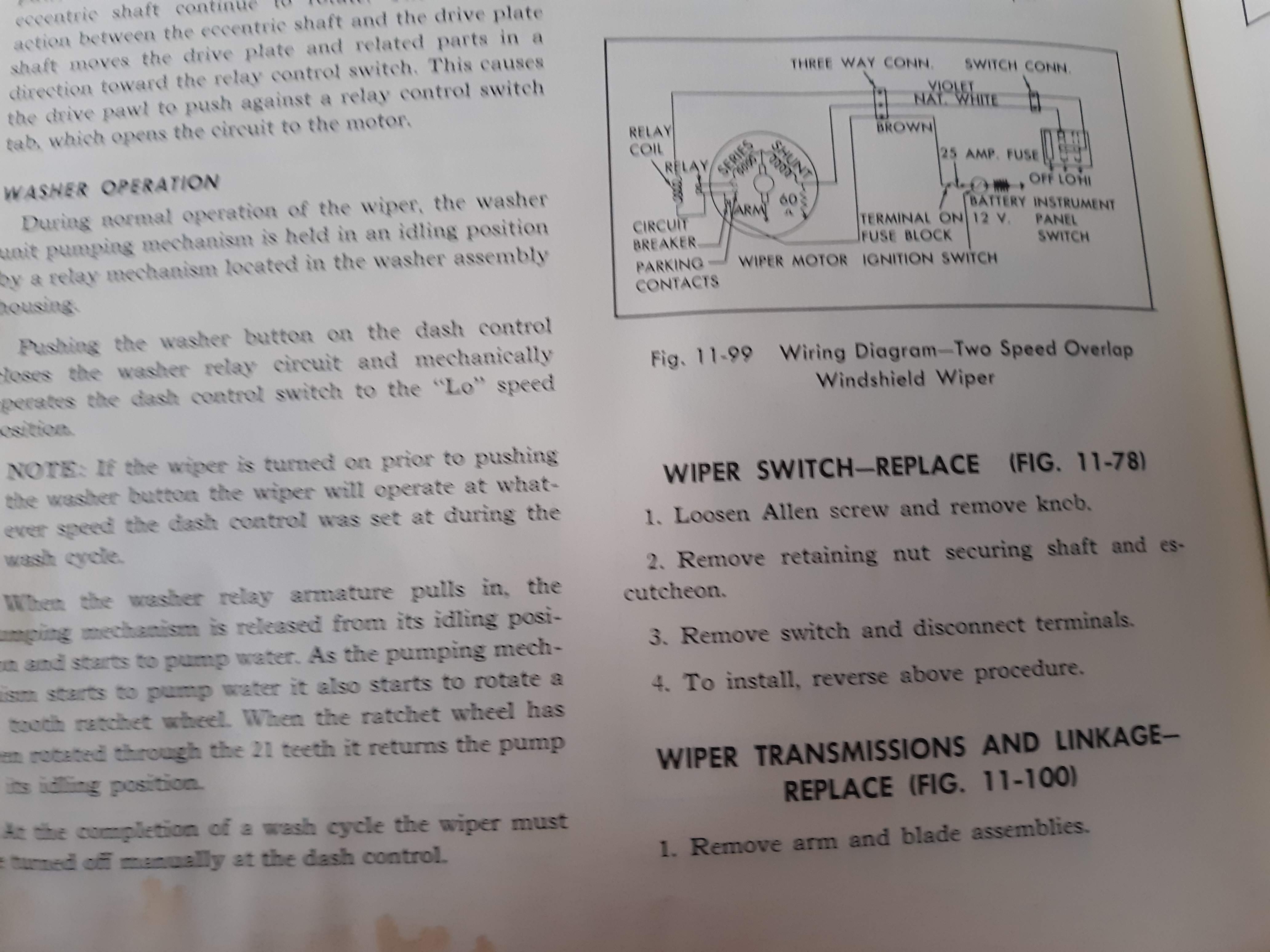

If you're having a hard time locating the wiper motor assembly....Or would like to keep the original...It is a serviceable unit and can be repaired...took photos with my phone hope you can see them OK...Hopefully this helps....
Very cool. Thanks for all of the help!
